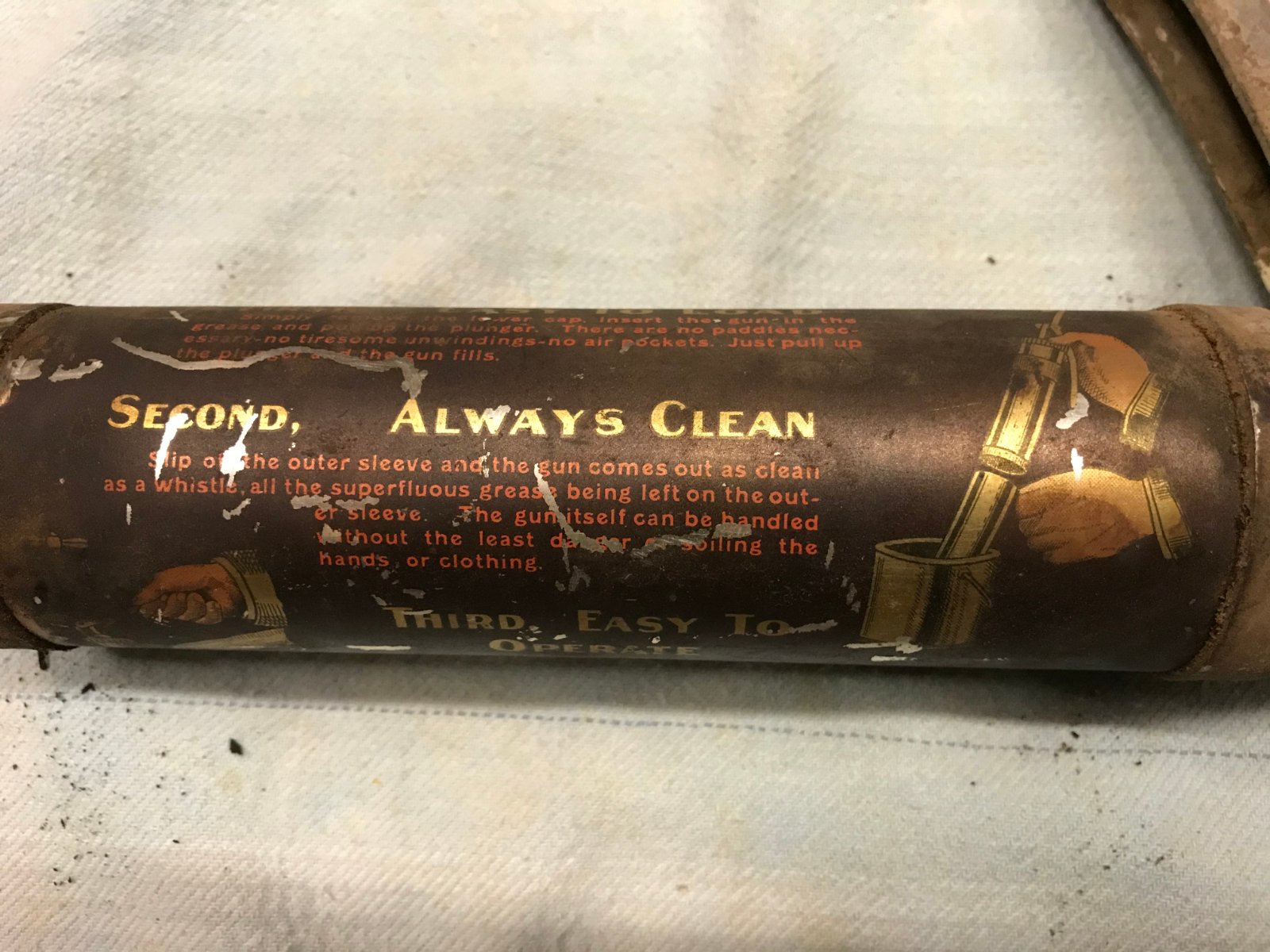

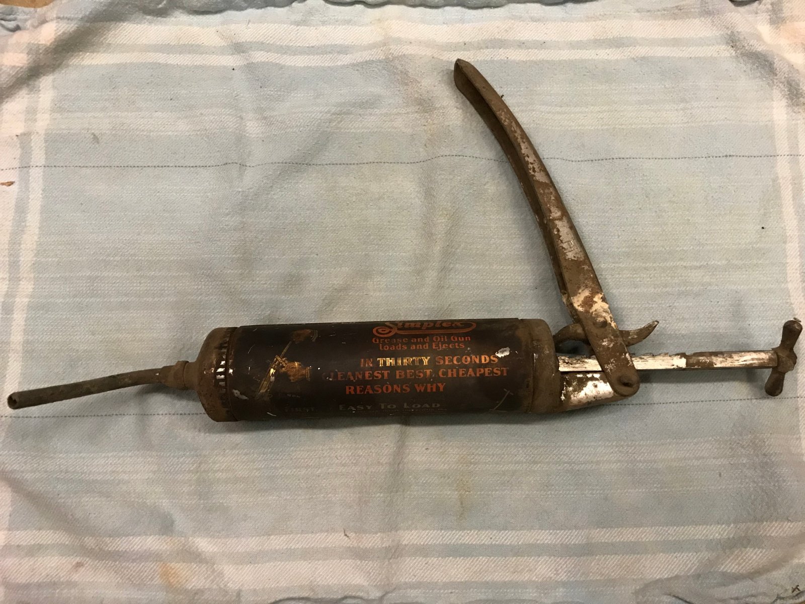

Post by Rich Eagle » Tue Mar 17, 2020 2:05 pm
I have seen the Alemite pin fittings installed on old Model T rear axles and other places many times. My 1923 White had them originally. I was pleased to find this gun with a scoop for filling it with grease. Also the data sheet it came with. The sheet is for 1/4 turn fittings rather that the pin type.
This is from a search on the web:
The Carr Fastener Company introduced a grease gun for automobiles and heavy equipment that featured an acme thread with a 1/4 turn engagement. The company was primarily known for its fasteners for such things as tops and side curtains.
These grease fittings were used on late model Stanley Steam Cars, including the Model 740, Model 750, and the 1925 and 1926 SV or Steam Vehicle Corporation cars.
As for Alemite, this implies they were introduced when the company started in 1918:
https://www.skf.com/alemite/about/alemi ... index.html

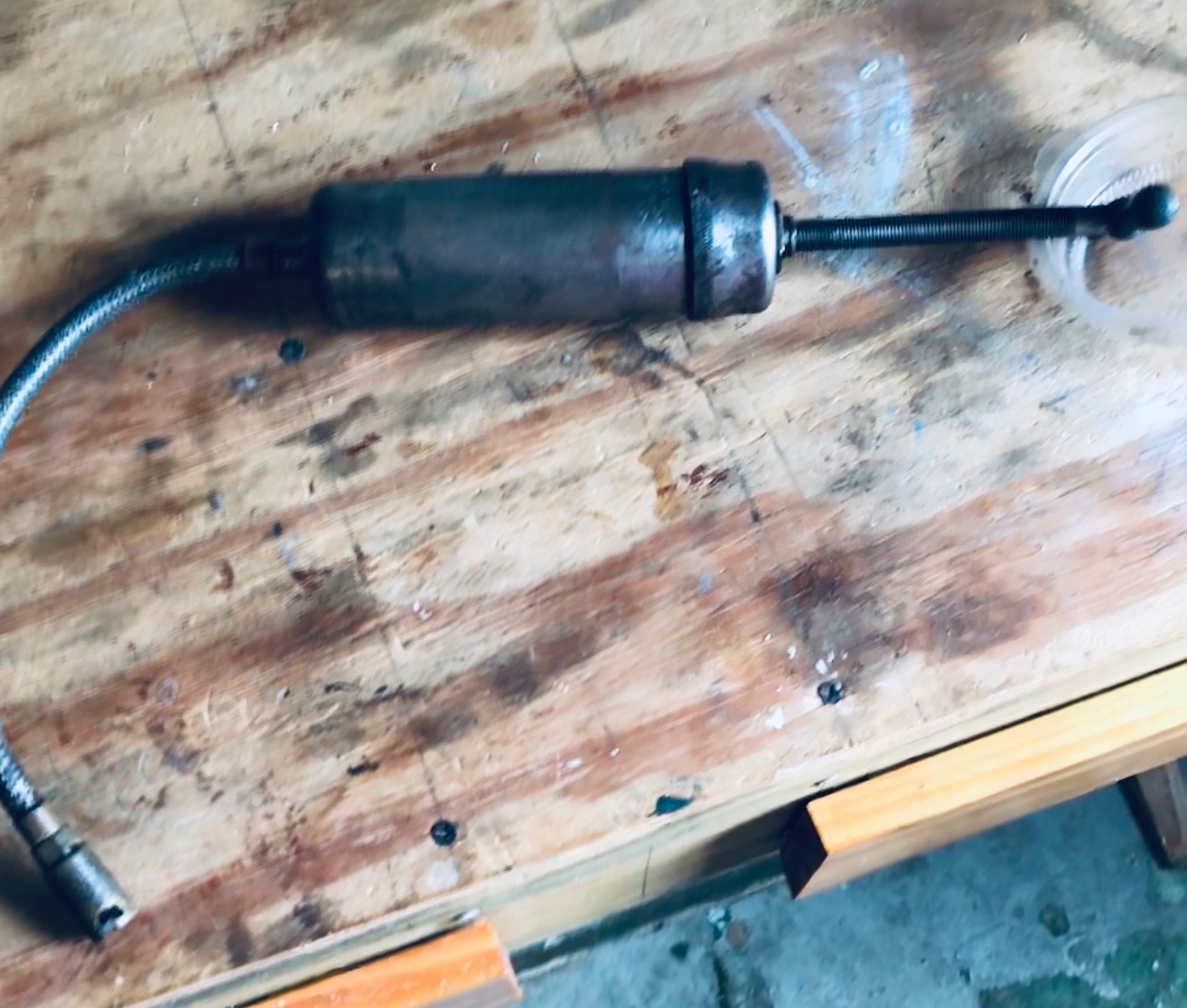

I commonly see something that I think is a mistake with grease guns. A type of grease gun that must be pumped with both hands should never be fitted with a flexible hose. A flexible hose is fine on a grease gun that can be operated (pumped) by merely squeezing a short lever with your fingers like you do when you release a Model T emergency brake lever. But when you have to hold the "fat part" of the grease gun with one hand, and pull a lever back with the other hand to operate the grease gun, you don't have a third hand to hold the metal fitting at the end of the hose tightly against the grease fitting. I guess there are some grease fittings whereby the business end of the hose locks onto the grease fitting, but I don't think this is always quite possible 100% of the time either! FWIW,.....harold
