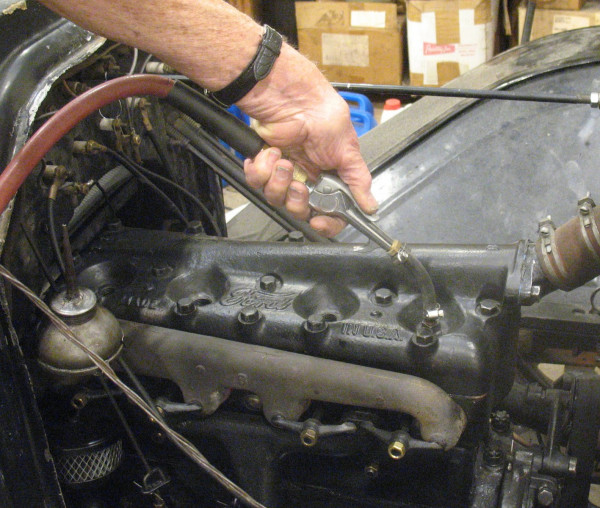

If you haven't already, Try adding compressed air through the spark plug holes. That may help in determining where the compression pressure is escaping.

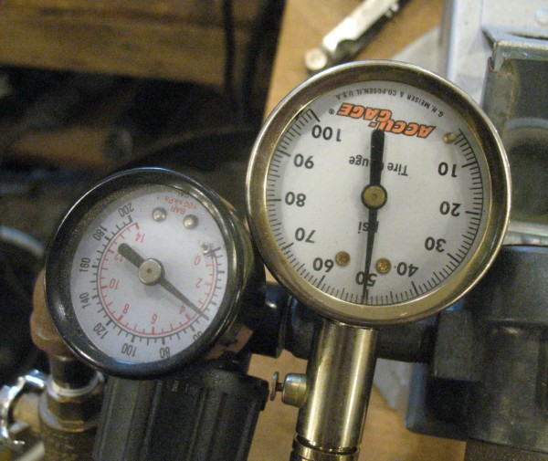

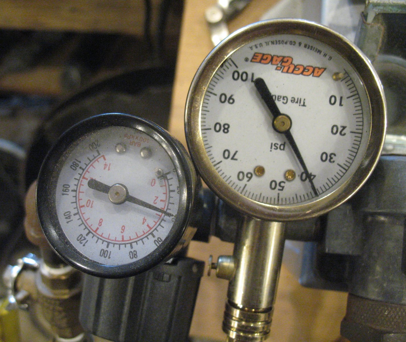

Your gauges could be messed up. Are you using a screw in gauge or a gauge that is pushed into the plug hole and held in place while cranking?
Screw-in, good and tight. Wondering about the accuracy, I screwed it into the spark plug tester and checked it with the regulator.
Setting the regulator at 40 psi, the tester shows 40 psi.
Setting the regulator at 50 psi sends the tester to 501/2 psi. All those bad numbers were real.
tdump
- Posts: 1430
- First Name: Mack
- Last Name: Cole
- Location: North Carolina
Re: The frustration of incompetence
Well that rules out bad tools,scratch that off the flow chart

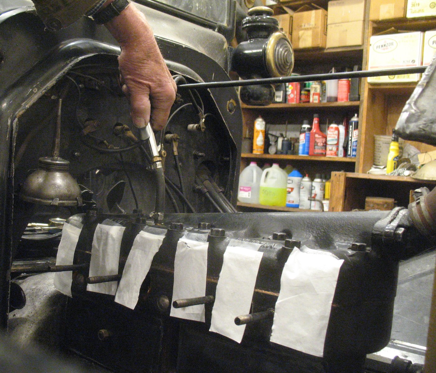

I’m with Art....TDC on compression stroke, hold engine from turning and blow air into respective cylinders. Air should be escaping somewhere, crankcase, intake or exhaust. If not, I would be double checking valve timing.

at TDC compression, do a leak down test and listen to intake, exhaust, crankcase, for sounds of air escaping. One test each for all 4 cylinders. You will find the source of non-sealing pretty quickly with no guessing. Have the car in gear, wheels chocked, throttle open, and don't use too much pressure. This is a simple, gross test which will lead you to the correct source(s).

The tester says it's compression.
I haven't done this before.10 psi enough, or more?
Ruxstel24
- Posts: 2410
- Last Name: Hanlon
- Location: NE Ohio
No I would use 60-80psi. Just make sure the valves are closed and the engine can’t turn over.Steve Jelf wrote: ↑Tue Mar 17, 2020 4:52 pmdon't use too much pressure.
A little air from the crankcase is normal, but virtually none should go past the valves.

Did a compression test and the numbers were 5-35-15-10 not too good. I pulled it all back today to see whats what... Ive blue checked several and so far all Ive noticed is about a 25% contact by pushing down with my finger. If I give it a tap with a piece of brass, I can feel the valve settle down into the seat another .010" and make 100% contact. The valve then needs to be popped back off the seat with my knife under the stem. The cylinder that showed 35 psi doesnt do this. I tap on it to seat the bluing and the stem twists right back up and out.
I think I am gonna try swapping valves around... any other ideas??? ws
http://www.mtfca.com/discus/messages/25 ... 1325953529
By Bill Stephan on Friday, January 06, 2012 - 01:24 pm:
So the other day, I finished putting my top end together, New valves (1/64 os) adjustable lifters (1/64) new springs keepers and pins. Lapped the valves and everything looked 100%!! Set the lifter clearance at .022"

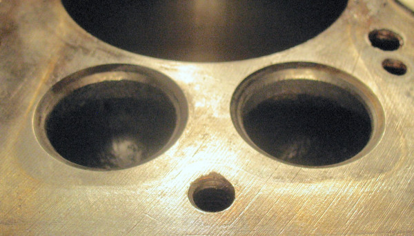

Steve, I looked back through your posts and I do not see any mention of what your valve lash is? When you lapped them, did you blue them up and look at the valve and seat to see what the contact area looked like to confirm full around contact?

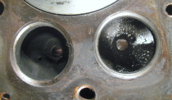

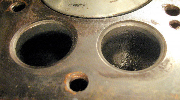

I still say" it is a problem with your rings". Nothing else suggested would change between a dry compression test and a wet test with oil. Think about it. Stuck rings, broken rings or worn out rings.
- Posts: 6790
Well we know you likely have:
broken rings or
worn rings or
bad valves or
worn guides or
timer roller out 180 degrees or
weak valve springs or
wrong valve lash or
sealant on the head gasket is keeping it from sealing
And we also know:
that it would be a good idea to do a leak down test and
that it would be a waste of time to do a leak down test, as it would be worthless
Evidence presented indicates that this can't be fixed and should be sold
broken rings or
worn rings or
bad valves or
worn guides or
wrong valve lash or
And we also know:

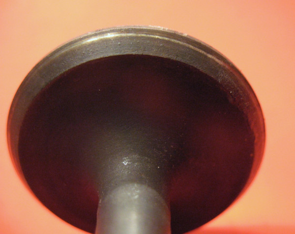

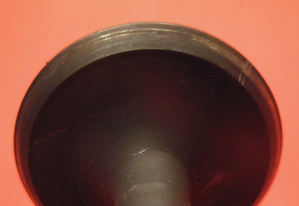

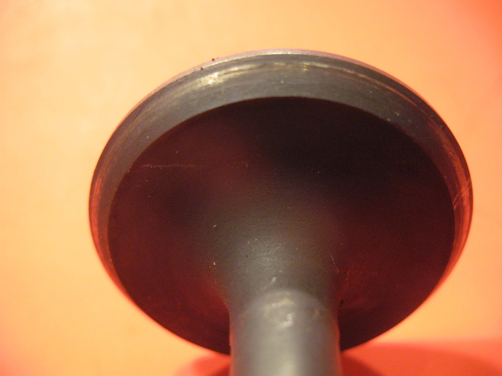

A valve seat should be cut at two different angles, 44 degrees and 45 degrees and the face of the valve should contact about a thin dime. Valves repeatedly lapped have too wide a surface contact. The valve guide also tends to get out of round. Are you experiencing backfiring? I would swear by Sioux Valve grinding equipment. Did you replace pistons when the new crank was installed? I’m working on an A now with a friend and measurement is the key.

doing a compression test dry, then squirting oil into each cylinder will indicate whether or not the rings are perfect. It will not indicate relative wear, discern between worn or broken rings, nor account for the cumulative effect of several or many faults that an engine may have.
a vacuum gauge and proper diagnosis on an engine once coaxed to life will detect:
a problem with rings
a sticking valve
burnt or leaking valve(s)
loose valve guides
late valve timing
late ignition timing
leaking intake manifold
blown headgasket between cylinders
choked muffler
It is a very versatile test, but is not widely used or understood these days. One of the few guesses posited that it will not detect is a timer mistimed by 180 degrees
a sticking valve
loose valve guides
late valve timing
choked muffler

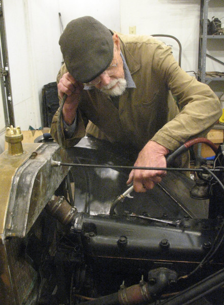

After taking April off to attend to other things, I got back to this today. A month of sitting didn't cure the compression: 33,15, 25, 20.
I tried the leak-down test and it didn't make me any smarter than I was before. I set the regulator at 60 psi, set each cylinder at TDC, and shot in the air. I could hear air moving somewhere, very, very faintly. I think it may have been in the exhaust manifold, but the sound was so faint I'm not sure. With a stethoscope I couldn't hear anything at all. I think this engine needs to go to somebody who knows what he's doing.

A stethoscope won't do it. a piece of vacuum or fuel line will help. Put one end in your ear and hold the other near the carb, muffler outlet, oil filler, radiator filler, and other spark plug holes. With a piston on TDC compression, air out the carb is intake valve, out the exhaust is exhaust valve, a little in the oil filler is normal ring gap, while a lot is broken ring, ring land, or head gasket. Other spark plug holes or radiator filler is also head gasket.

Steve -
Take off the manifolds and do the air test again, setting each piston at TDC. If the exhaust valve in a cylinder is leaking, you will feel air pushing out of the port for that cylinder. The same with the intake. Repeat for each cylinder. You can get a better feel for the leakage this way than by leaving the manifolds in place and guessing whether it's the exhaust or intake valve that's defective. Hold a piece of paper over the open port. If it flutters, there's your culprit! Using this method, I found that valve #6 in cylinder #3 was leaking in the '24 Coupe's engine that I'm redoing, even though we cut new seats with Neway cutters. No matter where we set the piston in the bore, air leaked past the intake.
You may be sacrificing manifold gaskets to do this, but they probably needed replacing anyway.
Be sure to use the high dollar copper gland style gaskets. They seal very well and will eliminate possible intake leakage that could contribute to your engine's problems.

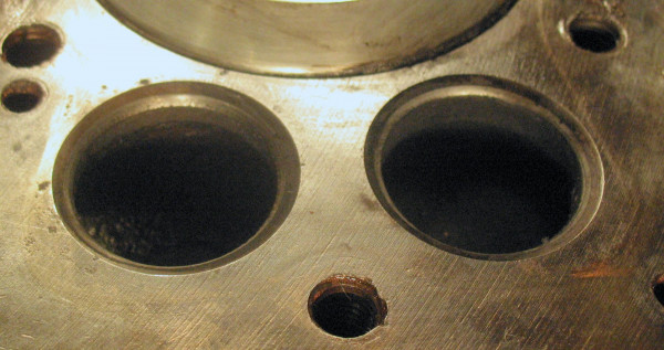

Well, I did the test today following Marshall's suggestion of removing the manifolds.
With strips of tissue hanging over the ports it wasn't hard to see air movement. #3 was the worst, and you can see the tissue on #3 exhaust blowing in the wind. Most of the valves leaked at least a little. I'll do this again and take notes on which valves are especially problematic.
I also stuck a hose in the oil filler and listened to the crank case. I could hear air on every cylinder. I think Fred and Mack are on the mark with their suspicion of fried rings. It probably happened when I ran out of coolant in Illinois last September. I hope that incident didn't damage any more than the rings. I shot some oil into #3 and listened again as I applied the air. I could still hear air leaking past the rings, with a little gurgle of oil blowing through. Looks like those pistons will be coming up.

Great job Steve !! Sounds like you’ve made some positive conclusions and can move forward now.
I also hope there’s no major hidden damage to the block. Probably a scuff with a hone and new rings will cure the bottom end.
I would double check valve clearance before removing them, just to see, but the valve seats should be obvious once the valves are out.
Carry on....
Great idea about the tissue paper, I hope you can salvage some for the bathroom.
Carry on....

That was going to be my suggestion too Steve, the rings...everything else seemed to be sort of correct. One thing though, did you also grind the valve seats on the block when you did the valves? I mean did you do them separately from the valves? It's important to level the playing field first, then fit the valves to the seats. And if you've done all that, then check the rings, in particular the oil wiper ring. Also might be a good time to re-hone those cylinders too, just to give those new rings something smooth to travel on.
Fun never quits!
Topic author - Posts: 7411
I always buy the biggest package for the lowest price, so I had a stock to last several months when the Great TP Panic of 2020 arrived.

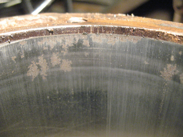

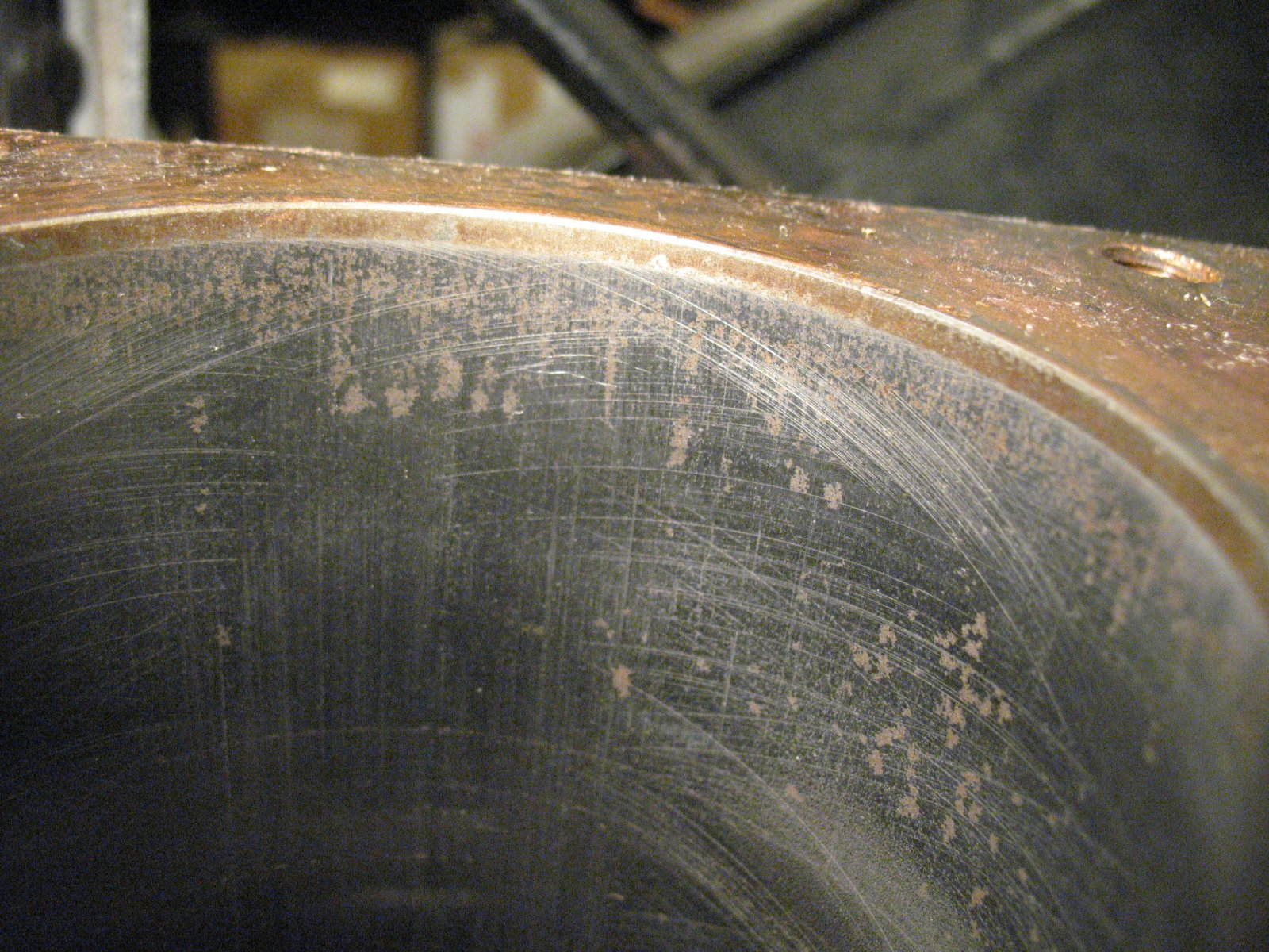

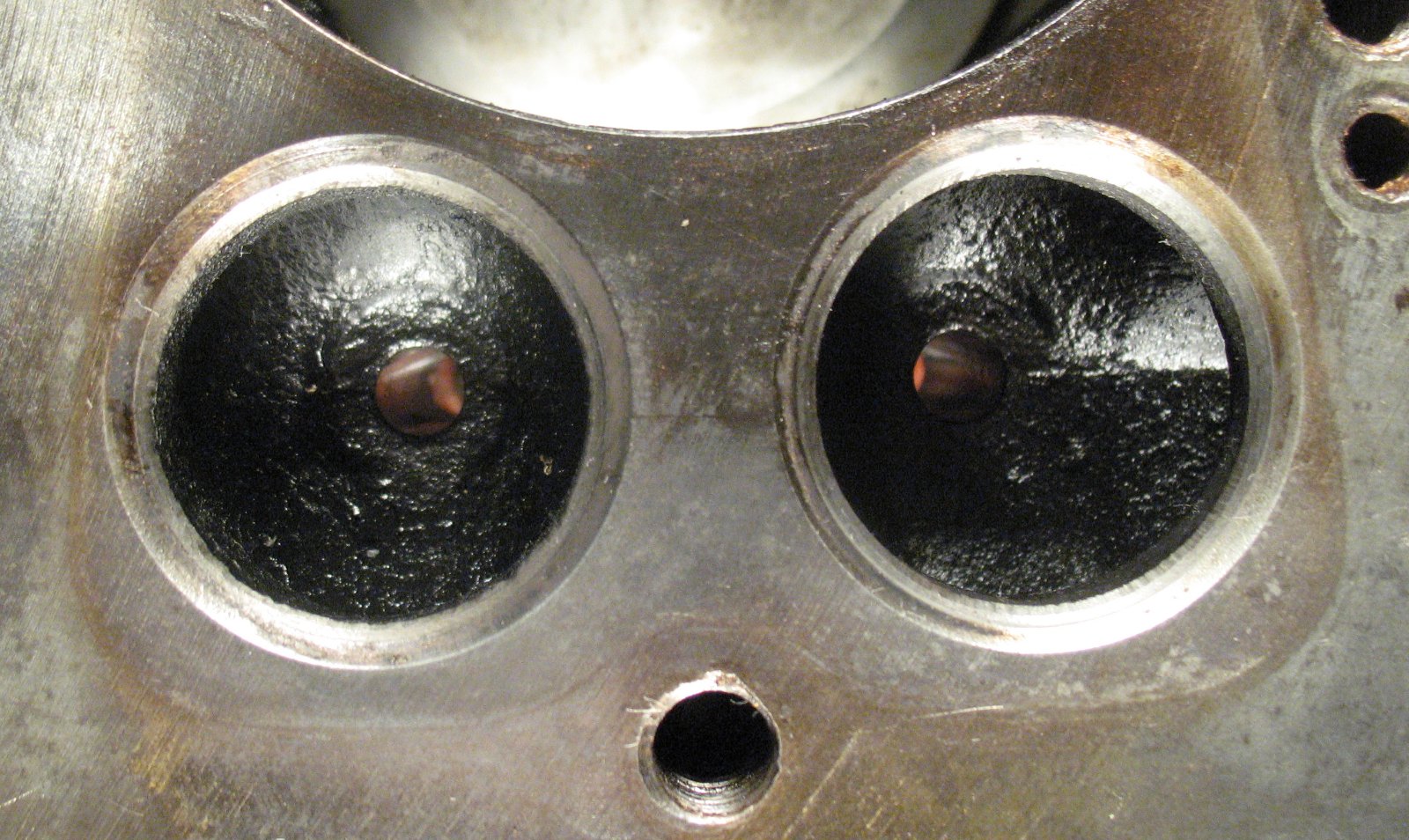

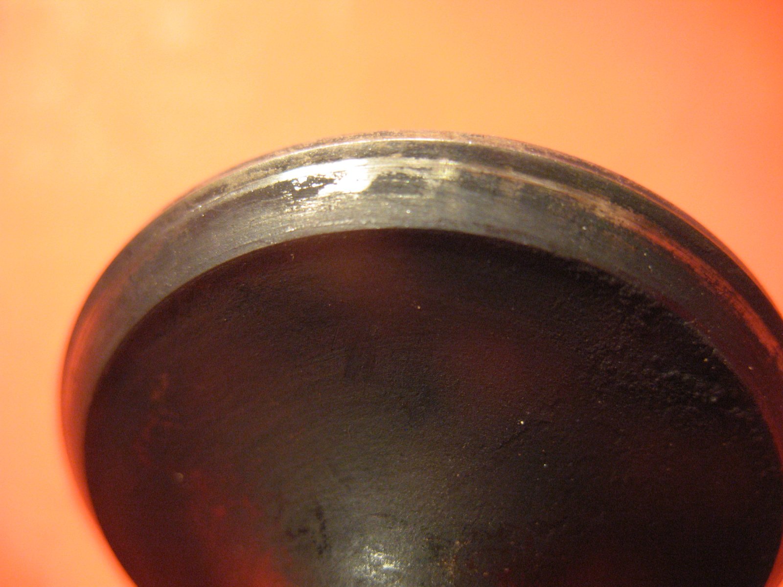

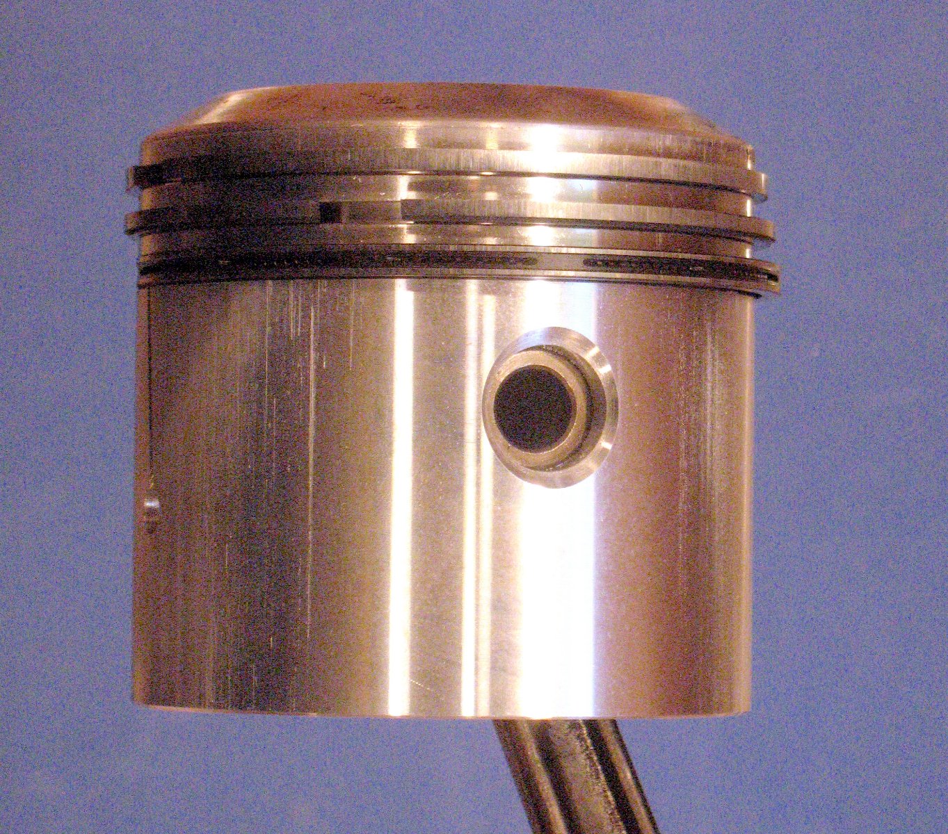

Today I finally pulled a piston to look at the rings.
After previous discussions I was expecting the rings to be fried and breaking apart, but I can't see a thing wrong with these.
What I did find wrong was what look like rust spots inside two of the cylinders. This is in #3. They aren't terribly deep, but I can feel them with a fingernail. I suppose they must contribute to the leakage, but they can't be the main problem. There are none of these in #1 and #2, and #2 had the worst compression of all.
These are in #4. I suppose they must have come from a leaking head gasket, but I didn't find any coolant in the oil.

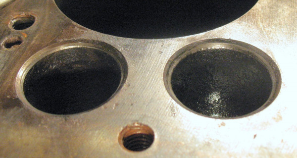

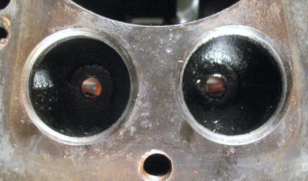

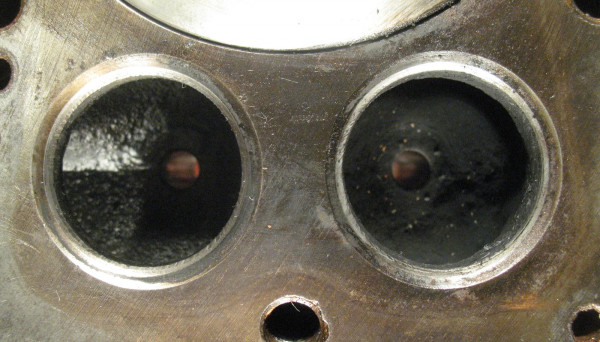

I think the main problem is valves.

The gasket leaks that I have experienced leave drip trails from the leak point, and also leave a rust ring where the water sits on the top ring. These rust spots look more like condensation to me...?
The valve contact area on our valves looks really inconsistent, and we already know they were leaking... but you neglect to show pictures of the valve seats or discuss how the valve seats were cut/ground/lapped

Steve, I don't think that pitting in the cylinders is causing any detectable issues. I do see some slight scoring o the piston skirt, but nothing worth worrying about. Are those cast iron, or chrome rings? Chrome rings can withstand higher heat ranges than cast iron rings.
Can you show us pictures of the valve seats? Did you ever check and see what the valve lash is? Also, check the clearance between the valve stems and valve guides.
Hello Steve,
I will cut to the chase. With the vertical scoring completely around all three rings, the rings are trash. The vertical scoring on the piston and cylinder walls also leads me to believe the piston and possibly the rings started to seize in the cylinder. If you can feel the vertical scoring in the cylinders with your finger nail, the cylinder scoring is excessive. This appears to be your main problem to me.If I remember correctly you did state the engine was overheated at some time during your travels.
Now for the rust pits you can feel with your finger nail. Those types of rust pits can damage rings, although I do not feel it is the primary cause of the ring failure at this time. If it was my engine and I wanted it reliable I would be re boring it.
On the valves. It looks to me like they are basically seating about one third of the way down from the top of the valve face (the shiny area) which is correct. What I see wrong is the seat width is not wide enough and is inconsistent around the diameter. I believe this is a secondary problem that should be corrected as well.
Respectfully,
Terry.

The compression would not have gone up with the addition of oil to the cylinders if the rings were good. It's not rocket science. It's n.g. rings. The valve seating is nothing to scream about either BUT re-read line one of this post.

OK, I don't know if the pictures are good enough to show anything, but here are the valve seats. There are two shots at each cylinder, one from straight above and one from the side.
#1:
#2:
#1:
#2:
#3:
#4:
A couple of questions before I go check some other things:
1 This engine is already bored .080" over. That's the safe limit isn't it?
2 Would a cylinder hone be an adequate alternative to reboring?
#4:
- Posts: 6790
Steve
you absolutely MUST change the rings. It isn't terribly expensive or difficult, but if you do not, Charlie will haunt you forever. It will of course not fix any of the air blowing past the valves, but at least he will be able to sleep at night.
I think you have a pretty good grasp on what needs to be done, including figuring out why so much moisture got into #4. That thing looks nasty and I wonder at this point if you don't have a crack in the head somwhere that bead blasting and dye penetrant testing might uncover. That's a lot of rust in the top of that cylinder to not have a blown head gasket obviously showing up
Steve, did you clean the top of that piston? Or, was already that clean? Show us the tops of all four pistons. Also show us the chambers of the head, if you have not cleaned it up yet.
