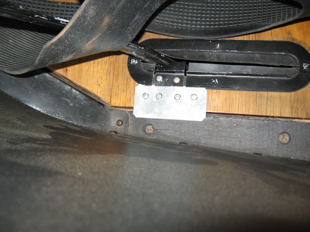

I have my brake lever bent over to the left on my 1924 for more foot room. This made it impossible to get the rear floor board up past both the brake lever and my center Ruckstell shifter. I ended up cutting a notch out of the brake lever slot and re-attaching it with screws and a sheet metal plate so that I can remove that section and expose the notch when I want to pull up the floor board.
