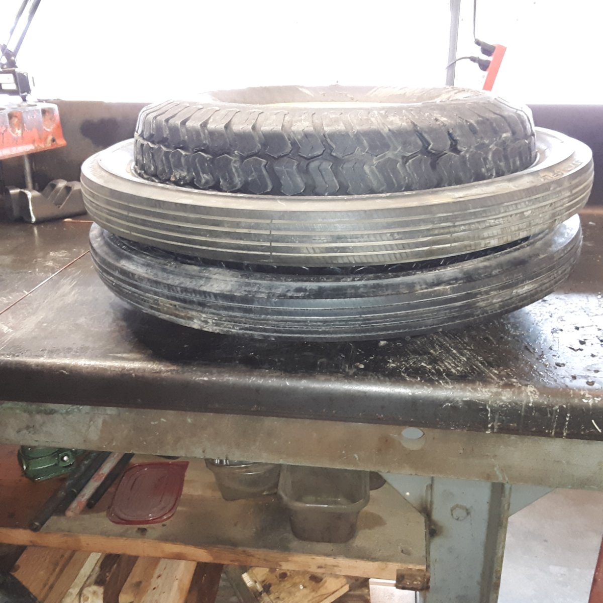

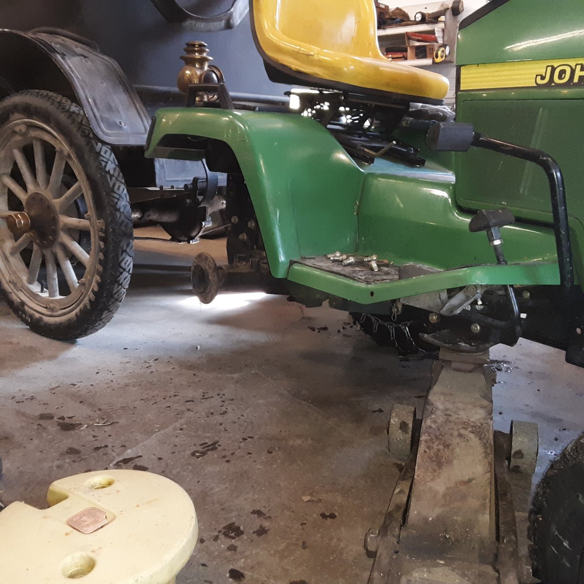

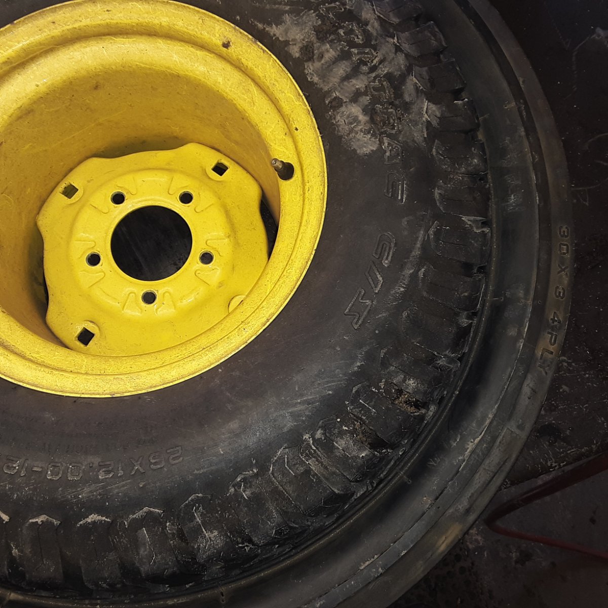

I have 2 new 30x3 tires that had shrunk. I needed to expand the bead, so this was my solution. Suppose I will have to buy another JD to do 30x31/2 tires.

What a great fix

John, in theory a 30x3 and a 30x 31/2 are both 30" tall. It has really nothing to do with the width.It is the height of the sidewall.3 plus 3 equals 6 subtracted from 30 equals 24. 3 1/2 plus 3 1/2 equals 7, subtracted from 30 equals 23. A 32x6 tire goes on a 20" rim. I struggled understanding this till someone explained it to me.
