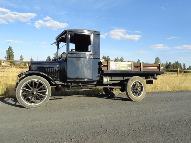

Frame is tall and LONG, compared to a regular T frame. Rear wheels are thick and heavy.
Regular T's use the same wheels front and back. Rear end on a TT will have an over-the-top
worm gear input. T's have a more "normal"/modern looking rear end.
I can get measurements in the AM, if you like.
C-cab was introduced in 1923. This example wears the early TT 23" rear wheels, that look
more like the front wheels.
This example has the box cab, introduced in 1924 and wears the later (post-1924) 20" wheels
that look much heavier than the front wheels.

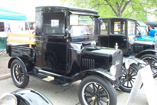

- Posts: 4101
Re: 1925-27 rolling chassis to TT?
Car chassis trucks were made back in the day, all wood bodies.
And some owners go all out to put Ford factory Ton Truck (TT) metal enclosed cab on the T car chassis too! Bed is car metal bed

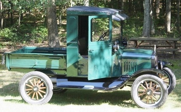

Dan that last picture is just amazing how perfect it looks. I cannot imagine what it takes to get them to look that good.
- Posts: 4101
Ignacio
Sure we can imagine, just takes $$ and some time, skills help, depending on how the finished T is invisioned
Another on T car chassis to view.....before and after of the green one. Today its fully finished now.
