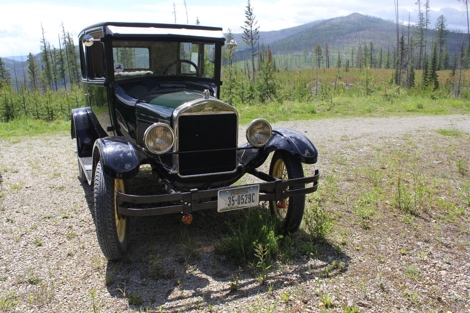

I'm running a KC Warford with a 4.1 diff. in my 27 Tudor. It is a great combo for running in the mountains of Montana and Idaho. We do a lot of logging road over the mountain type driving and the gearing is just right for both off or on highway. The KC is pretty quiet also.
