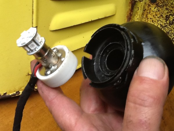

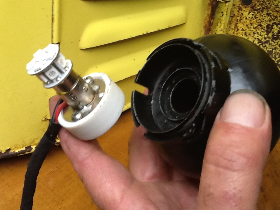

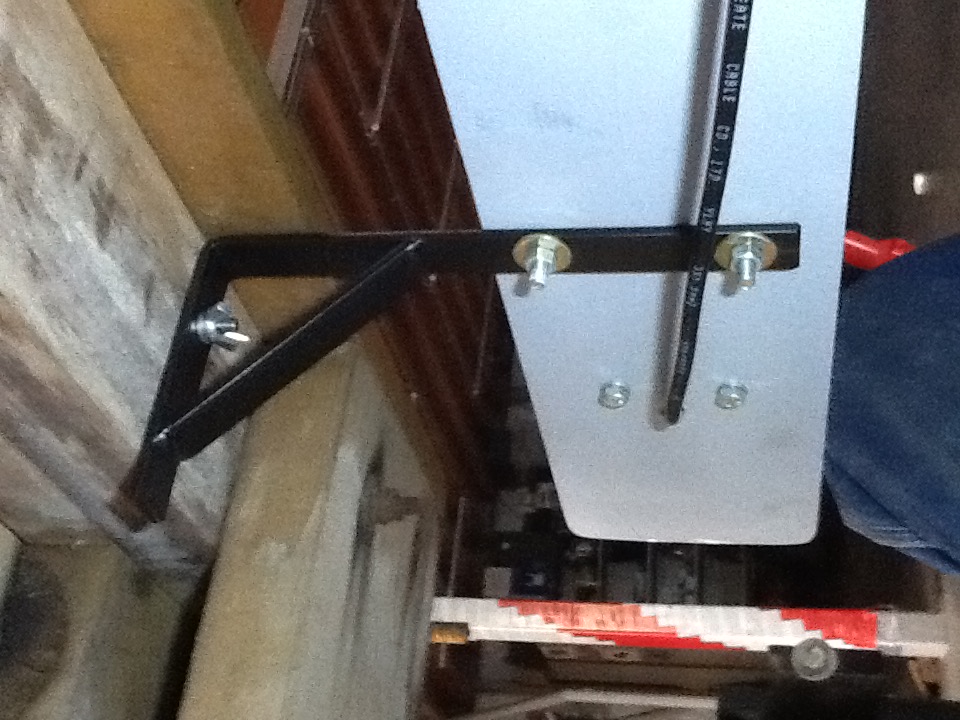

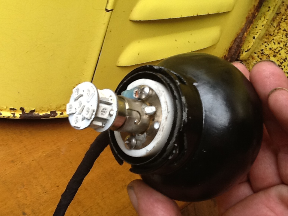

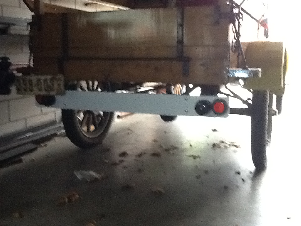

The biggest problem with hand signals is that these days drivers do NOT understand their meaning, biggest problem is with the left turn and slowing down signals, these days sticking your arm out is generally understood as the signal to allow a tailgater to pass, which is a big problem when slowing down to make a left turn...
The tailgater behind you speeds up and comes alongside while you are slowing down and moving over to the left, a bad scenario indeed !
My solution was to convert my side lamps to blinkers in a way that allows me to return them to petroleum in two seconds, and to affix a white board with brake and turn signals under the rearend with two wingnuts and a trailer connector plug so it can be taken off so all looks original for show purposes.
Safety First, i've never been rearended and hope to keep it that way !
