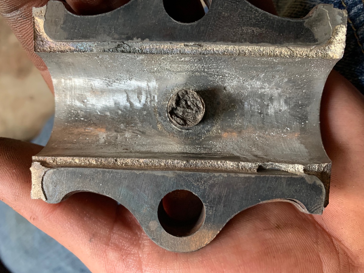

So I know this ain’t nothing to write home about but I was able to tin my first set of caps and pour the center main using the knowledge I obtained from Mike Bender, I tinned the caps with superior flux no27 and a piece of Babbitt, the tin job came out very well in my opinion with good coverage and no bare spots, the center main was then poured and it came out ok, there is a flaw at the top of the cap where the oil relief is cut, so no harm no foul I guess and most of it may cut out when line bored, but still would like to know where I went wrong, I’m under the impression that maybe I could of leveled up the cap better, and maybe pour a little faster I don’t know, and I know time is no big deal with caps but the sprue (or pour spot on mold ) did take quite awhile to knock down and I don’t have that kinda time when pouring the block What do y’all do to cut it out of the way, and maybe next weekend I can get the first and third main poured I’ll keep y’all posted on my rookie goat roping deal I got going on here haha, any advice would be appreciated

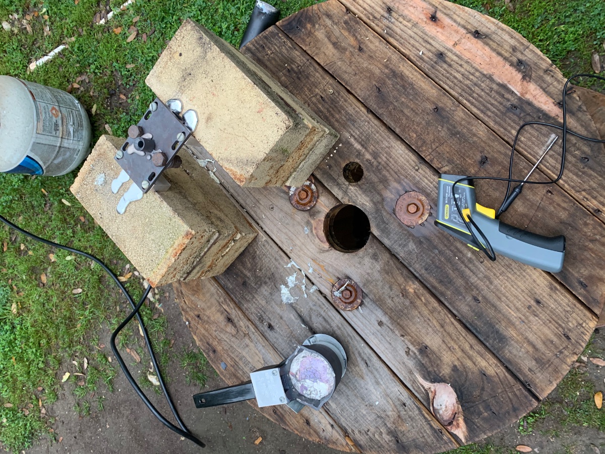

Hello Jacolb, great try !
I gather from the pictures that you are doing the pouring outside, which is probably healthier, but that could well mean that the moulds and caps are cooling too quick or are too cold from the outset, causing the babbit to sollidify too fast and not filling the mold completely and/or causing crystalisation.
Some engine rebuilders like to get the parts to be poured real hot, others go by the Ford bible and pour 'cold' and both get good results, but 'cold' in this case is not icecold but rather not close to the melting point of the babbit.
You can allways heat the caps and pour out the babbit in your melting pot and have another go at it ;)

Jacolb:
you will cut a "well" at the edge of the cap that will eliminate the void seen in your photo … I mill a 45 deg. angle "well" into both the block and cap … stopping about 3.8" from the ends of the bearing …
regarding the spru (gate) ...I use a wood chisel to make several cuts into the side of the projected spru very near to the base of the unfinished bearing bore … then tap with a small hammer to snap the spru off … will snap at the cut marks …

Kaiser it very well could be to cold i’m in Texas where we drink water from a Hoof print and are happy to get it it is about 65 degree is that too cold haha I’m still learning and just kinda farting around thank you for the advice my next pour I’ll try inside the soldering salts just kinda of made me worry about ventilation with all the hazards on the container haha
Gene thank you for the advice as well, and got to say I very happy with your products the mold is perfect and am excited to get to mount and use your line bore lite

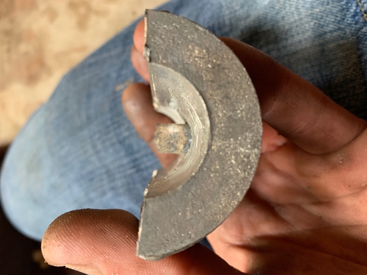

Well guys the third main turned out to be a horrible fail... don’t know where I went wrong but the mold seemed level, anti heat damming the front plates but I couldn’t get the mold to fill I believe my tin job fell short and the upper edges and didn’t give the Babbit anything to bond to so it just poured out of the vent holes leaving the void you see I’ll melt the Babbit out and do it agin maybe tomorrow any advice would be appreciated

Post by JacolbEdwards » Fri Mar 20, 2020 11:08 am
Pictures of how third main turned out better luck next time

Looks like trapped air to me :?: If this happens again you could consider putting some small scraps of very thin paper between cap surface and mold so as to give the air a way out, if babbit flows onto mating surface of the cap it is easily removed with a few carefull (sweet)file strokes.

Kaiser what can I do to aid trapped air? I just tried to re pour the third we’ll see how it comes out still HOT

The idea is to give the air a way out, air is thin and needs just a small way out, so just putting small strips of for instance sigarette paper between cap and mold will probably be more than enough. a shim would close up the entire surface and give too much clearance.
Another more permanent fix would be to make some filemarks on the cap, not take material off, just some scratches to give the air a way out.

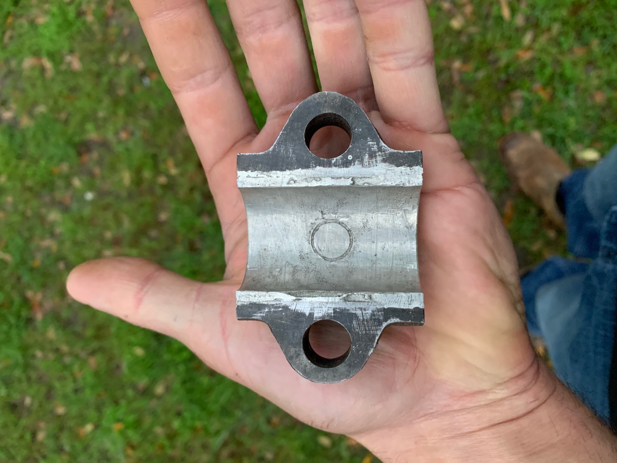

The second pour of the third main was a success I poured before I saw kaisers suggestion on adding cigarette paper or Kerry’s suggestion on using a shim stack next time I’ll try that I am using gene french molds and it does have some venting and found that I heated to cap up quite a bit more and got a good result but when I melt the Babbitt back out of the cap it will tell me if I was hot enough on the tin job and pour thank you for all the advice everyone and I’ll keep posting with progress and results

Great, thanks for the update, looking good, you're on your way !

the endcaps are vented and with proper , even heating will produce a good pour … I see in your final picture that Babbitt spurted out of the vents at the top of the endcaps … this should happen each time you pour … this indicates a full pour and rapid rate of pour … good job … if you have these results each time you will get a good bearing …

Jab I started using the temps mike bender gave me and got much better results 500+ degrees on cap and mold and 900 plus on Babbitt I found that when the dross on the top of your Babbitt starts turning the color of pencil lead your at 900 plus I tested this theory with a IR temp gun with a probe
Gene your mold is perfect it allows venting for a proper fill and and minimum clean up, my problem wasn’t air it was heat I would recommend your molds to anyone in the market for molds
Thanks to all, I will continue to post results I have first main cap left then on to the block, I purchased a line bore lite from gene french sometime back and will start a separate post on line boring my block
