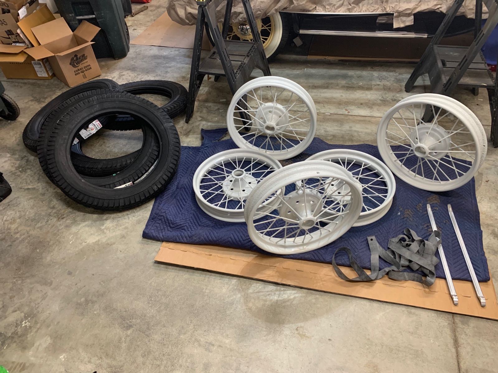

And worrying about the universe. I’ve been putting this off for a while because it’s been cold and I don’t like changing tires. If I get somewhere without getting mad I will post the results. Wish me luck

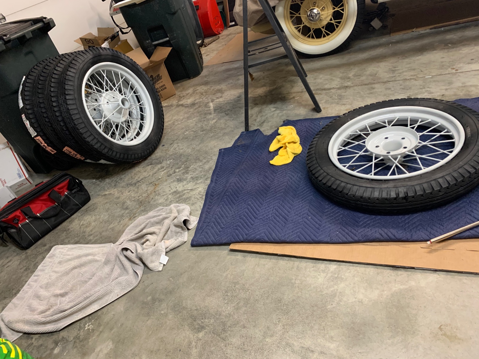

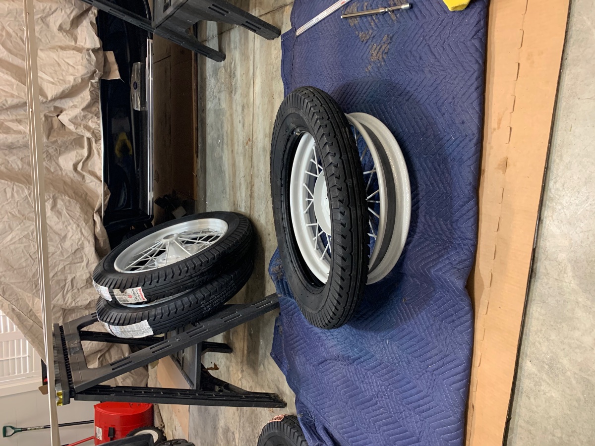

Post by dmdeaton » Sun Mar 22, 2020 2:26 pm
2 down

I believe "drop center's" are easier to mount with the wire rim still on the car - I've done them both ways but if you're concerned about nicking up the finish on the front side, mount from the back side.

Those drop center rims are the easiest to mount tires on. If you do it right, the first one might take maybe 45 minutes to figure out. The following 4 might take 5-10 minutes each.

I am mounting from the rear and going ok. My frame isn’t rolling enough to mount while on hub.

Biggest pain is getting the valve stem started in the hole. Cannot find my cable tool to fish it through . The rest are going good now once I got my groove. Gone now cause I sat down 😳

All finished but got in a hurry on the last one and pinched the tube😥

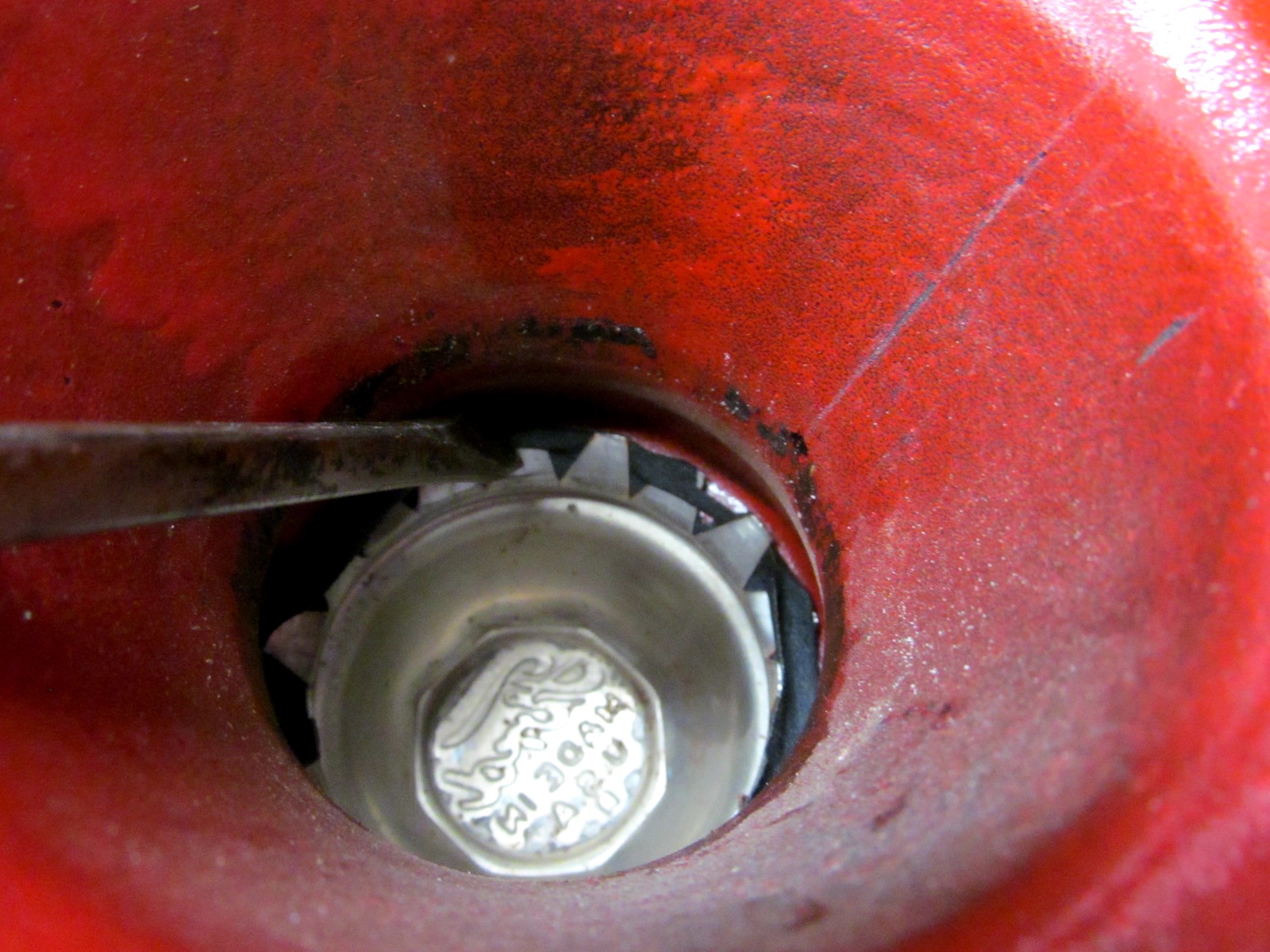

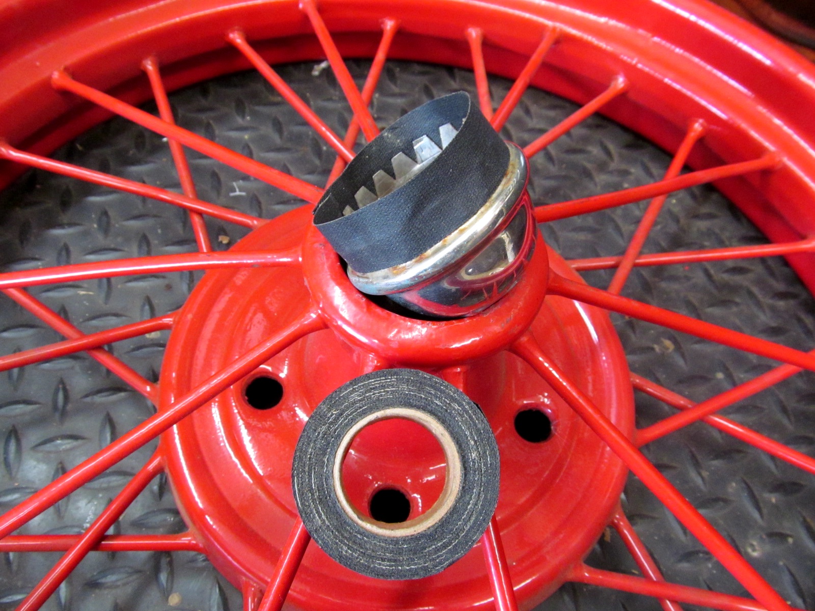

What’s the consensus on bending the hub cap tabs? Punch and hammer? Dab of silicone to keep from rattling or will they be tight enough just bending?

Bead of silicone may work, haven't tried that. But use a wrap or two of good ole friction tape, that fills the gap and prevents rattles as the repro caps are a bit undersize.
A long screw driver or wood dowel used to bend over the tabs, typically do just every other one. Cap held firm by wheel weight, pushed tight against the wheel center when folding over the tabs.

Another perfect spot for a dab of the famous Ultra Black!!! You don't want those caps rattling around and messing up the paint.
