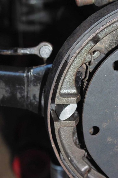

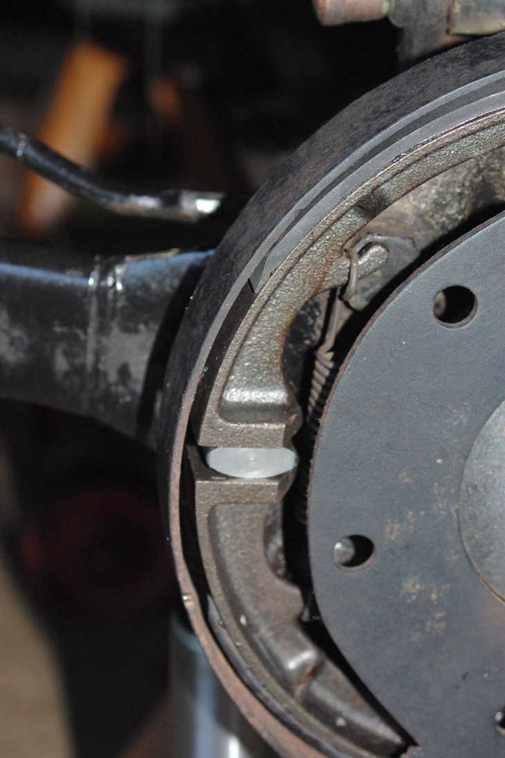

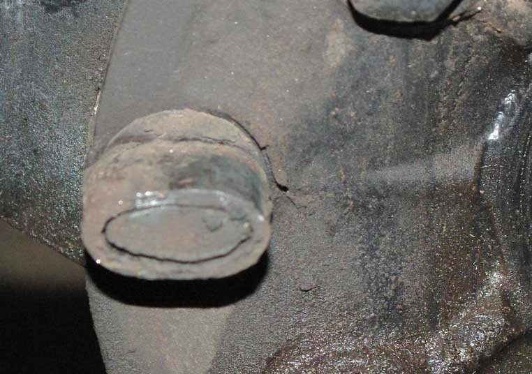

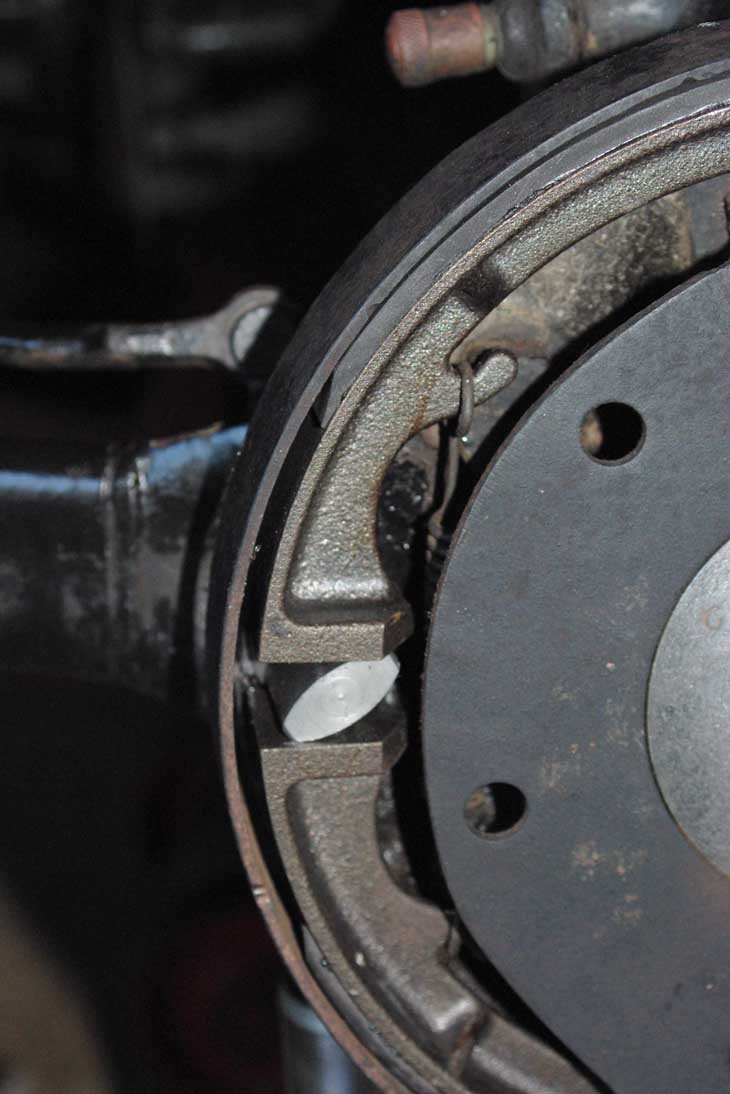

If the handbrake components are in good condition the handbrake will work well. Unfortunately the factory design is poor.The handbrake turns the brake cam spreading the shoes so space needs they to be away from the drums. Wear between the cam and shoe ends over the years means the cam ends up moving so far around it runs out of lift to push the shoes to the drums.
I live in an area that is similar to being in San Francisco and both cast iron drums and lined drums can hold the Model T on them with out chocks or rocks, At some stage one could find themselves in a position where they don't have a passenger to help chock a wheel and they have to keep the car from rolling so the handbrake has to work as it is supposed to. Good cams or slack removed between the cam and shoe ends need to be in place for the handbrake to work as it is meant to. This is what I did 50 years ago when I had cast iron shoes.
I put in lined shoes a few years ago along with new cams.
The 3 photo's should show
high gear , neutral and handbrake on
One other more effective handbrake fix is to fit the shoes to have minimum clearance between the shoes and drum so that the lever when pulled back immediately spreads the shoes. This means the lever of the cam is in the most rearward and effective position, if a slotted clevis yoke is used the rods can be adjusted so the handbrake lever pulls immediately after neutral position but the clevis pin slides back along the slot as the handbrake is moved forward.

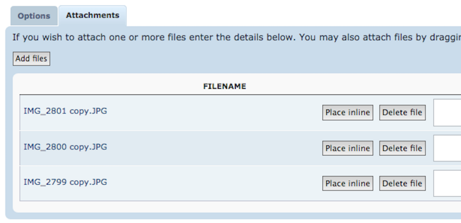

Peter, as you add photo files they stack up with the first on the bottom and the last on top. Note the numbers here:
To post them in order start with the bottom one.

Maybe should have mentioned the ones showing the 3 positions of the cam in relation to the shoes and drum shows a cut away drum I use to check out the clearances.
As the cam raises it looses mechanical advantage if it can go too far towards vertical. lots of wear and lots of clearance between to drum and shoes results in little force between the shoes and drum, add oil and grease on the drum and shoes and you have little or no handbrake.

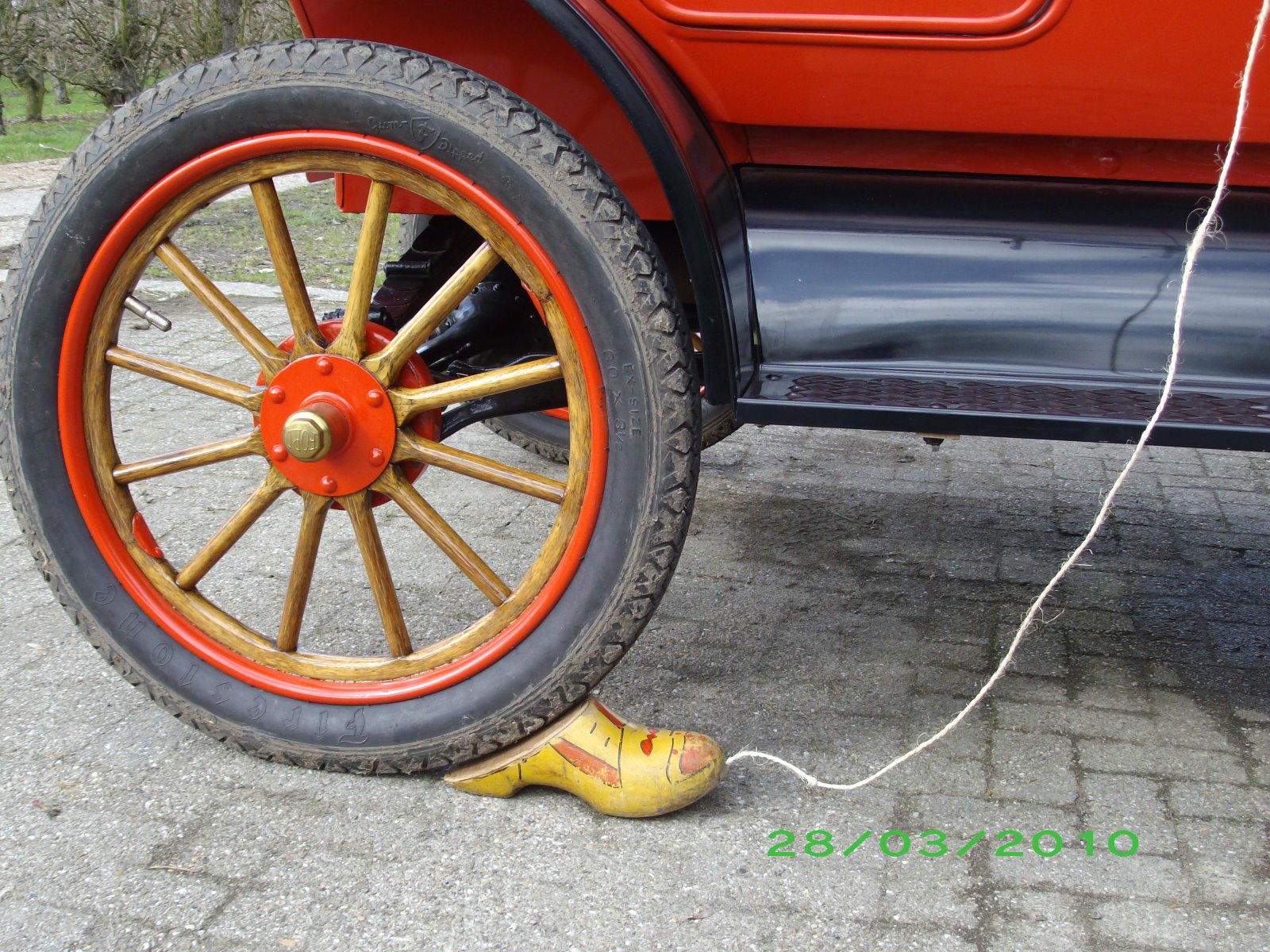

Carson , If your Handbrake don't work , you can always use this .
Toon
Wayfarer
Posts: 97
Joined: Fri Jan 03, 2020 10:04 pm
First Name: Cory
Last Name: Woerth
* REQUIRED* Type and Year of Model Ts owned: 26 engine on a stand, Canadian '23 center door
Location: Colorado Springs CO
Re: Model t handbrake
Post by Wayfarer » Thu Mar 26, 2020 12:11 am
ABoer wrote:
Wed Mar 25, 2020 12:50 pm
the original brake shoe !
