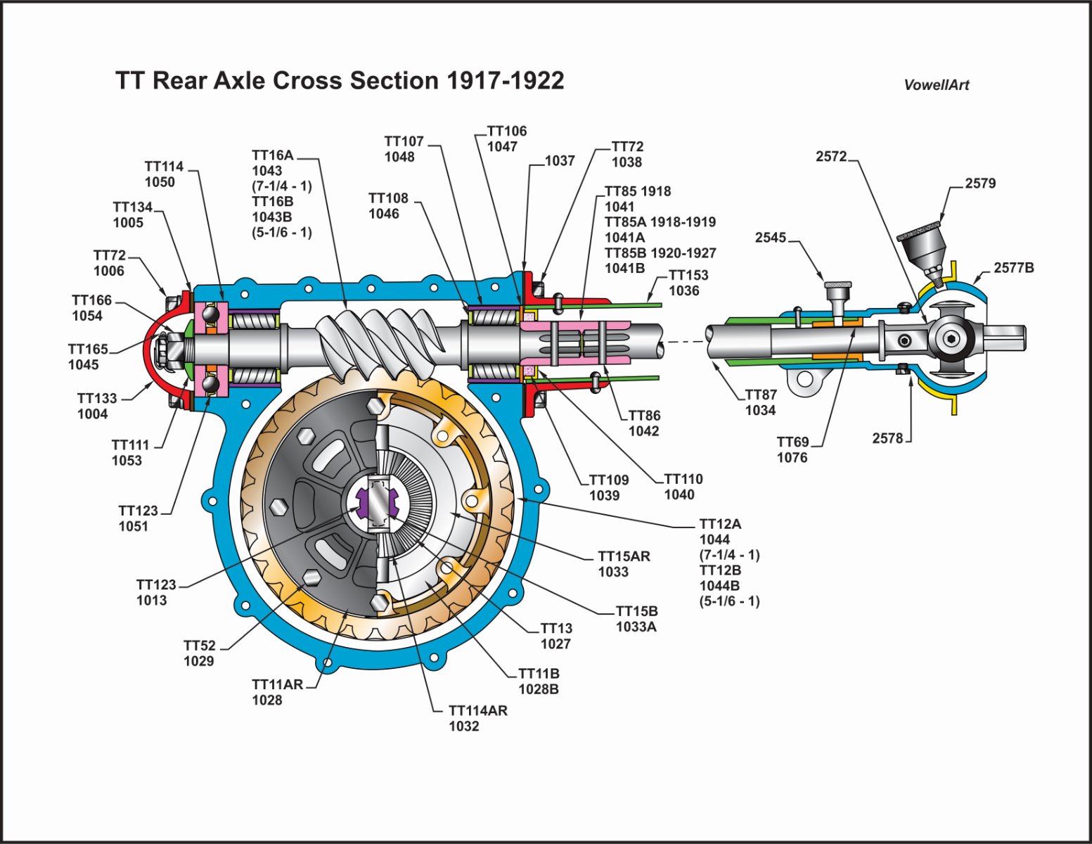

1917-1922 TT Rear Axle Cross Section (Two Pinion Spider)

Great job. Right now the only thing I see missing is the U-joint rivet and the rear pinion cover filler plug.

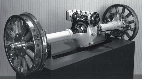

Thanks for posting . Very helpful for reference. Here is one floating around just for fun and a little random

Mark, the rivet is facing you on the U Joint and the fill plug is on the half of the housing that has been removed, so as too show the interior gears and worm.

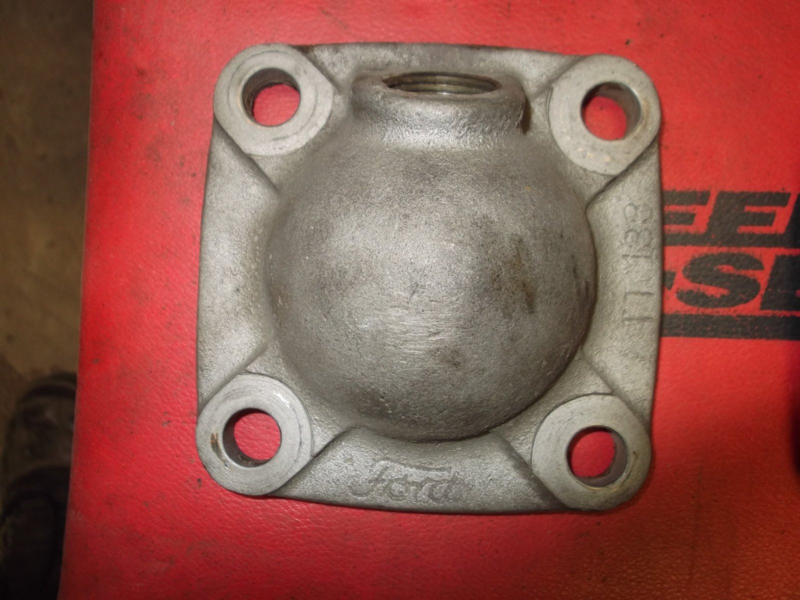

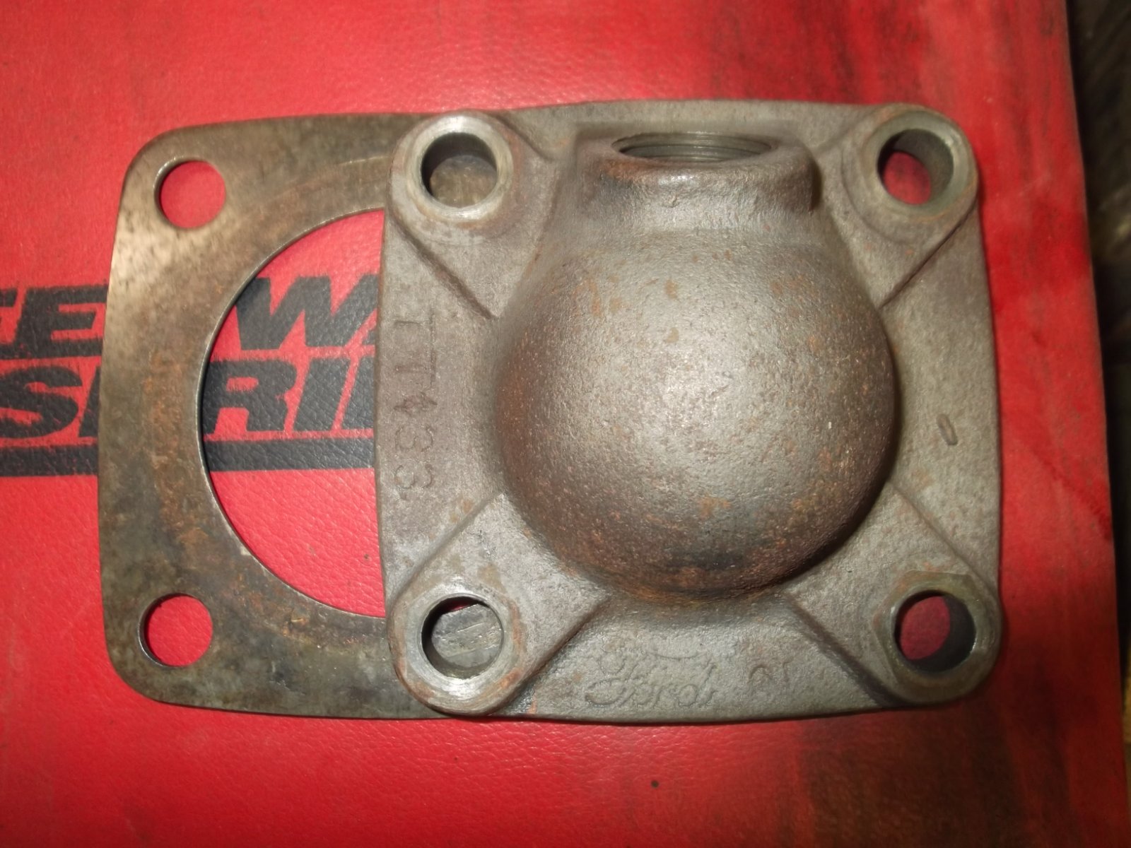

These pictures are correct orientation. This fill plug;

Mark, Hmm, but of course there is no telling where the section line cuts through the object...I Promise, that my exploded view will show this plug and be way more accurate than this is...the next to assemblies are the 1917-1922 TT Rear Axle, the 1923-1927 Rear Axle and the Ruckstell Axle. ;)
