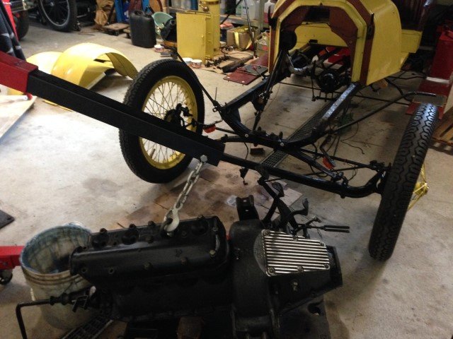

I am currently starting a complete overhaul of my 13 Speedster with Rajo-Head and need your help.
First question: is it possible to check the valves for opening and closing with respect of piston travel. Or is there another method and if so, with which values?
Secon question: How tight should the head bolts be (first time, second time and finally)?
Many thanks to everyone

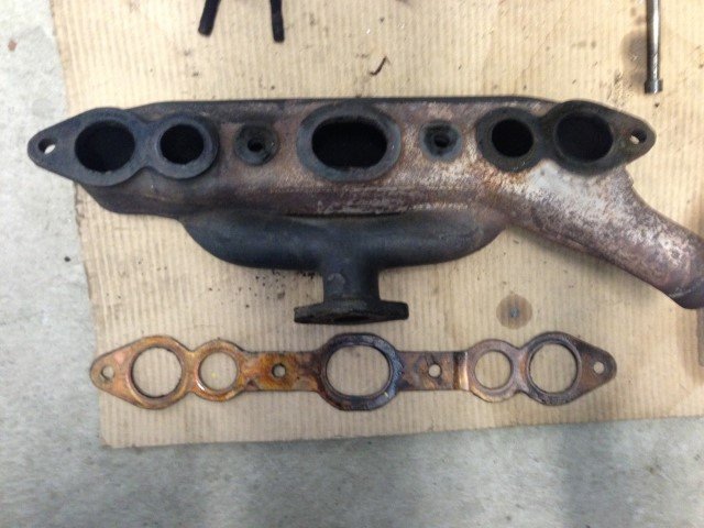

where can I buy a manifold seal as in the picture for my 8-valve Rajo?
And thanks to Erik Barret, Joe Bell, Walber, Dan McEachern for your comments.
Sorry for my Bavarian English
Dan McEachern
Posts: 1506
First Name: DAN
Last Name: MCEACHERN
Location: ALAMEDA,CA,USA
Re: Rajo-head questions
Post by Dan McEachern » Mon Mar 30, 2020 4:07 pm
Anton- no one makes new intake/exhaust gaskets for that Rajo head. Simply reuse the old one with some high temperature RTV around the port openings. If you need a new one, your only option will be to cut one from hi temperature gasket material. McMaster-Carr offers some Kevlar material that works quite well, and something similar should be available in Germany.
