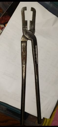

I got this a while back at the local flea market. It is marked Stevens.

A retired Ford mechanic gave me my pair. Excellent tool for the job.

Oh come on, what's it for.... ;)

Tool to hold and turn the u joint to mate the engine to driveshaft. Everyone needs one.

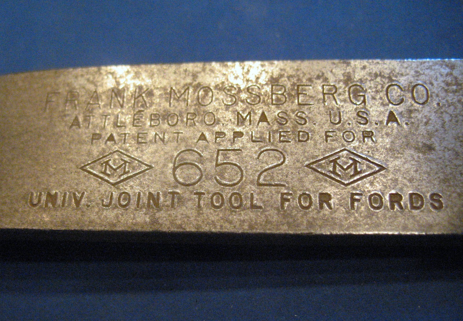

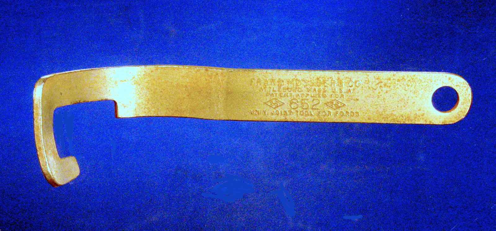

This is the Mossberg tool for that job. You see it (or one like it) being used in Ford factory films.
I've always had to use the tie-it-up method. Sometimes that has been easy and sometimes it's been an ordeal taking approximately forever. I was delighted to find this at Hershey for $2, as the similar repo costs $25.

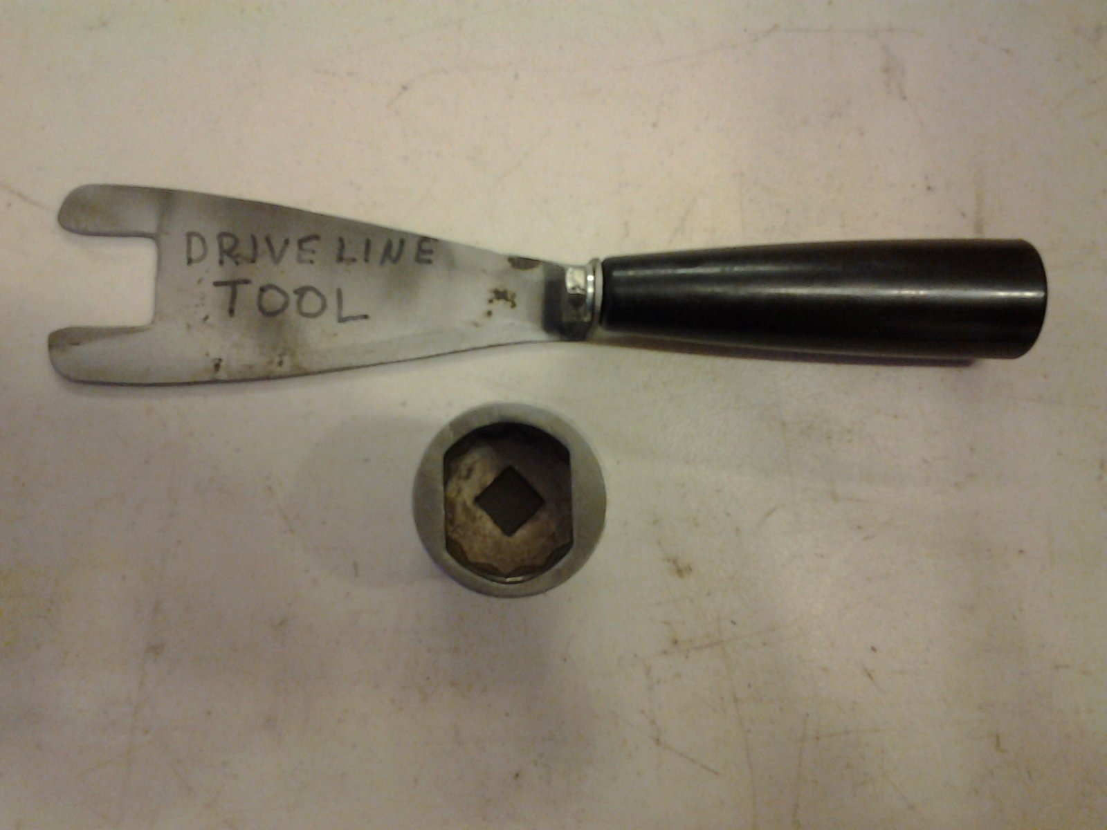

Here is my homemade version of the drive line tool and my homemade camshaft nut socket.

I’m assuming Mossberg made Ford tools also if that’s the same one that’s the Mossberg gun maker.
Is the tool bent or was it made that way. I bet that’s another aftermarket Ford tool that’s gets overlooked if your really not looking for one. Neat.

I did a search and found that Frank Mossberg was a well known inventor and influential person in the early part of the century. He has patents and even invented an early automobile along with making tools and just about anything else related to machinery.
He was friends with Thomas Edison and almost at Edison’s level at being an inventor.
His tools are very collectible.
I couldn’t find anything if he was kin to the gun maker Mossberg but they were living in the same era.
