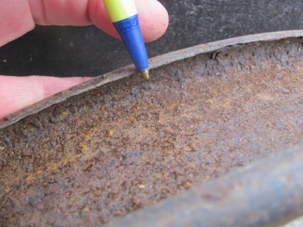

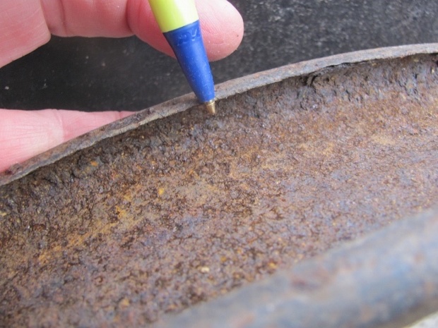

Ditto on careful inspection of the clincher rim edge. IMO, sandblast after inspection of a good candidate for re-use, and inspect again, then prep and paint to keep the metal preserved for the next generation.
Many of the rims still around today have suffered rust--away, large flakes gone and the clincher edge that once was smooth, rounded, and 1/8" thick at the edge are no longer viable.

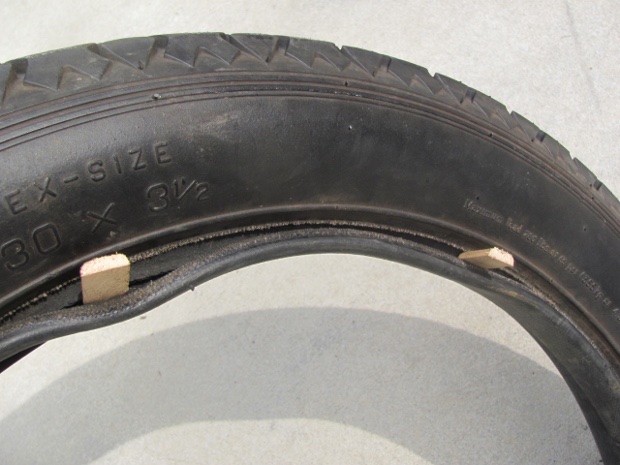

Junker What you get when the sharp rusted away edge rides against your brand new tire after only a short trip
Rim cut, ruined tire $$$

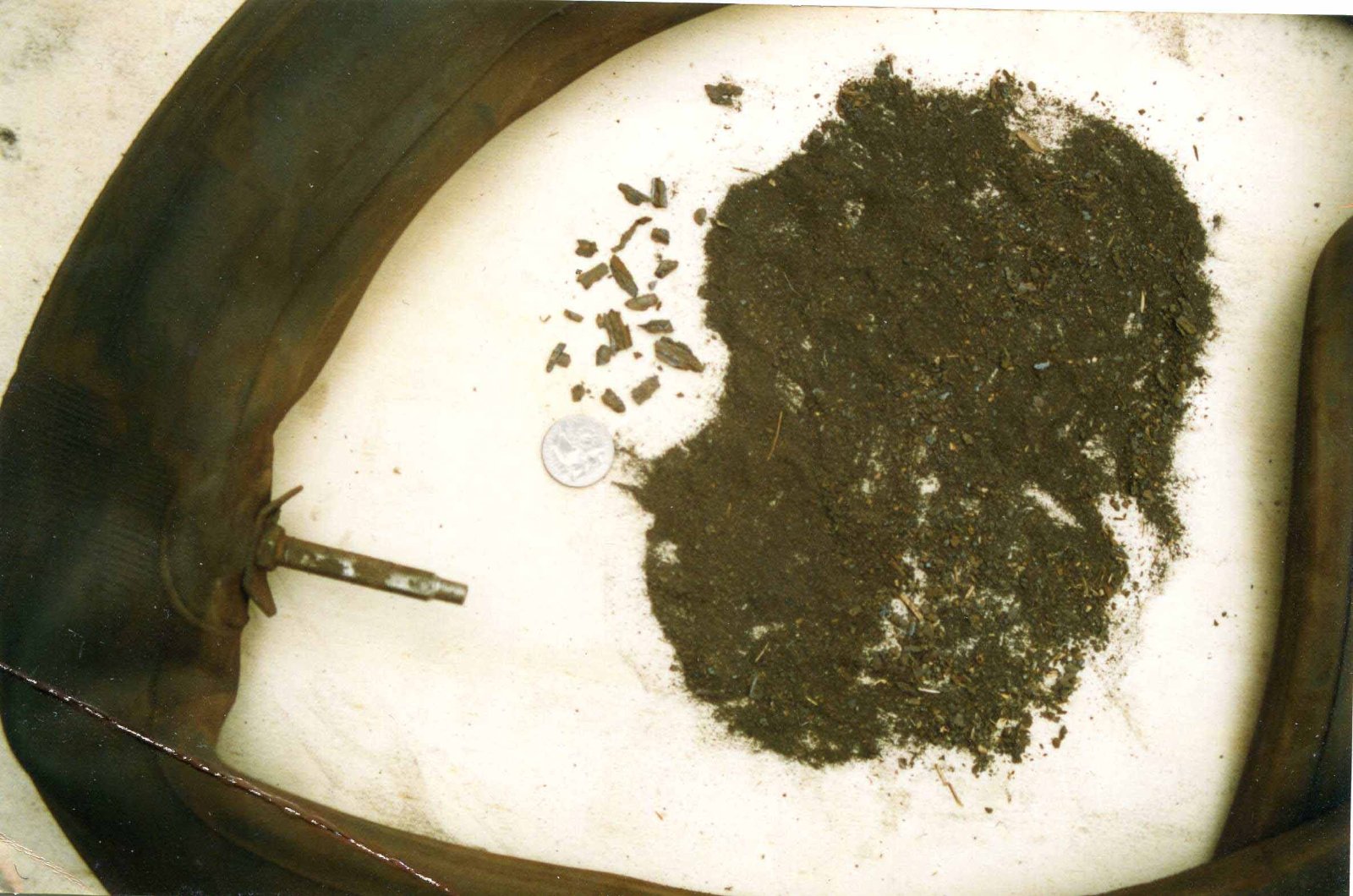

Re: Installing new tires on rusty rims.
Have to agree with Allan, but don't forget painting the rims won't prevent them from rusting.
I have new rims on non Demountable wheels which were well painted with automotive paints.

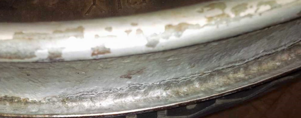

After many years use I had a flat tire and when I removed the tire large amounts of rust and flake paint fell out. ( a good hand full)
Over the years the T had been out in rain and then parked in the garage,
The water can get inside between the tire and rim and if it sits there the paint can't prevent the water from penetrating to the rim. Leave a wet rag on a paint surface and it will result in the paint being lifted off by rust. So a rust band of some sort needs to be put between the rim and tube. Obviously why Ford ended up galvanizing the rims when they were new.
This is a photo I took at the time. thats a quarter sized coin next to the rust/paint flakes.
- Posts: 7403
...painting the rims won't prevent them from rusting.
I can attest to that. At last year's midwinter clinic I was supposed to do a presentation on installing metal valve stems. I took along a clincher rim with a tire on it, thinking I'd dismount the tire and put a metal stem in the tube as a demonstration. The aluminum-painted rim looked great and the tire seemed to be good. But when I started to dismount the tire I found it was rusted to the rim. The show ended with four or five of us on the floor prying the tire off the rusty rim, and the demonstration was a fizzle. Galvanizing the rims is best.

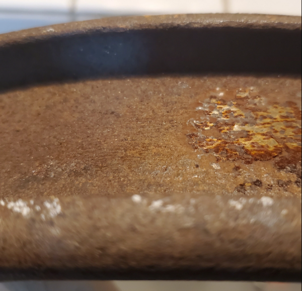

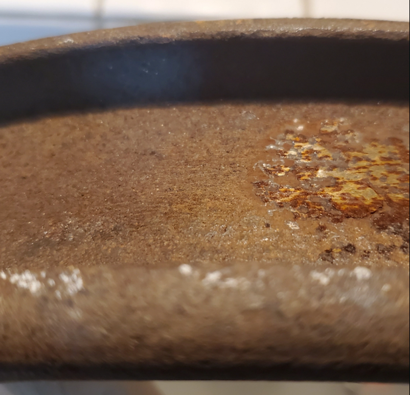

Thanks you for the information. My rims are a bit rusty but not a bit sharp.

Chris, from what I can see from your picture, your rim looks to be very useable. It does have a bit of rust damage on the edges on the clinchers, but not bad at all, if that is the worst of it. How do they look in the clincher area? Rust in that area can lead to failure of the rim. I am sure others will chime in too. JMHO Dave
I agree. If you have a full set of rims no worse than that, I would blast them clean and have them hot dip galvanzed.
