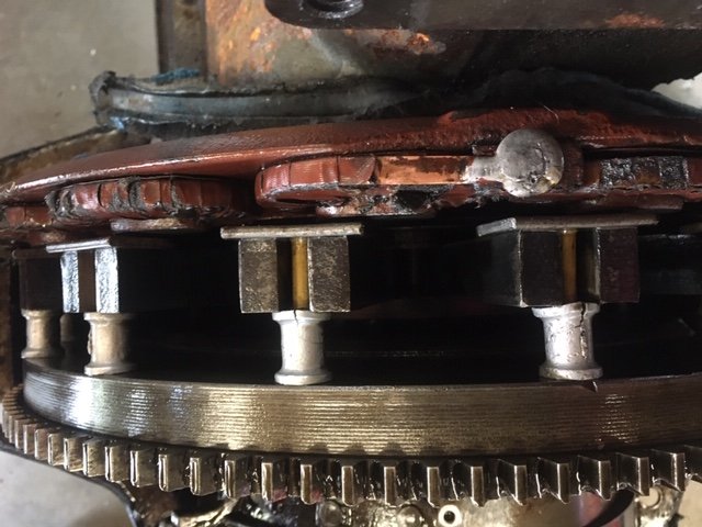

Since I am sheltering at home and saw a speck of dust on my '27 T pickup and decided it was time brush it off. One thing led to another and I've almost got the car clean. I decided to post some photos of what I found under that speck of dust.
I finally got the speck of dust off and this is what I could see:
Looking back in time a few months ago I installed my engine after some work was done to it. The work was done by an expert until it came time for installation. Then I set up the magnet height and mag clearance whilst doing the install myself. As always I "tapped" my magnets down until all were within .002" of each other. Problem was they were significantly out of level and Ford calls for using a copper or lead hammer to lightly tap. I have done the tap thing many times over the last 20 years. This time my tapping was more vigorous. Close inspection of these 90+ years old aluminum cast spools indicates cracks in only 8 of them. Just so you won't call me "frugal" I decided to splurge and get all 16 spools for $20 (how can I be frugal, this is four times what the whole car cost!).
All I can say is maybe you should be very careful if you try and flick a bit of dust off of your car!
TH
TH

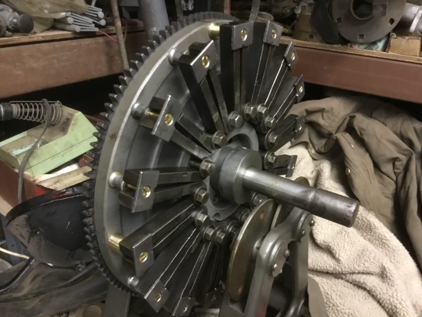

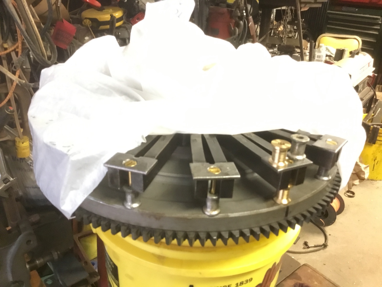

Don’t forget the screws and if you or a friend has a lathe, making a few spools out of brass is a easy way to get the balance spot on.

Terry, I hate to mention it, but that field coil doesn't look too healthy either. While you're in there. . . . .

Maybe that is why Ford made the early spools out of brass!

Whacking magnets was fine when all was new, or almost new, but 100 years later we have to do things differently. First, the brittle century-old aluminum doesn't squash well; it breaks, as Terry has shown. Second, you're taking some of the charge back out of the magnets that you just spent a lot of time putting in. I have practiced and advocated shimming for years. This thread has brought out a nice new kink: I think I'm going to add the multi-weight spools idea to my shim method.
I second the motion on your field coil, Terry. You don't need another dish of copper linguini.

This mag is wonderful. R.V. built it up and gifted it to me about 20 years ago and it has been in continuous service ever since. I have had the engine in and out through probably over 50,000 miles and what David is noticing is a little bit of insulation frayed here and there on the outside edges. As I remember it R.V. gifted this to me as a "thank-you" for the work I had been doing monitoring and maintaining the MTFCA website and forum alongside Gus Stangeland. You don't get more knowledgeable about mags and more generous than R.V.! Thanks again R.V.!!!!
The mag still has an almost perfect coating of glyptol and has been powering Rusty as my daily driver ever since R.V. sent it. I have no doubt that when I am gone this mag will still be powering Rusty!
