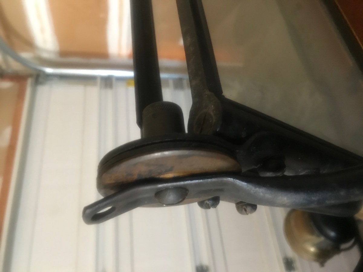

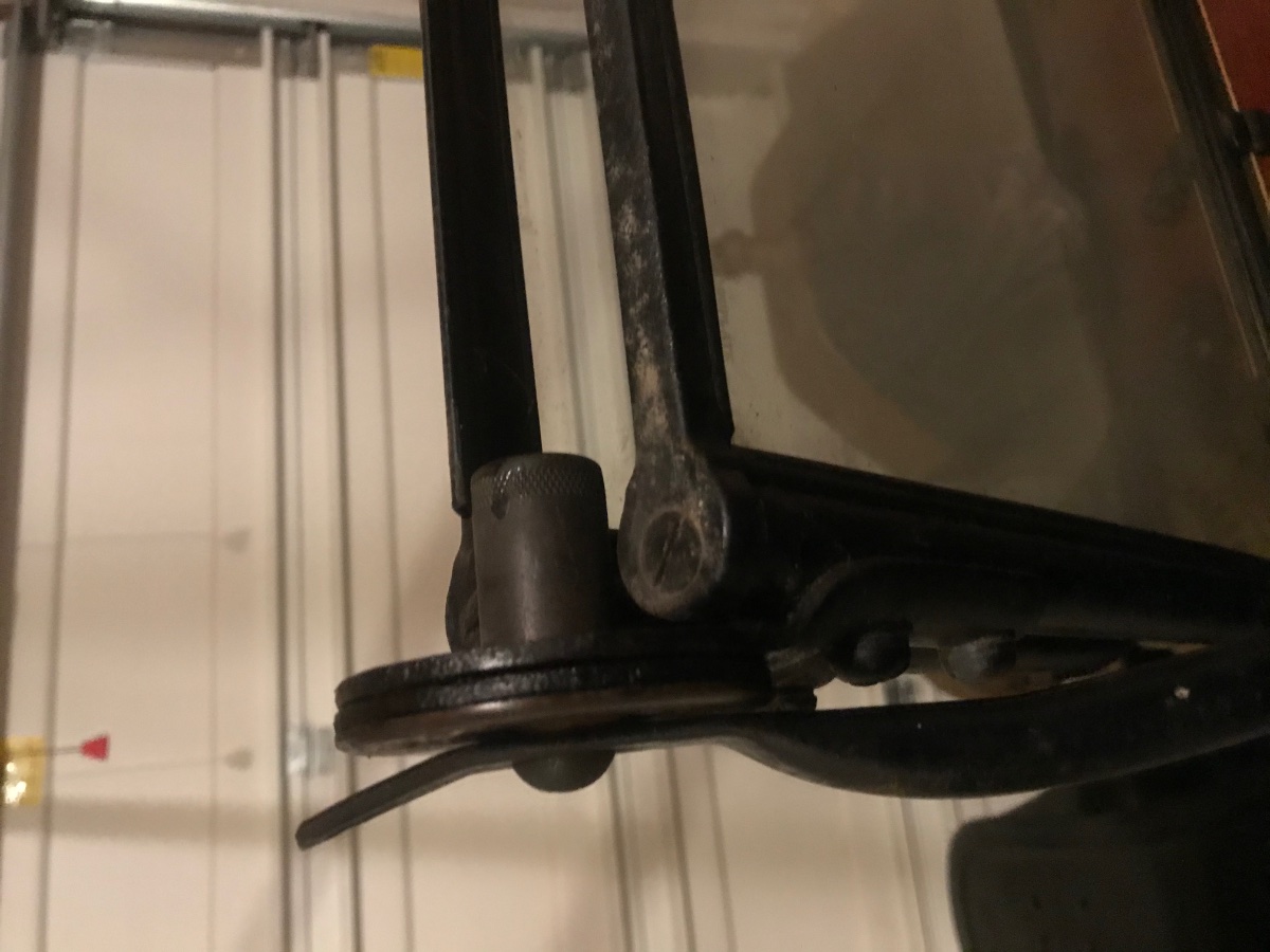

I have not tried to raise the upper windshield on the 1913 Touring that I purchased last summer.
I’ve oiled the hinges with Kroil and let them sit for a few days.
Does anyone out there have a similar set up?
I do not want to force anything.
Thank you,
Gene

Re: Raising The Upper Windshield 1913 Touring
Dang sideways photos!
Click on them to orient correctly.

try loosening the center screw. This will give you a little more motion without the hinge binding.

Once working well, is it necessary to loosen/tighten with a screwdriver when changing position from up to down or visa versa?
Or does that larger nut (for lack of a better term) on the inside loosen and tighten the windshield?

Once the hinge is freed up, you will be able to adjust the tightness of the hinge with the center screw. Should be tight enough to prevent the wind from pushing the windshield yet loose enough to open and close the windshield.

Both of my '13s have Rand's windshields. They have a stud that goes through to the end with a cotter pin hole for a castle nut, which enables the owner to adjust the tension on the spring. The nuts are brass plated steel. I like to use a brass cotter pin for these.
