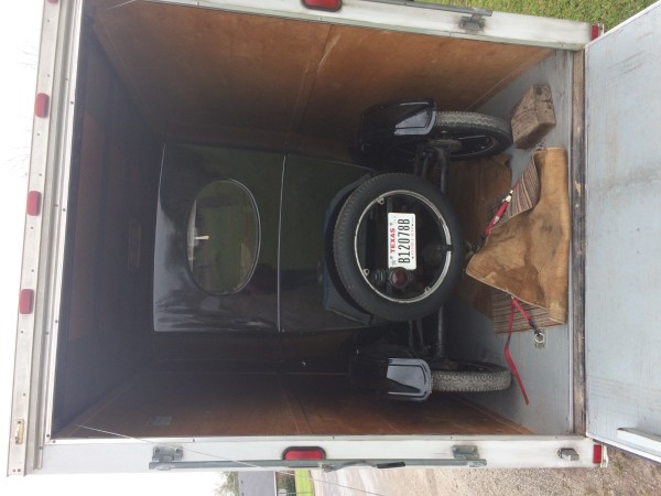

Why don’t you buy my 7’ X 14’ X 7’10” tall for only $4,500 ? Can be pulled by a 1/2 ton truck.Picture with my centerdoor loaded. Also load the ‘14 runabout with top up.

I have the same trailer than George and I really like it. I trailed my 1911 Touring with it and work perfectly.
