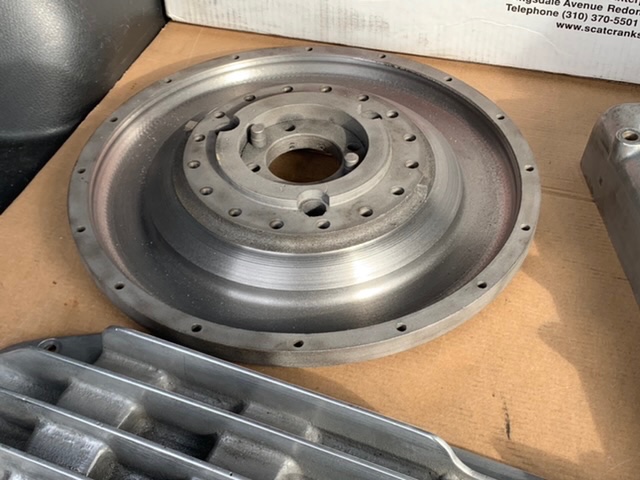

What is the typical weight of a flywheel c/w ring gear, magnets and hardware?
We took about 10 lb out of this one:

Post by DanTreace » Sun Mar 29, 2020 9:59 am
Approx. 52 lbs. —- flywheel, ring gear, and magnets assembled.

A 20% mass reduction = x% reduction in strength? Have you calculated the value for x? Drive careful.

Any reduction in strength would depend entirely on where the material was removed. Then factor in what is expected of the flywheel - I doubt the user expects to install the normal Model T magnets, with no magnets, the flywheel needs to support the ring gear and forces from the starter as well as provide the balancing effect of the flywheel. 10 pound reduction should be no problem if carefully done.

Turns out this user IS going to install normal Model T Magnets. I love my coils. Having said that, I'm optimistic the missing material won't be fatal.
