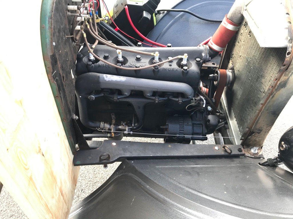

My 23 TT is missing the carb adjustment rod. I've seen various setups, some with linkage and others just with a rod with a two pronged end. What do I need and where does it come through the firewall and what is on the other end of it?

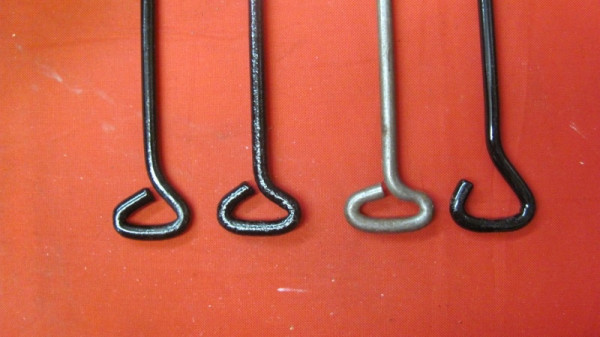

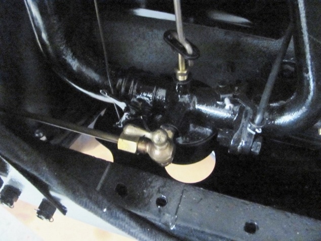

To keep it stock '23, you first need to rivet the bell-crank on the firewall so you can fit the short choke rod with knob into the dash from the bell crank.
A wire you make from welding rod goes from the bell crank to the carb choke butterfly lever.
Then you need the long adj. rod, fork end to the carb adj needle valve top, then the loop-end extends into the slot of the firewall, and extends a short way up under the dash. That is if you have a body with dashboard to fit to the firewall.
The adj. forks are made reproduction but are too big at the loop end, so you have to reshape to twist it vertical and then vertical down as you slip it into the narrow slot in the firewall. See differences here:
One on the far right is too large loop reproduction.

I'm not exactly sure what a bell crank is?
So the curved loop of the adjustment rod goes through the firewall and that is what you turn? I really don't have a dash, just the firewall. I've seen pictures of round knobs on the dash but not the curved loop.
The only choke I have is the rod that goes though the radiator that I pull to prime the motor, is there supposed to be something else?

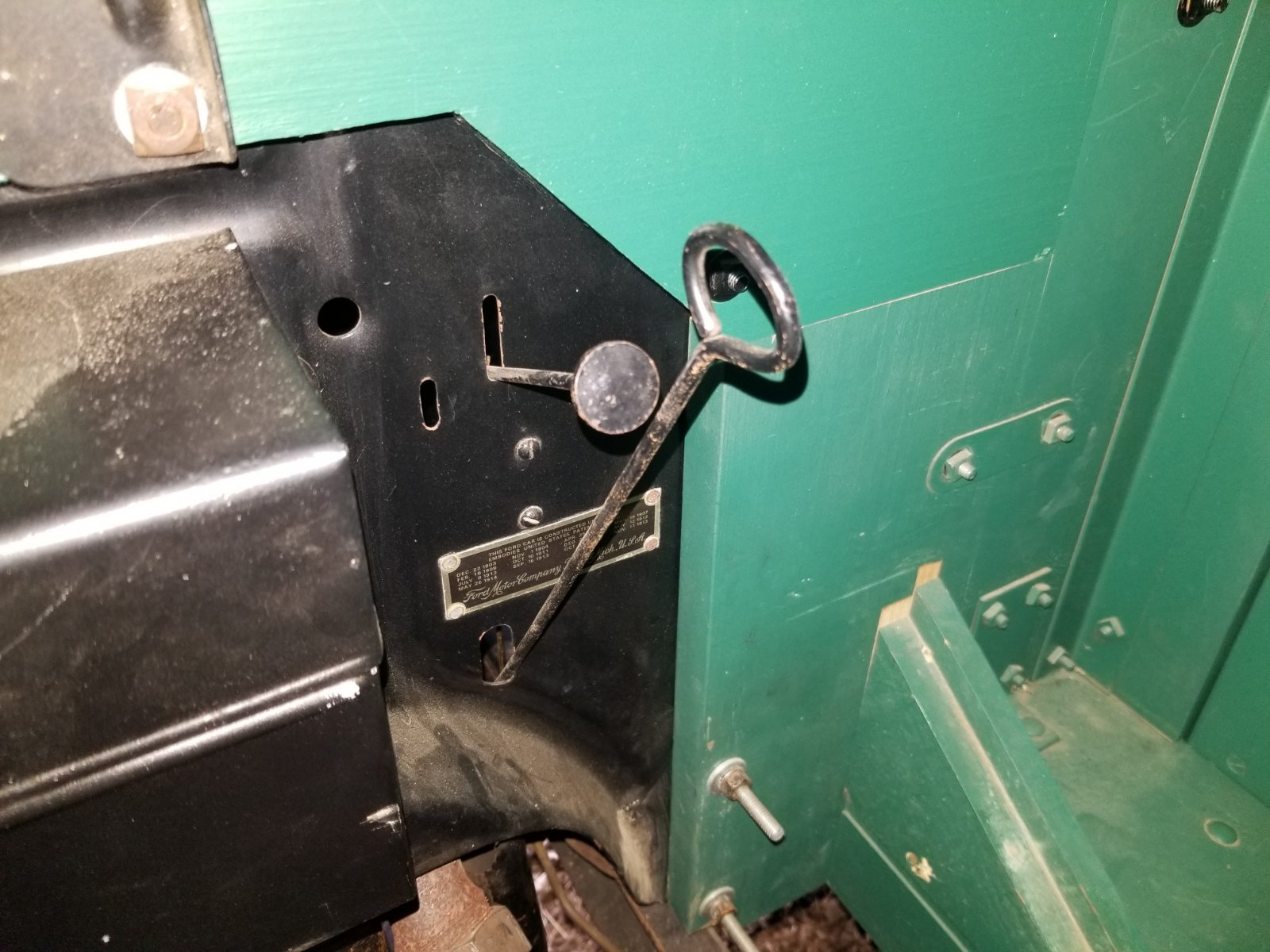

- Posts: 4089
Re: NH carb adjustmet rod

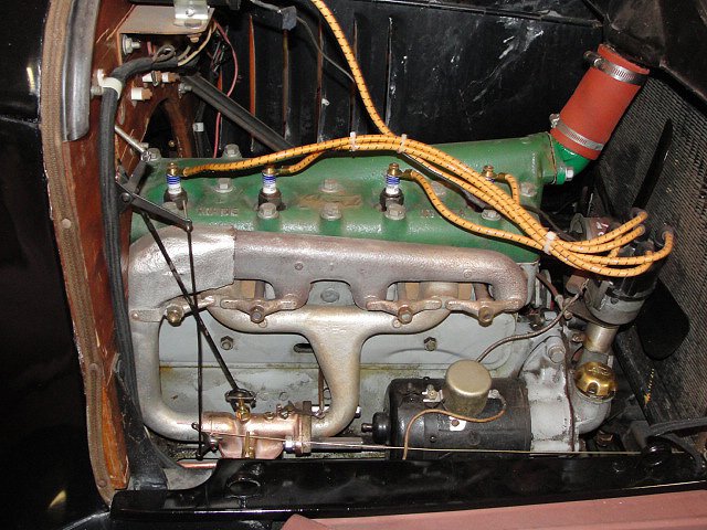

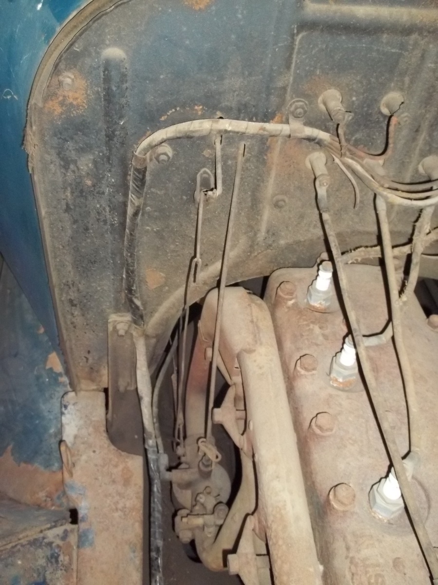

Bell crank is the bracket with two arm on it. The arms pivot up and down.
See bellcranks on left side of firewall.
The wire to the radiator is one half of the choke system. The other haft lets you sit in the seat behind the wheel and choke the engine when using the starter motor. Add that half with a wire to the bell crank, from the lower part of the NH carb choke lever, it has two holes for that reason, that lever for the carb is also a bellcrank in action to move the butterfly.
With no dash panel, no worries, just place the rods thru the firewall and use the knob and carb adj. rods that poke up. You may like to shorten each so that they don't protrude so high in the air.

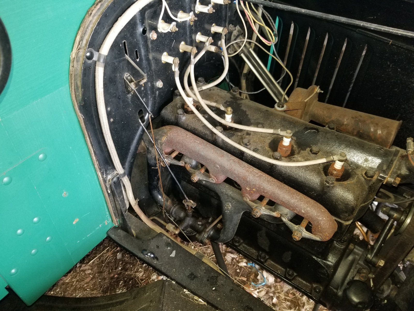

- Posts: 4089

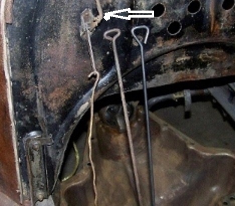

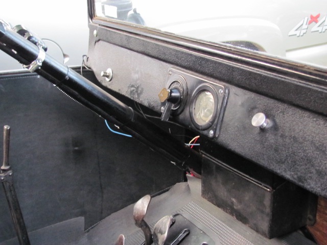

Here is a close up of a TT with no dash panel, but running with choke rod in driver's reach and carb adj. rod in driver's reach.
Photo is blown up so detail isn't there but you can see the owner used the bell crank, added pull wires, and used the choke knob rod and carb adj. rod just extending thru the firewall.
Arrow trying to point out the slot to fit the yoke or loop end of the carb adj. rod. The bell crank has its choke rod going thru the firewall the other firewall slot. That rod is short with an alum knob on the other end. The rod is held with a cotter pin to the bellcrank, as the rod has an L end there.
- Posts: 4089

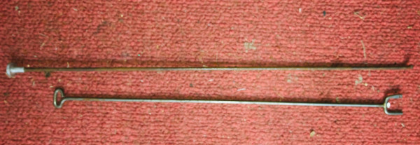

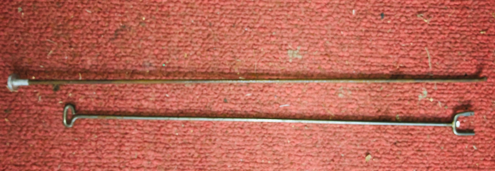

Photo shows the two parts you will need, other than the bell crank and some wire, coat hanger wire can do, but weakens quick when you bend the ends.
Choke rod with alum knob, it is very long to reach the dashboard, but easy to shorten, by cutting off. The repro is easy to work with, the alum knob is held on with tiny cotter pin, remove it, saw off the rod to length you need, then reinstall the knob!
The long looking loop with fork end is the carb adj. rod, you will use it the stock length. It extends just above the firewall.
Here is the loop end of the carb adj. rod extending under the dash. You can see it sticking out of the firewall in the slot. Note the rod beside it, that is the choke rod, it is going to the top of the dash, but you would just terminate it to be just above the loop of the carb adj. rod. That way you have clearance with your fingers and thumb to turn the loop. Yes, you turn the loop clockwise to lean, and couterclockwise to rich the carb. You will pull on the choke rod to choke the carb. Be sure your NH carb has a good return spring at the choke lever, that is very important for the action to work.

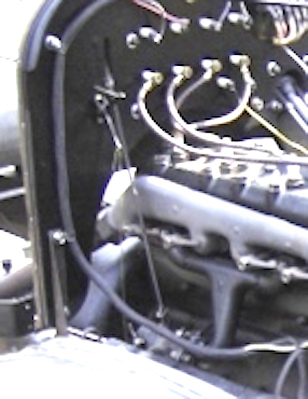

Here is my 23 TT. Not sure its 100% correct.

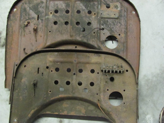

The bell crank turns pulling into lifting for the choke. You could shorten or make your own like the one Dallas shows. The connection between the BC and carburetor, the lower hole on the choke lever is used for pulling from the inside, the upper for wire thru the radiator for hand cranking. I think it would be too steep of an angle to try and use without the bell crank.

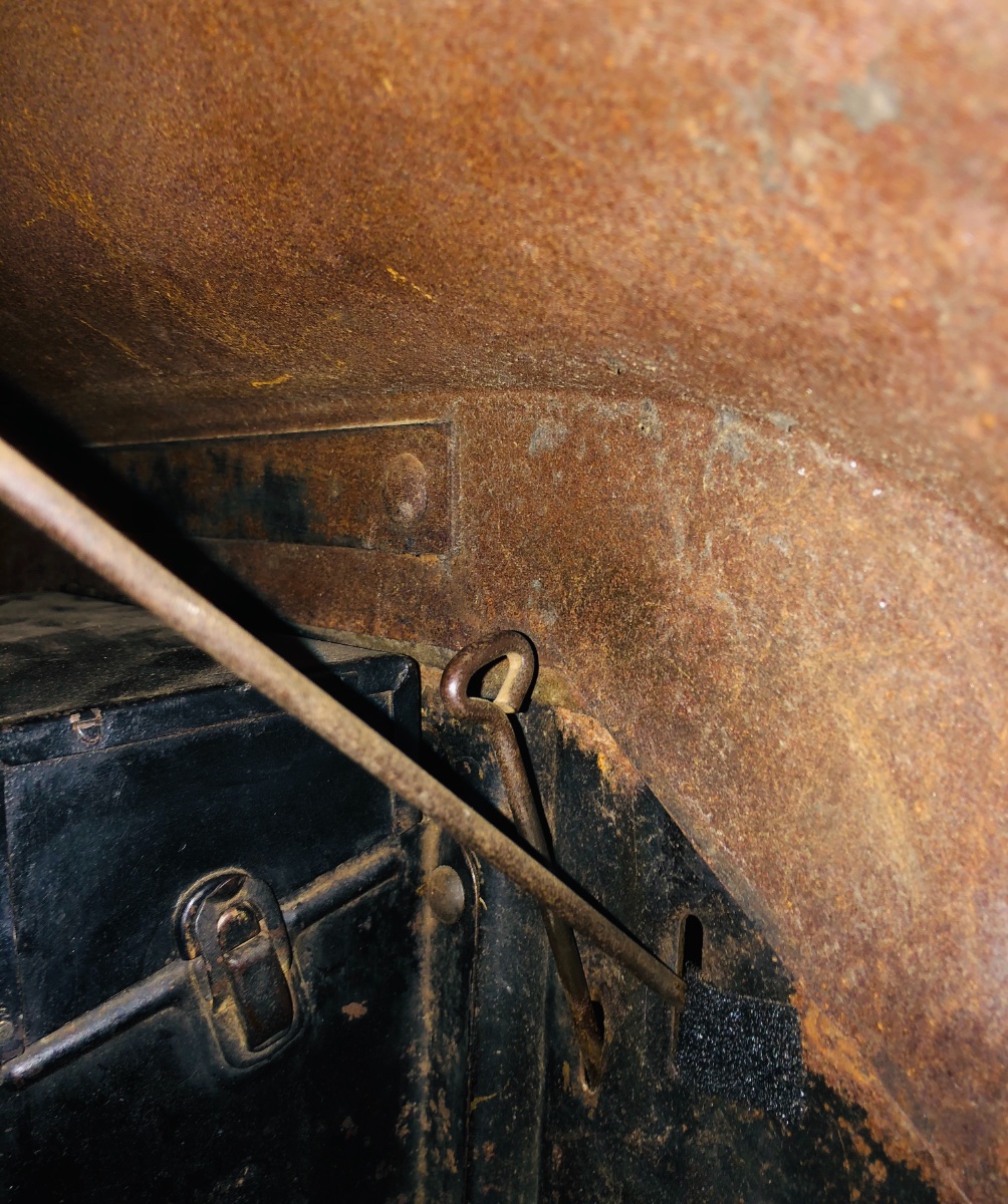

Clear side view. It's the "L" shaped metal on the firewall which, through pivoting, changes a 45 degree pull at the dash, to a vertical pull in the engine compartment as well as slightly increasing the choke lever lifting movement relative to the "pull" movement
Someone will have a very rusty firewall which they will sell you the bell crank off of...just ask in the want ads...
