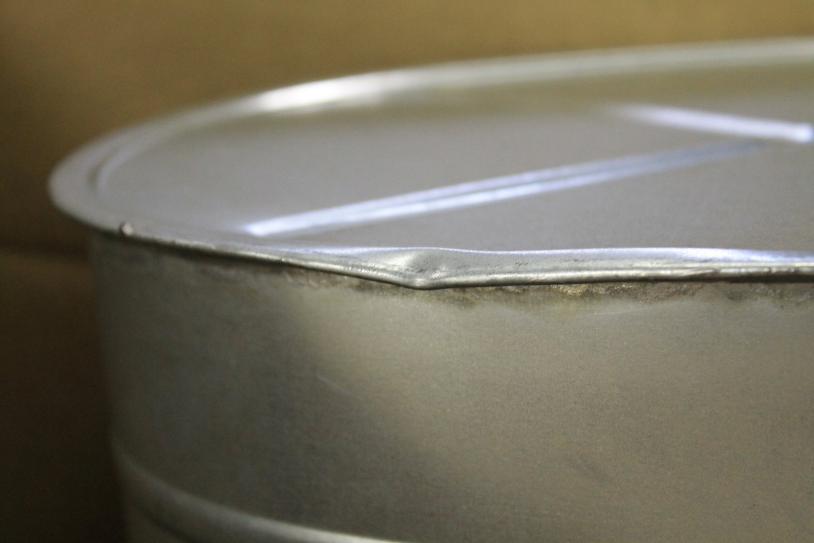

I just got the very limited hard to get reproduction oval gas tank for my 25 TT from Macs / Ecklers - Good news right? No came with a dent in the joint area. What a deflating and infuriating experience. Now I got to ship it back. I wish they would have packaged it better.

If it turns out to be a runaround the best out come could be to straighten the bent seam, solder and repaint it. Now would be the time to fix it and it be done with it. Sometimes you have to do what you have to do.

I would spray some soap suds on it and give the tank a little puff of air with something in the bottom output and a rag around the air nozzle on top. UNplug the compressor and let it run down to a lower pressure like 35 psi so it wont hurt anything.If it don't leak your best bet would probably be live with the ding annoying as it is.

I called Macs /Ecklers and have gotten a return slip to send it back. It is just so aggravating. FedEx was the shipper.
