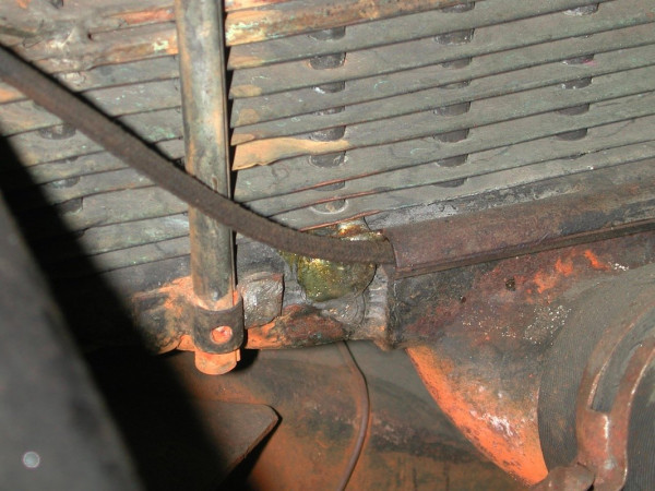

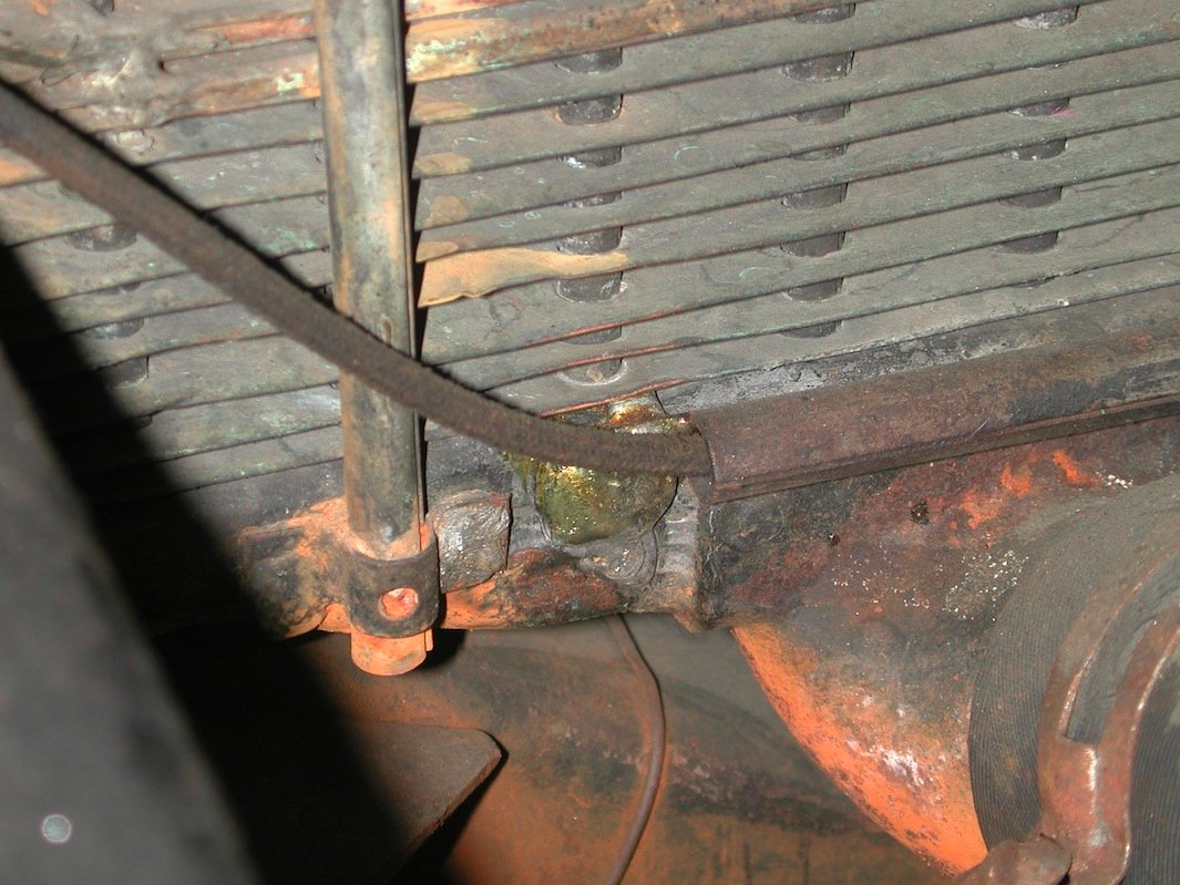

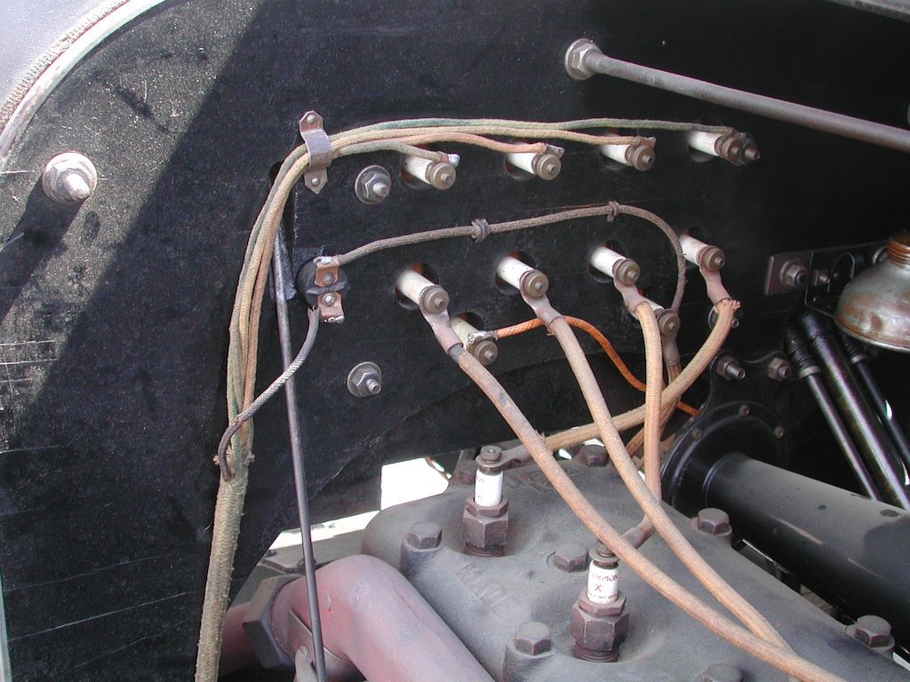

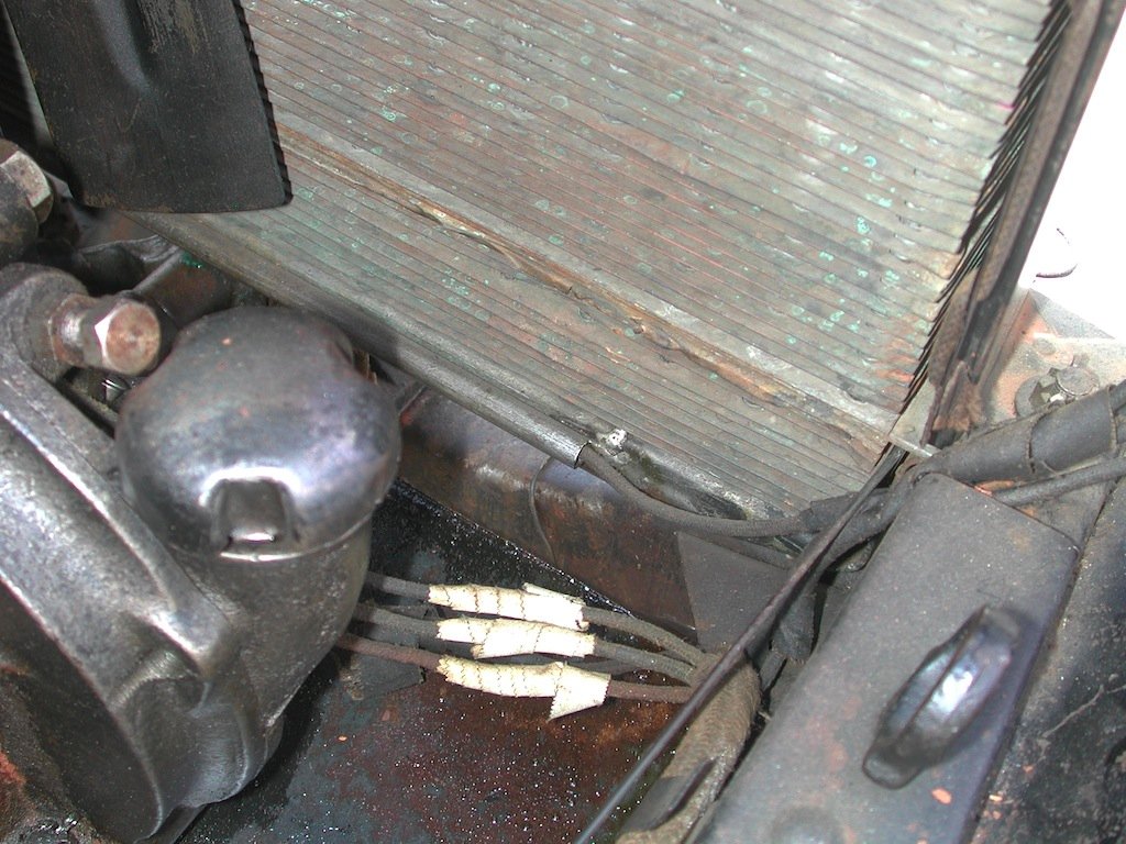

Here are photos of the 1917 "Rip Van Winkle" Ford (June 1917 serial number).
Note the two staples on the firewall for the light switch wire. We have also installed those on our 1917 touring since I took the photos. My unrestored 1917 roadster is missing the staples but the evidence of their existence can be seen on the firewall.
Wires go under the choke wire.
Note the ground wire for the headlights is soldered to the radiator fins. Don't know if this was done on the brass radiator cars - you'd have to talk to someone that has researched it.
