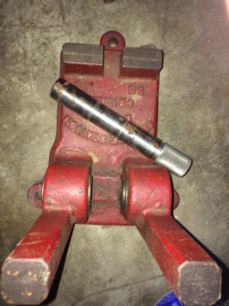

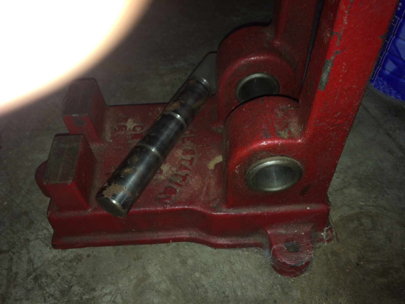

There are tools for that, I apologize for not having the numbers, but someone surely will.
I sold a jig to Joe A. for checking the rods and I believe he also got a long bar with a fork in it for bending the rod...
This is the fixture...
Posts: 7167
Re: How to save a Rod
Post by Allan » Tue Feb 05, 2019 10:32 pm
A good machine shop should have a jig to check bend and twist in rods. They should also have a rod vice for straightening any bends. It is a job for someone with special tools and the know how to use them.

Pops, you can't align a model T rod on equipment designed for newer rods because of the small diameter of the model T crank journal. If you think your rod is OK then straighten it as needed. I will do it for you on our KRW alignment machine at no cost if you want to send it to me and pay for return shipping.
