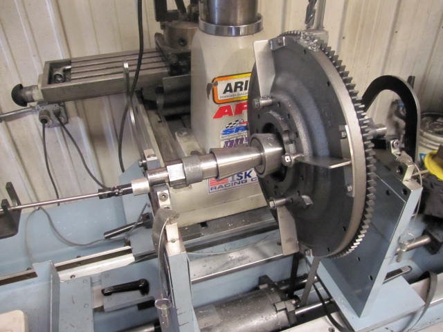

You don't have to physically machine the flywheel to remove weight. if you're going with a distributor then you can remove the magnets and substitute paddles to keep the oil lubricating engine. Naturally flywheel would need to be balanced in this configuration to make it smooth.Rich Huggins wrote: ↑Thu Apr 02, 2020 7:34 amWant to lighten flywheel, no mag pro an con. comets needed engine will rev faster reach higher rpm and will run smoother any one in az that can machine the flywheel
