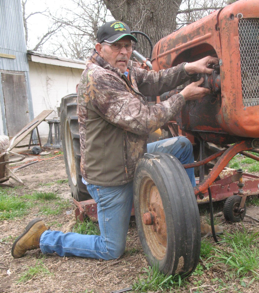

Putting the mag back on.

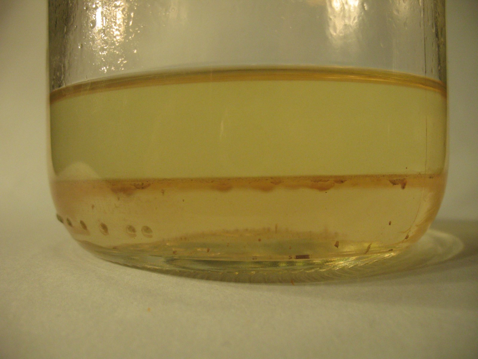

It doesn't look like a lot in the bottom of this quart jar, but it was enough water to kill that tractor dead.

Yep! I have seen that on a few machines that have sat over the winter. The bad thing is that water can rust the heck out of metal fuel tanks. I even add Stabil 360 to non-oxygenized fuel if it sits for more than a month or so.

The water in that gas is the result of heating and cooling cycles, humidity, and condensation in an open fuel system over a moderately long period of time. It likely isn’t because of a “quality problem” with the fuel itself.

A lot of atmospheric moisture can condense on the interior walls of a partly empty gas tank, and then trickle down to the bottom of the system. Back when I used to play with airplanes, we'd always fill the tank when we were through flying for the day, to minimize where water could condense. And before the first flight of the day, we'd drain a bit of fuel from quick-drain valves at the bottom of the lines, just to get rid of any water. It's amazing how often there was some. I know a guy who had engine failure just after take-off in a Cessna 182; he landed in trees and wasn't hurt, but the plane was scrap. The investigation showed water in the carburetor. And aircraft fuel doesn't have ethanol.

Adam is correct. Let it lay for months and that's the result.

But that's not what happened here. Part of what Dieter did when he worked on the tractor last month was completely drain the tank, dry it out, clear the line, put on a fresh carburetor, and put in fresh gas. What he didn't do was fill it up to the top. I think Gil's explanation is probably correct.

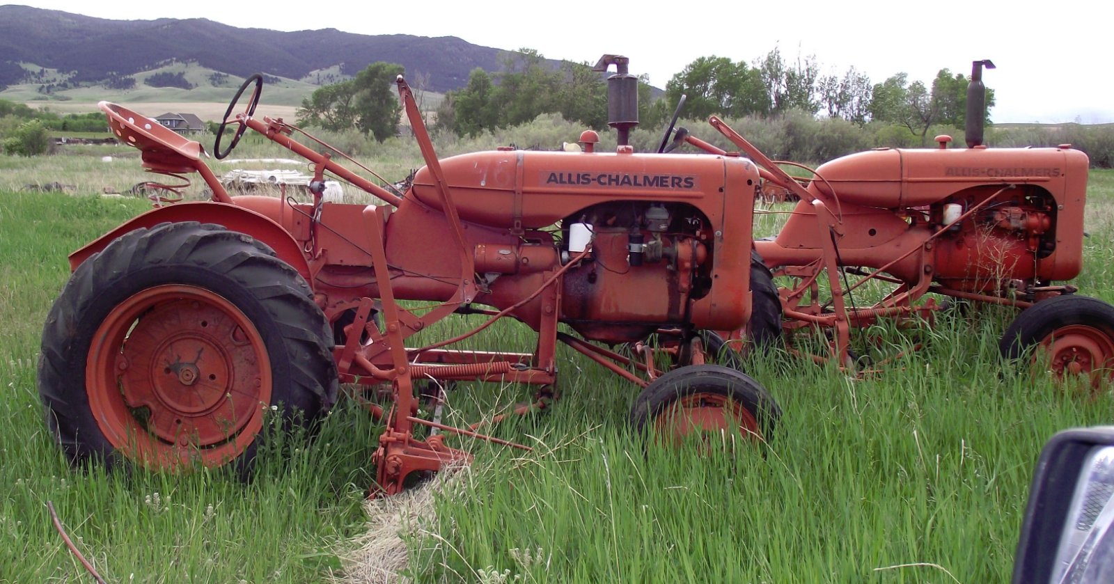

I think this is thread drift but here are my two Allis B's. As you can see, one has a battery, starter and generator and one doesn't.
