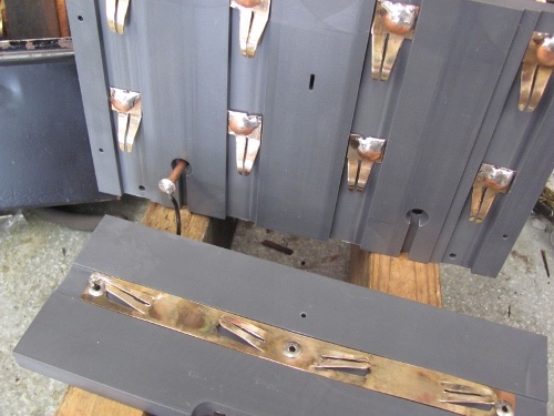

I bought this kit about 3 years ago and am just getting around to installing. When trying to install the contact screw for the Battery and mag connection I realized that the contact screw heads were to big to fit in the recess on the back panel. The screws for the 8 other contacts work fine. I might be doing something wrong. I am installing this on my 1919 touring, non starter car. It is non electric but plan to use a battery for starting and run on the mag. I am doing a complete Frame up restoration. I will have the wood firewall with the switch mounted on the coil box. See attached foto.

The photo in the link shows a circular counterbore recess at the end of the channel to accommodate the carriage bolt head, your kit may not have that feature. I did a '26 kit some time back and everything fit perfectly, you may need to make a small modification with a wood chisel. Good Luck, stay safe, jb

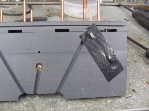

Put the kit in a later box without the switch on the box, but kit is the same.
The single terminal for the box w/o switch, and for later cars only used one of the terminals, for the mag. So there remains an empty hole.
The brass carriage bolt fit fine for me. Also notched or channeled that carriage bolt head to make recess for wire, then soldered it to the bolt.
Only used the single wire channel for the single magneto post input. Tape cover the junction for protection.

James, my kit does indeed have the circular counterbore, it's just that the counterbore is not quite large enough for the terminal screw head. I guess I can put it on the drill press and enlarge the counterbore so the screw head will fit.
