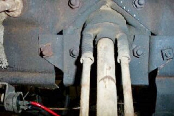

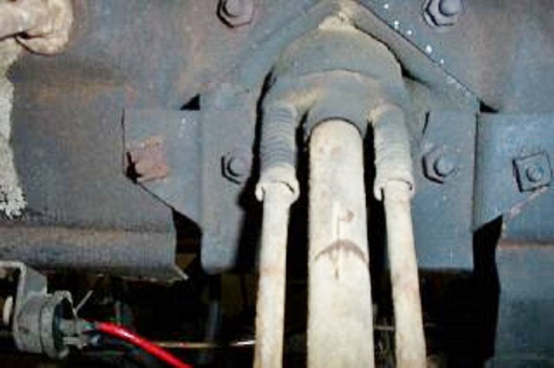

The steering frame bracket for the '26-'27 Fordor and the sold car Chassis only is angled different and will have casting number in the part T-933.
The normal bracket for the '26-'27 T's will have casting number T-932C The odd one out is for the TT, that bracket will have casting number TT-932.

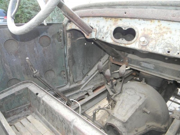

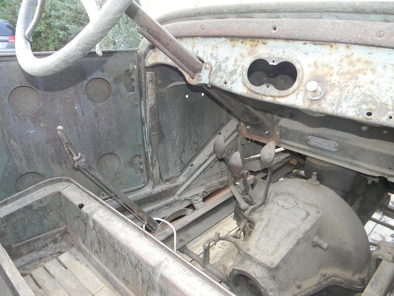

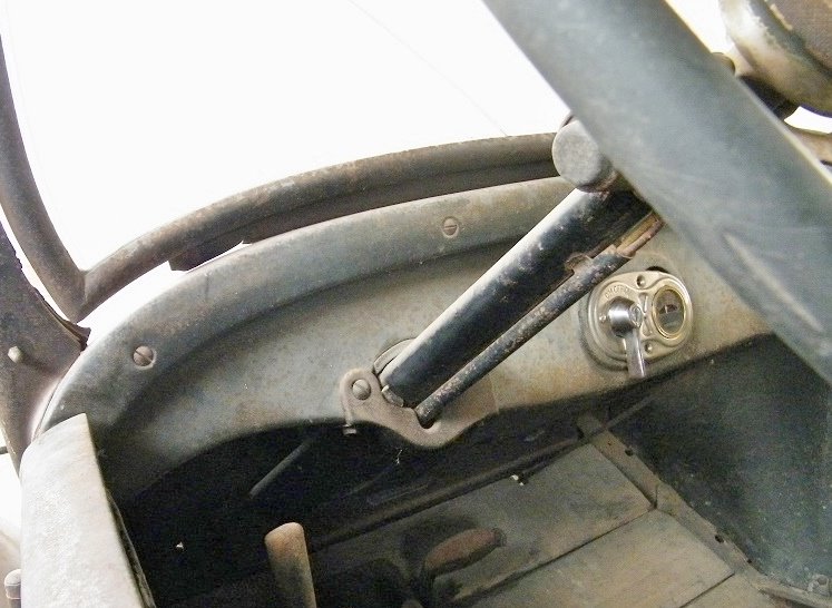

Photos show '26-'27 open car dash to column. Note the very small rubber like anti-squeak on the column at the dash bracket.
And the open car cowl/firewall bracket used for the square plate on the base of the '26-'27 steering column.

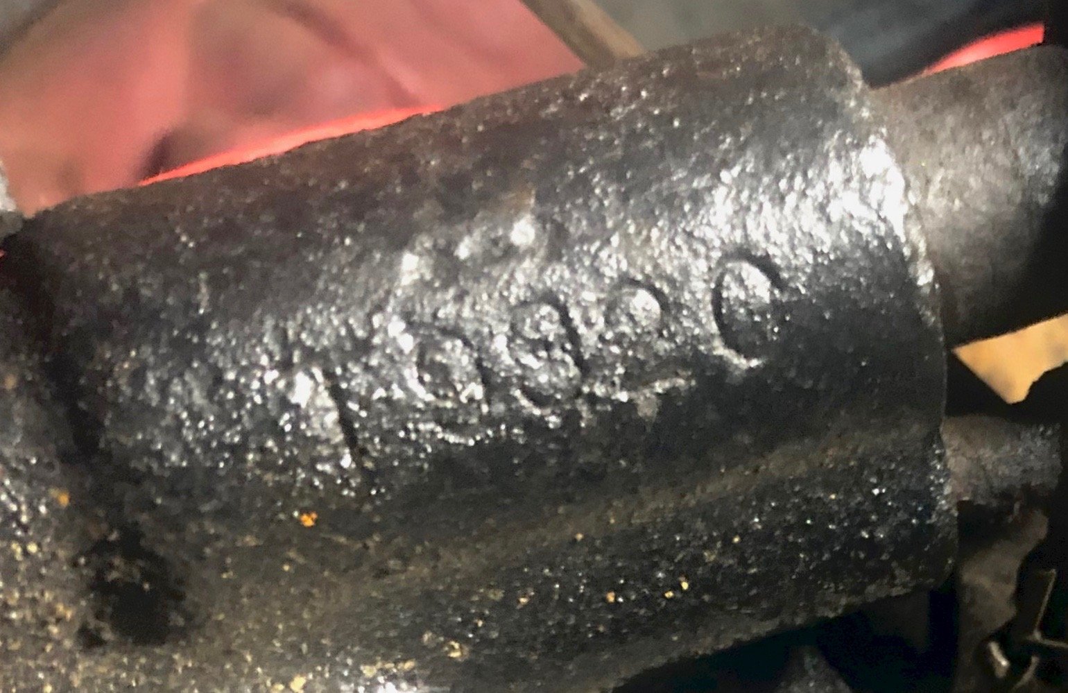

Re: Sagging Steering Column

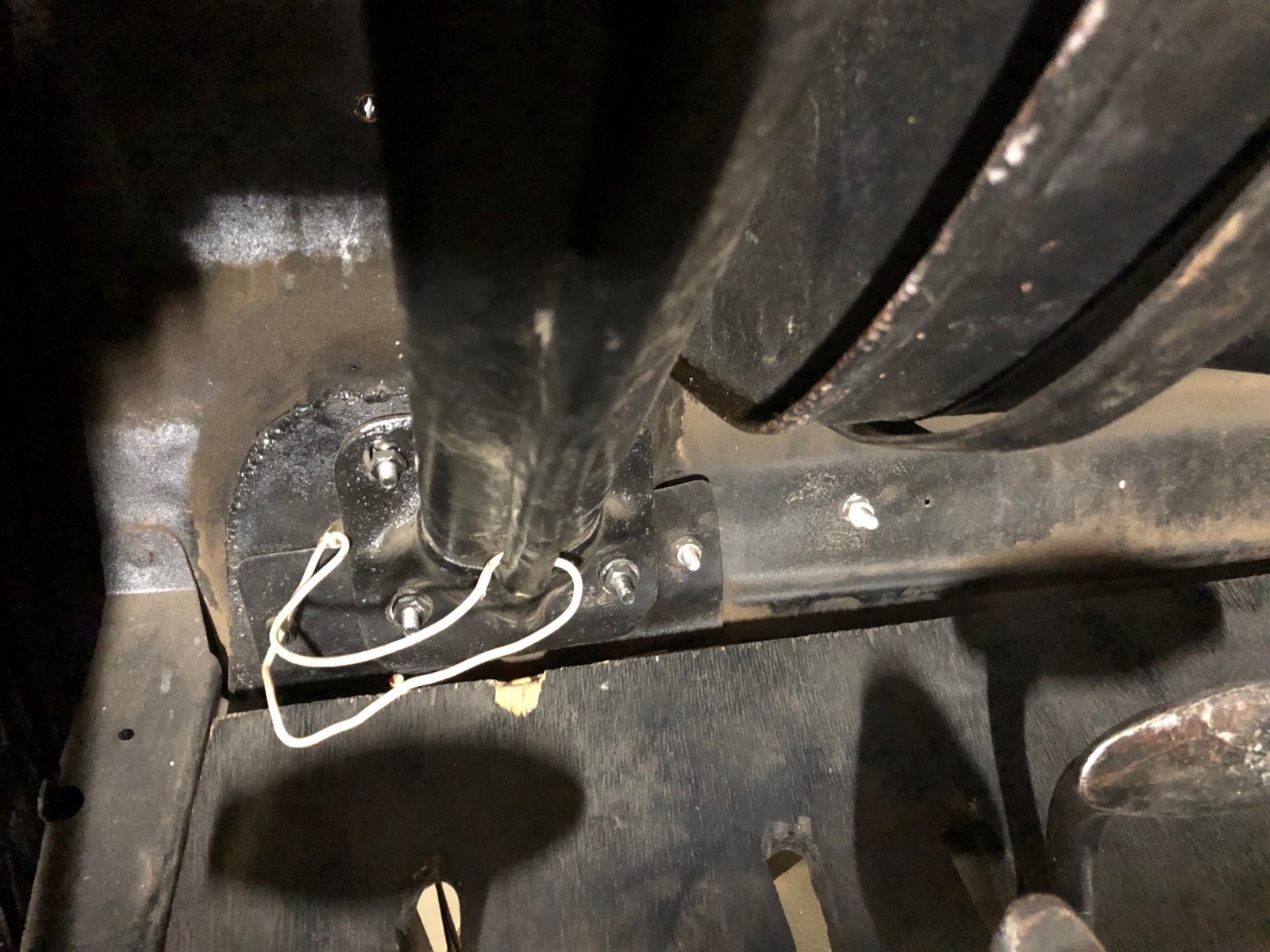

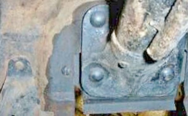

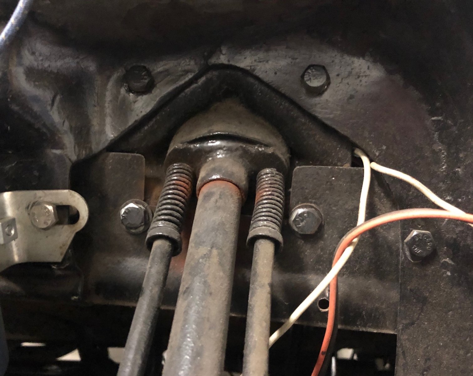

Thanks for the pictures and ideas. I checked the casting number for the lower bracket. I would have said it was "T-982C" but since that isn't an option I think it is the correct T-932C. The steering column is the correct square bracket one, but I'm not so sure about the firewall mount and bracket. It look like there may be some "modifications" down there. I've attached photos. I'll poke around some more with fresh eyes in the morning.

I noticed that the lower plate under the column is on the wrong side and looks like someone has done some welding around the mounting area. If the bracket is correct, that mounting area would be suspect. I would suggest at this point to unbolt it from the firewall, pull up into place at the dash and see were everything in the flange area lines up. You may need to do some tweaking in that area. Then when done put the plate on the correct side. It could be the plate is what is forcing it down.
Mark
Mark

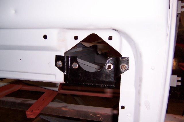

Agree, the firewall is modified and welding in patch may be in wrong spot. The plate holding the steering column is incorrect as no ledge on the compartment side to fit the floorboard upper edge. Factory plate, p/n 3515 (26-27) has flange to mimic the firewall flange to support that upper floorboard.
Original, unmolested '26 runabout firewall and steering column mounting.

There's only one place for those top two bolts to go and they're in the right place. The only thing that will alter the angle of the steering column is a mislocation of the body on the frame which is unlikely, or an incorrect offset in the made-up firewall plate that the two lower bolts fasten to.
Support the steering wheel so the whole thing doesn't get stressed during the following: I'd unbolt the T932-C casting from the frame, then on firewall, slightly loosen top bolts and really loosen bottom bolts...will the column now lift up and fit the dash? It should. Will the T932-C casting refit to the frame? It should. If you're restoring this car, then fit up the firewall correctly. If not, make two spacers to place between the modified bottom plate and the backside of the bottom two holes on steering flange. Tighten down and move on.

Thanks guys, I loosened everything as Scott suggested. The holes in the firewall "patch" seem to leave enough play that I could get the dashboard bracket on with a little lifting of the steering column, which repositioned the square steering column flange a hair but still left the bolts lined up. Nothing seemed too far out of place except the homemade lower firewall bracket, so I tightened everything else up. I see reproduction lower brackets are $30 at Langs, so I'll probably get one of those next time I make an order and install it like the one in Dan's photos
