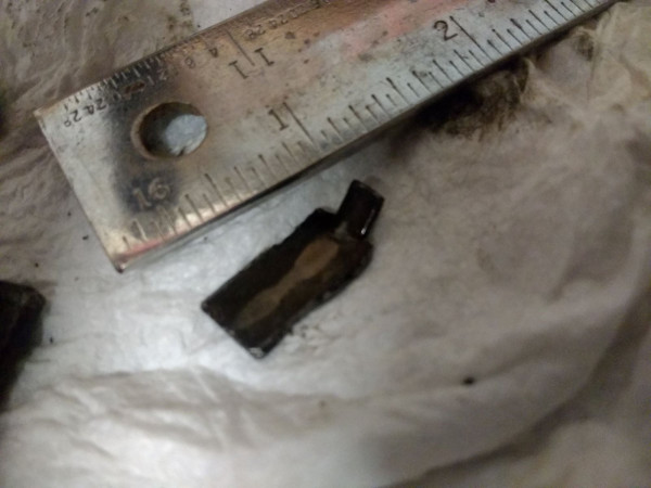

New to the forum but have been reading it since acquiring a 26 runabout last summer (2019). First thing I did when I got it home was drain the oil. A brass screw head came out with the oil. Not knowing anything yet, I assumed it was just a piece left over from previous repairs. Went about getting it up and running and drove it around a bit. One day had it idling in the shop and I heard a couple clunking sounds coming from the engine/transmission area. Immediately shut it down and started researching the forum. Have not ran it since. So I am thinking that the screw head is from a magnet retainer after doing a bunch of reading here. I had tested the magneto before the clunking episode and it is not working. So I guess my question for the board is; what is my best plan of action? I am not concerned about being able to use the mag. I am fine running on batt for what I plan to do. I know I have to pull at least the hogshead, but could I remove all the magnets at that point?

Thanks. I guess my question is; assuming a keeper plate and maybe a magnet has fallen off, can I make this thing safe to drive on batt by removing the loose parts? Do I need to remove the rest of the plates and magnets for balance issues? Can I do all of that with just hogshead removed?
- Posts: 7349
Re: Newbie question about magneto
...can I make this thing safe to drive on batt by removing the loose parts?
The short answer is no. The longer answer is maybe, and maybe not. The only damage may be the broken screw and the loose keeper, in which case you might get away with running it for awhile. But you are gambling with major disaster (big damage, big expense). I would pull the engine, stand it nose down, pull the transmission, and fix whatever needs fixing in the mag and trans. You can recharge the magnets and have a good working magneto. You will spend some money, but it will probably be a lot cheaper than doing nothing.

Thanks Jim for your thoughtful response. No intention of running it as is, I've read enough posts to know better. I'm learning as I go. I have the manual and have no problem pulling the power plant. Just wanted to see what my options were.

See the brass screw holding on the plate and the Magnet? That's what you found. I bet the little plate and the spool under it are still in the pan.
You need to pull the motor and pull it apart. Hopefully you don't find what I did. Everything had cracks in it. Sadly you probably will. Unless you are rebuilding the whole thing you will have to assume some risk in doing only part of a rebuild. For me I decided to rebuild the whole transmission and assume risk on the motor. I will check everything as I put it together. In your case you need to see if it did more damage. Remember these car should be considered a fun hobby and not an investment (with the exception of some of the expensive brass cars). Normally you will never get the money and time you put in to them. That's ok. When you bought the car you bought an experience that most people will never know. Don't get discouraged. Keep asking questions here, keep learning here, keep reading here, and have fun. Good luck you can do this.

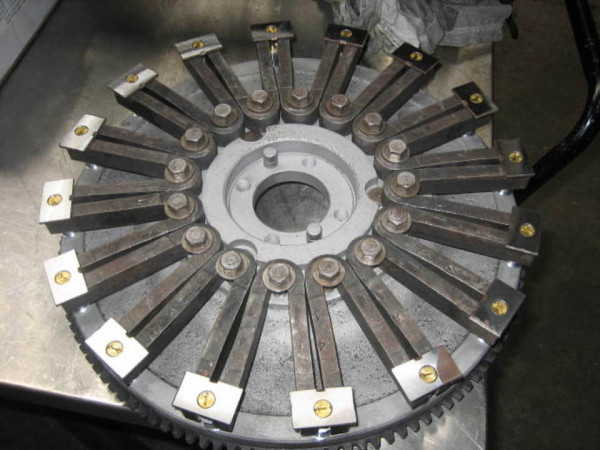

I agree with the posts on pulling the engine and turning it on the nose down and remove the transmission and magneto. I will add a few other ideas since it is much easier to rebuild the engine and transmission when it is out than to fix the magneto and then later have to pull it out again to fix something else. Buy the service manual, the books by the club on Engine, Transmission, Electrical system. Read those books which give very good do it yourself instructions.
Before you pull the engine, if it will still turn with the starter or crank, without actually starting the engine, do a compression check. All cylinders should read approximately the same PSI which would be about 45 or 50 for a stock engine. The reading might be a little less at higher altitudes. If the compression is low, it might be time to do some engine work too. Then, when you get the transmission out, check out the gears and bushings in the transmission and repair if needed. Also check the starter ring gear on the flywheel. If the teeth are badly worn it is not time to replace that gear too. While you have it apart, check the fit of the connecting rod bearings and look at the babbit. Especially check the Upper part in the rod. Adjust the clearance to 0.0015 inch. This can be done by removing shims or filing down the cap.
Then work to fix the magneto. At this point you can install a rebuilt magneto coil ring and check all the magnets for cracks and replace any which are cracked. Note, the magnets are opposite polarity alternately around the flywheel So be sure to use the correct magnet. They can often be found used at swap meets or from other members. Recharge the magnets and install. Or you could buy a set which has already been checked and re-charged from one of the parts vendors. Careful attention to height above flywheel of all magnets should be same and clearance from the magneto coil ring should be no less than 25 thousandths.
The book on Electrical system shows you how to rewind your own magneto coil ring if you wish to do so. I have done three. Two of which I used in my cars successfully and one was auctioned off. Haven't heard a complaint about that one.

I have the motor out and the trans off. 3 magnet keeper plates came off and were being thrown about. Not seeing any damage other than to the plates themselves. So, I plan to get a new coil ring. What is the best plan of action for the magnets? I don't see any cracks on initial inspection. They have very little magnetism at the moment. I found a mystery item stuck to one of the magnets. Can anyone identify it? See picture.

If you are wondering what that last piece is, it is the same thing as was found here: viewtopic.php?f=2&t=12078&p=90974&hilit=blue#p90974
You have plenty of trouble on your hands, and will probably be replacing the magneto coil ring (cheap right now) and doing a flywheel teardown and rebuild as well as replacing 1 or more parts inside your brake drum.

Yes, you need all new brass screws. You're going to remove all the old ones when you take the magnets off the flywheel to charge them individually and be sure none are broken or cracked. You can build your own charger (http://dauntlessgeezer.com/DG88.html) but I would take Andy up on his offer so you can see how an experienced T guy does it.

Since the engine is out, it is very easy and effective to charge the magnets using (3) 12 volt batteries (36 volts). I performed this procedure 10 years ago and documented it in the following thread posted on the forum in 2010. My magneto is still running strong so, as far as I’m concerned, this procedure has been proven to work. Some say that this procedure will work with less voltage or fewer batteries or a welder. I cannot say whether these methods work or not. All I can say is the 36 volt battery method detailed in the below thread, works like a charm and I would recommend not deviating from what absolutely works. Jim Patrick

Ryan, I had a screw lose its head and liberate a keeper half way across the Nullarbor Plain, some hundreds of miles into a few thousand mile trip. I killed the engine immediately I heard the clinking. The trouble trailer got us to our overnight stop and we diagnosed the exact problem by removing the starter motor so we could see inside. The only way to fix it was to pull the motor and replace the screw and plate. I got away with just doing that much work on a road trip, and it has performed well since.
In your situation you have a distinct advantage. Having gotten that far into the job, I would advise the following.
You need 16 magnet keepers. Replacements should be originals, as repros are of dubious quality.
You need 16 new brass screws. If one broke, others will too. They look like they crystalise.
You might as well check that the starter ring gear is good while you have it all apart.
You need 16 sound magnets. Give yours a good rap on a vice/anvil, holding them at the V end. You will break any that are unsound.Check out the breaks.
You need 16 new alloy spacers. The old ones are likely cracked in places and will not stand being reworked when setting the magnet heights.
Then you are set for a rebuild that should give no further trouble. It is silly not to do the whole thing properly once you are this far into the job.
