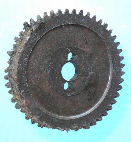

Fiber timing gear doing what fiber timing gears do?

Thanks, Steve. You may be on to something. Since I didn't rebuild the engine, I didn't check the timing gear to see if it was fiber or aluminum. I'll pull the generator to make sure.

If the timing gear was shattered like that, the engine would not run at all because the synchronization of the opening and closing of the valves to the motion of the pistons would be thrown off. Though the steel timing gear is noisier than a fiber gear, I have always preferred steel to the fiber gear for the reason you see in the photo. Jim Patrick

Jim Patrick is correct. A gear that far gone will stop you dead. But if it's going and not yet gone...?

Adam, thanks for weighing in. Best I can tell, the cam gear is fiber so I think the problem lurks in the transmission area.

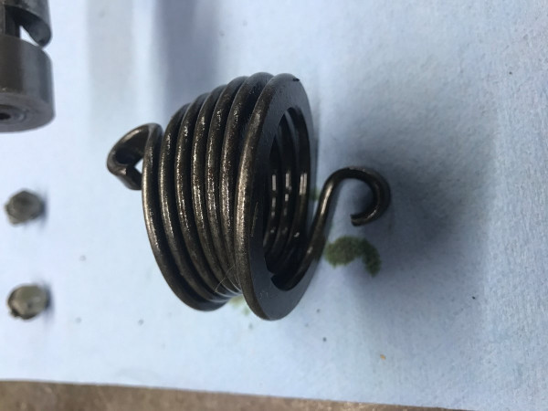

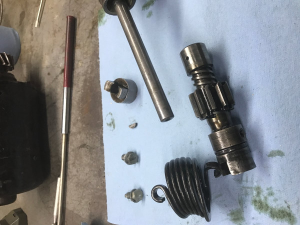

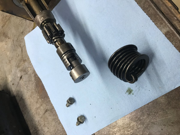

NOISE UPDATE!-----got the starter out last night and found this:
The balance ring counterweight is completely missing from the Bendix gear! Without the ring I suppose it caused the spring to bind up and deform. The distorted spring must be dragging against the flywheel and making that awful sawing noise. I'll know more when I can replace the Bendix and try to run her again.-

Whoa!! Your not seriously think of running that poor engine with loose-missing parts floating around in it, are you? You are sitting on a bomb. Please think of all the could go wrong.

Well me thinks you found some or all your noise. But it not the spring rubbing on the flyweight. It is the missing counter weight being chewed up in side the engine. Don’t start the engine until you find the remains of the counterweights.

Yep, I already probed around inside with a magnet pick-up tool for the missing ring, but came up with nothing. My next move is to buy or borrow a video inspection camera and do some serious snooping. I'm not sure if it's possible for it to come of the end of the starter with the Bendix spring in the way. My first thought was that the previous owner installed it that way not knowing it was missing. We'll see...

did you take the bendix off BEFORE removing the starter?

- Posts: 6777
Re: New engine start-up ----- NOISE!
The distortion of that Bendix spring is likely due to the fact that it is the wrong spring for a T model. Looking at the end of a T Bendix spring, it is coiled anti-clockwise. Yours is wound clockwise.
Thanks Allan, I hadn't noticed being preoccupied with chasing the source of the noise.

Topic author - Posts: 88
- Joined: Mon Jan 07, 2019 8:30 am
- First Name: Mike
- Last Name: Garrett
- * REQUIRED* Type and Year of Model Ts owned: 1926 Speedster, 1924 Touring
- Location: Palmer, Texas
I purchased one of those digital inspection cameras over the weekend with the long goose-neck probe and, going in from the starter opening, snooped around; got a good look at the oil baffle above the drain plug and as much of the oil pan area as I could get to and found no sign of any broken pieces of the balance ring. (Confession: since I installed this engine in the frame about 2 years ago and the starter came with the car, I must have absentmindedly installed the starter and bendix without noticing any problems with the missing balance ring - so bad on me!) On that note, I also want to thank Alan from Down Under for correctly pointing out that the spring on the bendix was incorrect: wound clockwise instead of counter clockwise - never knew there was a difference!
The bottom line:
Installed the starter with the correct bendix & spring and, voila! NO MORE NOISE! The engine starts and runs great. Just have a few oil leaks to correct and we should be ready for a shakedown run.
