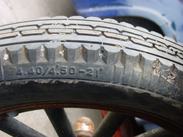

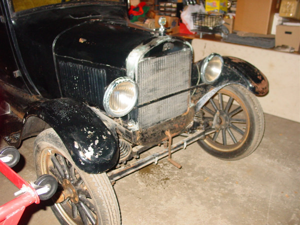

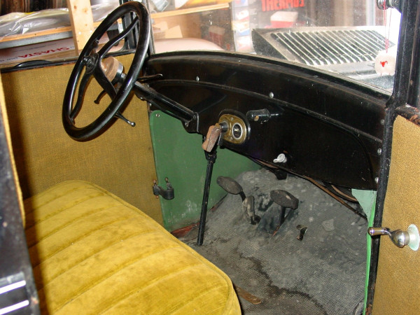

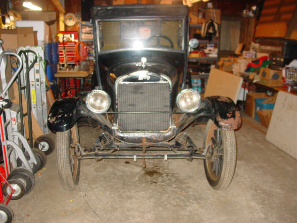

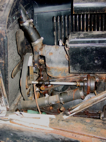

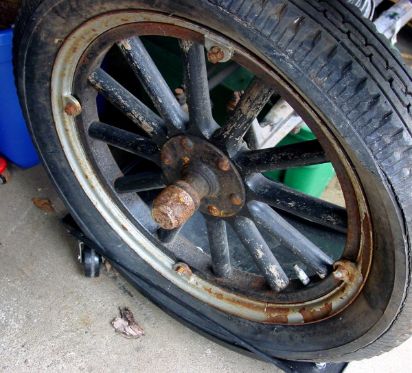

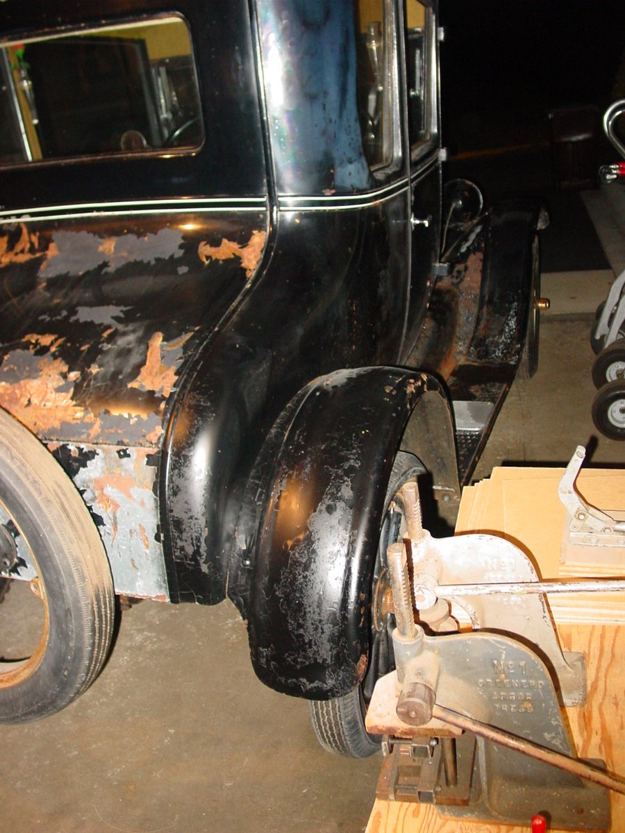

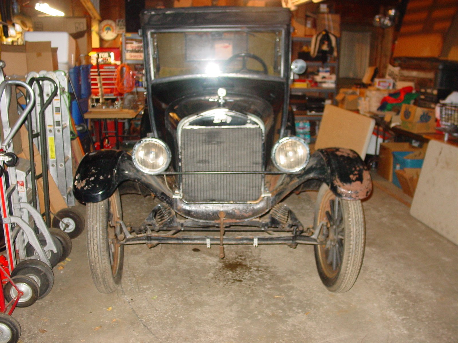

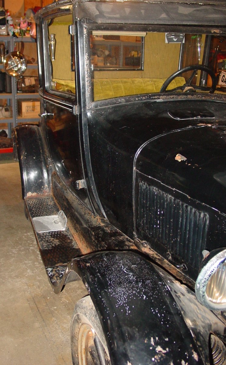

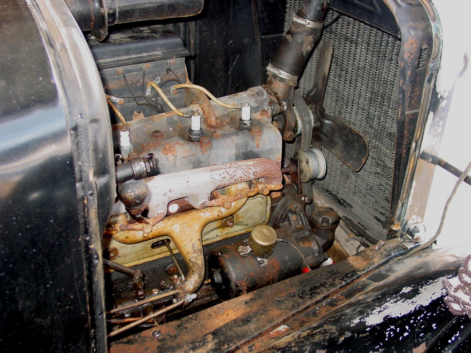

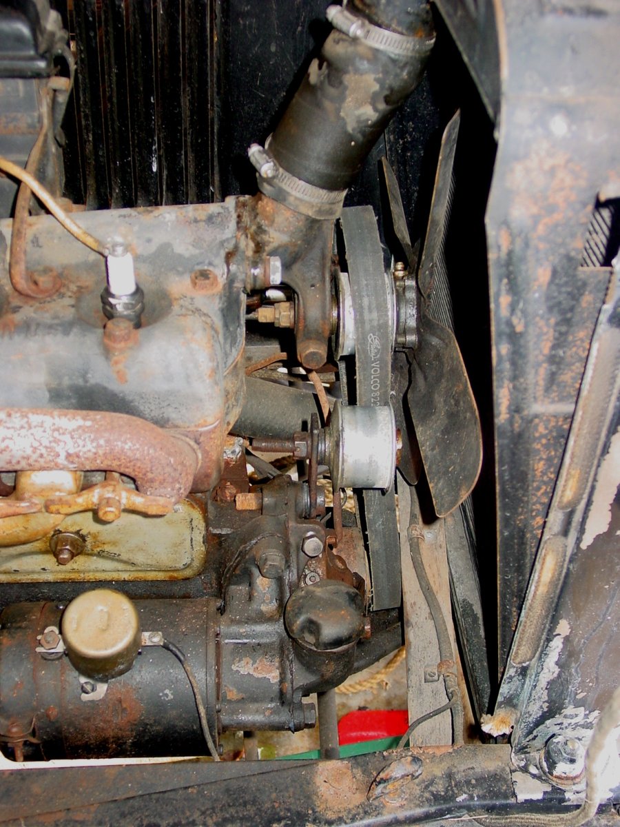

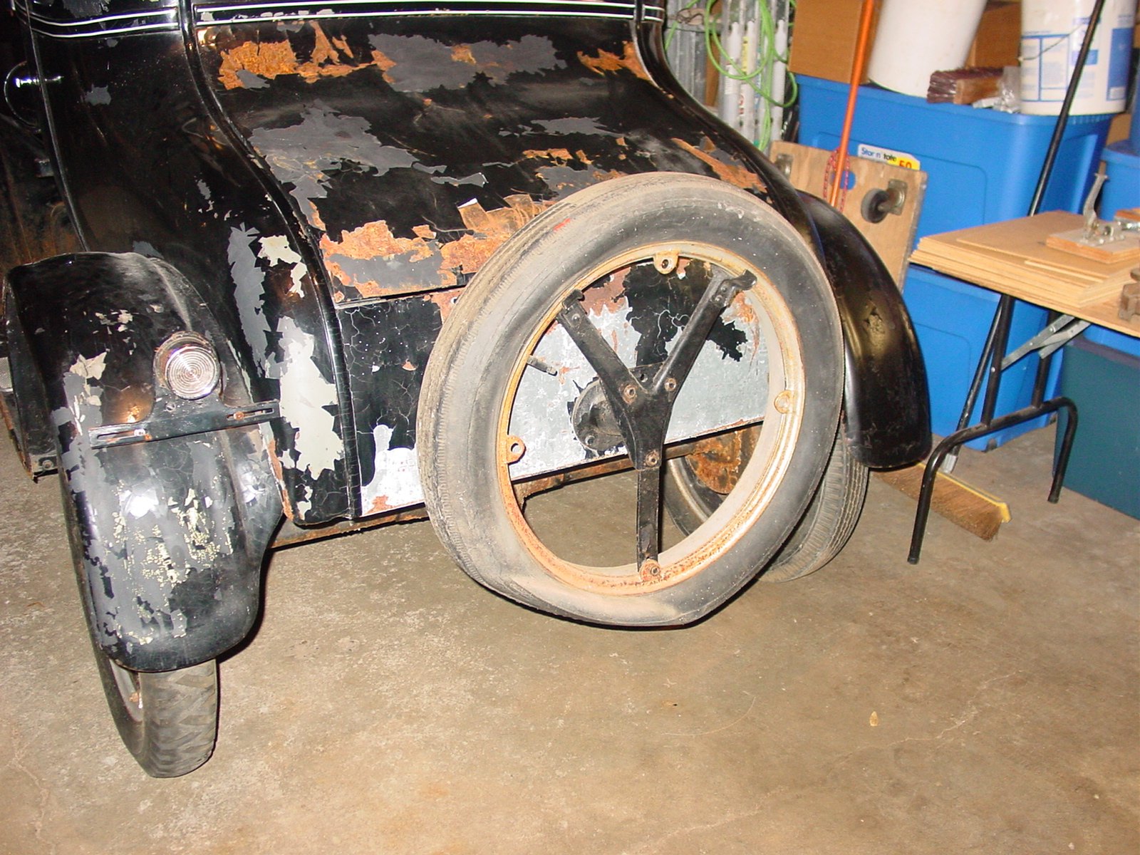

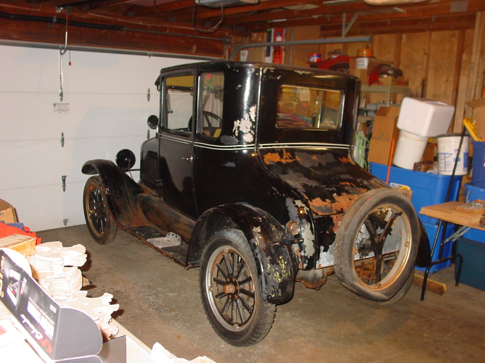

Hello everyone. My name is Dave & I'm from the Kansas City Missouri area. I just bought a model T & I know absolutely nothing about them!
The title says it's a 1927. I'll post pictures of it here and maybe you guys can tell me all about it. In particular, I'd like to know what carburetor it has, and ignition coils as well. If you could give me some ideas about the value, that'd be great. Owner said it runs, has an older restoration with poor paint work. He said he hasn't driven it because it has bad tires. Tell me what you think!

The one with the 1925 tag isn't a picture of the car. Sorry about that lol. I was trying to figure out what the coil springs were on the front of it.

Welcome to the affliction as they say. That looks like a Kingston "L4" carburetor. A fresh find with all sorts of adventures awaiting you. We are here to answer your questions in as many ways as possible. Some comments may help.
Those are Hassler Shock Absorbers.

Looks like a nice restoration project. It is indeed a 1927 Coupe, engine # on title shows it to have been mfg. Feb 8, 1927 along with 4,999 motors made that same day.
Needs paint job of course, but that can be after you get her running to see what the conditions are. The carb is factory, its a Kingston. The old water pump is an accessory and was likely placed there as the radiator is probably long gone in providing proper cooling.
So, you have a few things to do, new tires and tubes, some other new parts, and then it should be running at least to do a check ride.
Lots of others will post too, nice T to have as a new owner, seems solid without rust, and at least the replacement upholstery is good enough to get by.

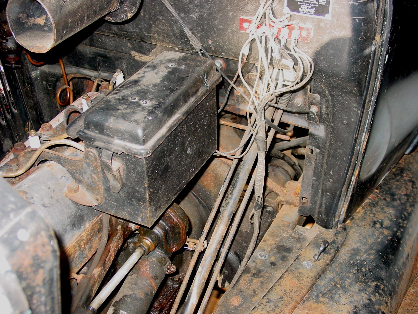

Couple of observations, the spark advance rod to the timer is placed over that large hose, unlike stock, you may have to change that out to get good timing. The carb has extra rod to it, that is linkage to a foot feed accelerator on the floorboard. The radiator is older aftermarket. Lastly, the radiator outlet with fan pulley is the early 1926 version, with adj. bolt below, Ford changed that to new style with fan shaft and eccentric to provide belt adjustment.

It's hard to tell from the picture, but that carburetor could be a Kingston L4 or a Holly NH. Either kind is dependable and parts are available to rebuild. If you see a brass plug with a screwdriver slot across the top on the top of the carburetor just toward the front of the car from the adjustment needle, your carburetor is a Kingston.
The water pump is a trouble maker, they can easily leak and drain the cooling system. The original equipment just had a fitting on the side of the block with hose and pipe and another hose to the radiator. Usually the water pump was installed if the engine tended to overheat. With a clean cooling system and good radiator, the water pump is not necessary and in fact can actually cause the engine to run too cold in cold weather.
It looks like you have all the parts to make the car run. The Model T repair manual and the books published by the club, "Engine", "Transmission", "Electrical System", "Rear Axle" or "Ruxtell axle" and,"Carburetor" Are all do it yourself instructions and should be of great help in getting the car running or restoring it if you want to. Some just like to get the mechanical system working good and leave the body as is. Others like to restore the entire car, and others like to modify it by changing color or adding speed equipment.
You should also inspect the wheels very closely for loose or broken or deteriorated spokes. New spokes should be made of hickory. Other types wood are not strong enough for wheel spokes.
You will need a "rim spreader" to remove or install the tires. Someone in your local club will very likely have one. They are good tool to look for at swap meets, or even antique stores.

I was looking again at your pics of the engine. In my earlier post I mentioned getting the T manuals to help you out. The previous owner added a water pump to it. You won’t find anything about water pumps in the T manuals because the didn’t come with a water pump!
Water pumps on a T is another thing you will learn about! But get it running like it is and then
deal with the water pump later. Good luck.

Steve, not a vaporizer car. Vaporizers use a throttle bell crank up near the firewall not down in the middle. My late ‘27 does it that way and has a vaporizer. Late production didn’t punch the web between cylinder 2&3 or drill the throttle hole in the valve cover. So it is possible he has the original carburetor.
Having the original engine for your car makes you smile... no one else cares.
I would only address the radiator and get rid of the water pump AND DRIVE IT!

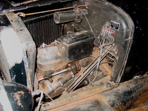

As Stan says. Don’t remove and replace the coil boxes. Your Model T can’t talk to you without its’ coils. Jim Patrick
- Posts: 7411
Re: New guy here
People change to a disturbutor because it's "more reliable". But I've been stuck by the side of the road more than once because of Chebby ignition trouble, never by Ford coils and timer.

Hi Dave, Welcome to the Model T world. It's great fun and as you have seen many good folks will join in to give you help. The Kansas City Chuggers is the local Model T club and we affiliate with the MTFCA and the MTFCI. We of course are not meeting because of the virus, but you can visit our website for information about us. Our webmaster and President is recovering from surgery so it is not real current but you can get some idea of what we attempt to do. There are several members with '26-'27 coupes in the club. I am one of them. The website is: www.kcchuggers.com. When we start meeting again we would be very happy if you would come out and see if you'd like to join us.
PS Don't get too hasty about replacing the tires - they will probably get you around until you get ready to do some touring.

Get rid of that non original patent plate above the terminal block! Ford never made those for Model T's. You need to find the correct horn and bracket made for 26-7 T's. You can't use one now because of that water pump, but if you choose to use one, they made pumps that allow you to use a stock horn. Have fun, and find a copy of the Ford Service Book, with the section in back on 26-7 models.

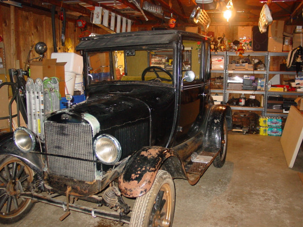

Thanks for all the great information guys!
I haven't picked up the car yet. I'm paying $5000 for it. It might be a little more than it's worth, but I don't care. I've always wanted one so it's just money.
A little about me. I'm 57 years old. I've been fixing cars since I was 14 years old. My wife and I currently own around 30 vehicles. I know it's crazy! I own a Pro Street 70 Chevelle SS that I bought when I was 19, and I still have it. I love old cars and have always owned them.
I'm a mechanic by trade and there's nothing I can't do to a car. I've never worked on a model T, but I have worked on thousands of cars, so I'm definitely not worried about fixing this car. My wife and I will be making this our project vehicle when we get it home.
I am told that this car had been restored in the past, but didn't have proper metal work done before it was painted, thus the horrible look of it.
My first priority will be to get it running and driving. I'm not afraid to drive a car with "patina", so it will get driven.
I definitely plan on rebuilding the carb, tuning it up, checking the brakes, and now the rear axle, after reading what I have read here!
We plan on repainting it ourselves. It won't be a gorgeous paint, but they weren't beautiful when they were new. We basically want to make it look something like it would have in 1927. It's cool that in 7 years, it'll be 100 years old!
A few questions for you guys. Where is the wood located on the body, and can I make my own replacement pieces? I assume it's probably oak? What size are the tires on this car? I assume 21 inch? Where can I find new tires for an affordable price? Anyone got any nice ones for sale? I'd like to do a compression test on it. What readings should I expect? Anyone got a compression tester I can borrow? Are the spark plugs a pipe thread? Should I put an aluminum radiator in it to help with cooling?
Keep the advice coming, I'm soaking it in!
I'll post pictures of her when we get her loaded up on the trailer. I'm definitely excited about this purchase!

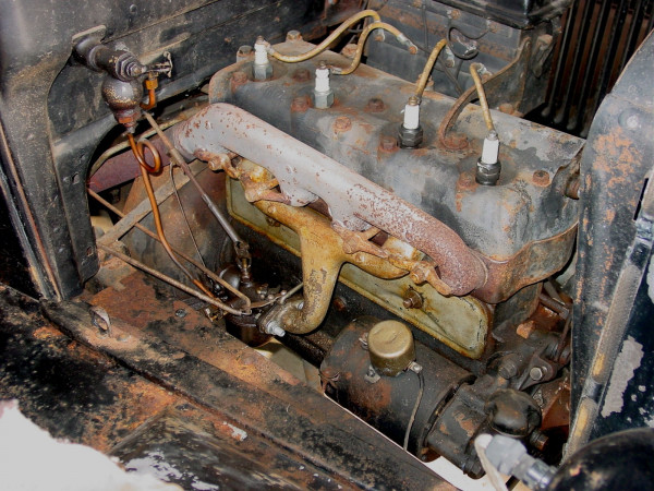

Is there a place to plumb in an oil pressure Guage? I'd like to do that. How about a water temperature Guage?
- Posts: 6789
Re: New guy here
Dave
good of you to mention that you're a mechanic. I will tell you now, that this can lead to very unfortunate accidents involving "obvious" repairs. That said, I'll warn you of one of the most common mistakes which leads to significant expense and work which can and should be avoided: Removal of the starter
To accomplish the removal of the starter, the bendix cover MUST come off and the bendix MUST be removed, and the bendix woodruff key MUST NOT fall into the transmission. Failure to remove the bendix prior to withdrawal of the starter WILL result in damage to the magneto field coil to the point of ruining it. This one mistake has led to the purchase of many distributors.
Your mechanical ability will serve you well, but your experience will lead you to mistakes if you do not research the repair well in advance of getting into trouble. This early technology came about before many modern paradigms were established. It is what makes their repair and maintenance interesting and maddening, sometimes at the same time.
Good luck, have fun, and expect surprises.
BTW, you can plumb an oil pressure gauge pretty much anywhere you want, as there is no oil pressure to measure, there is no wrong place to put it (or correct place either). It is a splash system.
- Posts: 1683
- First Name: Dennis
- Last Name: Seth
- Location: Jefferson Ohio
Re: New guy here
If you look at the front top center of your radiator you will see your "Water temperature guage" aka Moto meter
- Posts: 4694
Re: New guy here
You can use a water temperature gauge inserted in the upper hose. However a motometer will tell you if you are overheating. Unless the T has been modified for a pressurized oil system, you will not have oil pressure. You can however, tell if you are getting oil to the front of the engine, by removing the bolt at the front of the crankcase inspection plate and with the engine running, oil should run out at the bolt hole. Many T owners will install an external oiler from the magneto post to the front of the engine. If you want to do more work to get oil flow to the front, you can install other types of oil lines. There are posts instructing how this is done, and since I have only used the magneto post oiler, I won't comment on how those others are installed. I had one engine where the funnel on the T oiler had broken off soon after I installed the engine and ran on only the pipe without the funnel and the magneto post oiler. I ran it for ten years that way and on many tours. I know exactly when the funnel broke off because soon after I had installed the engine, the mag stopped working and I ran on battery for those ten years and didn't know what had happened until I pulled the engine and found the coil ring had been broken and the funnel resting on the bottom of the crankcase.

Should I convert it to 12 volts? I just thought it would be easier to work on it with a 12 volt system.
Is the coil box rebuildable? I don't know the condition of it, but I'm hopeful that it will be fine. I'll figure it out when I get it back home.
- Posts: 6789
Re: New guy here
12V is not necessary. Upgrades to 12V are usually a bandaid fix for a shot starter and/or badly silvered reflectors in the headlights. Brisk starting and lights that rival 12V can be had with 6V if the car is in proper condition.
Yes, the coil box can and should be rebuilt. The best material to use is the thermoplastic kit offered among other original wood options which vary from poor to excellent. The plastic version is impervious to moisture and moisture is your enemy here.
Stan Howe gave one of the very best soliloquies on thoughtfully bringing the car back to operation that I have ever seen. Do not be in a hurry to "improve" on what is arguably the most debugged and best selling vehicle of all time. That said, looking at the wiring, a thorough going-through and replacement would be in order for simple safety's sake.
4 rebuilt coils, a rebuilt coil box, new wiring, a clean fuel system and a rebuilt carb, which will be the simplest you've ever seen, (but which cannot be rebuilt properly on intuition alone) will likely have it running.

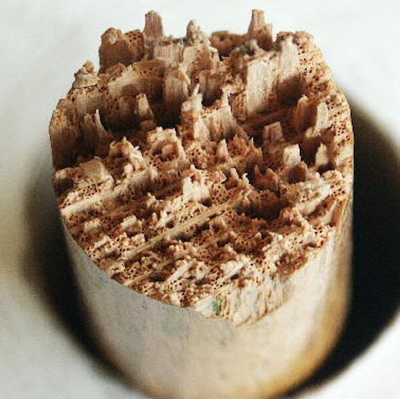

Here is a post from the past discussing the wood used on the Model T. One of the considerations Ford had in deciding what wood to use was cost and convenience. Keeping costs down on raw materials used in the construction of the Model T so that the average man could afford it was the biggest incentive for Ford to find the most inexpensive materials available. Factors such as how much the wood itself cost and finding woods that were located close to the factory to minimized shipping costs. One type of wood local to Michigan that is straight, strong and knot free is Fir. I don’t know how numerous Fir forests are today, but there were many around Detroit in the early 20th century and for us, Fir can be found in any lumber supply nationwide. The wood is strong, the grain is super straight and the wood easy to work with. I have heard that Ash is a good wood for body wood. Hickory is still the only choice to use in the spokes. I remember a post years ago on the Forum where a member posted warning pictures of his shattered spokes that he made from Oak. www.mtfca.com/cgi-bin/discus/show.cgi?tpc=29&post=19282. Jim Patrick
PS. If anyone can add to this it would be welcome.

Re: New guy here
I think this may be the oak spoke Jim mentioned.

Re: New guy here
Regarding broken Oak Spokes: The broken spoke guy was Ralph Ricks. I don't know where he got the oak spokes, but he did switch back to hickory. He used to tow his car by hooking it to the hitch on his Jaguar and then towing it on all fours. As I recall he got the steering turned and the sidewise forces on a front wheel snapped a bunch of spokes causing the collapse.
If a wheel collapses in use you are looking at a possible roll over. I recall a broken wheel/rollover of a touring a few years ago. I read there was a fatality. To avoid this I suggest turning only hickory spokes or do what I do... buy spokes from a reputable dealer. I get mine from Langs. Steve Lang has a local turn good straight grain Hickory. Out of 48 spokes I rejected only one because the grant wasn't perfectly stright. They didn't mind replacing that one... didn't even want me to return the bad one.
Other than RD's and that one touring car (I think it was a failure due to a problem with aftermarket shock absorbers) I have never heard of a model T wheel failure like that. I suggest that Dave check his wheels and make sure everything is tight and just drive it!
Regarding the shop manual, that is the one you need. It is available inexpensively as a paperback from most of the vendors.
IMHO,TH
IMHO,TH

Re: New guy here
Ralph’s post was in 2011 and can be found in the attached thread. Ralph was very knowledgeable and his contributions always taught me a lot. He was taken too soon, by a very cruel disease called ALS and is missed: www.mtfca.com/discus/messages/179374/256114.html. Jim Patrick
- Posts: 7411
Re: New guy here
Terry remembers correctly that the fatal rollover was attributed to the failure of an aftermarket shock absorber/perch. The executive summary of the wreck says the incident began with separation of the left front tire and rim from the wheel at about 30 mph, causing the front wheels to whip left. The summary attributes the wheel separation to a sudden loss of air, but I wonder if it might have been failure of the rivets holding the rim to the felloe. I've certainly seen (and replaced) wheels with loose rivets and rims. The report doesn't mention spoke failure. It concludes that the sideways wheels put rearward stress on the front axle assembly, breaking the aftermarket perch and dropping the wishbone, which vaulted the car into a rollover.
Like many wrecks, I think this was a combination of failures. Without the wheel failure the perch would not have been stressed and broken, and without the defective perch the broken wheel may not have rolled the car. The lessons I take from this are (1) be sure the wheels are sound and (2) use good Ford perches.
jiminbartow
- Posts: 2478
- Last Name: Patrick
- Location: Bartow, FL
Re: New guy here
I remember accidentally finding a bad front wheel while waiting for a friend to bring me a gallon of gas, after I ran out, close to home. I was walking around my T waiting, when I noticed a very fine, light brown coating on the black rim of my right front wheel. Upon closer examination, I found that it was a very fine wood dust that could have only come from one place. My spokes. I grabbed each spoke and pushed and pulled each from side to side and, instead of being tight, they all moved. When my friend delivered the gas, Instead of driving it home, we pushed the T home and, as I pushed the car, while next to the front I heard a distinct click of each spoke as the wheel turned.
Had I not run out of gas, I could have had a very bad accident when those dry rotted spokes finally let go while cornering. Checking your spokes during a walk around should be a routine each time you drive your T. Things of this Importance and magnitude should not be discovered by accident. The three things to watch for are: 1. A fine brown powder coating your rim. 2. Spokes that can be moved when shaken and 3. A distinct clicking sound when the wheel turns.
I did not drive it again until I made a Regan spoke press, bought new hickory spokes from Snyder’s and changed out the spokes on that wheel. The following thread document the generally accepted way of replacing the spokes in your 21” wheel: www.mtfca.com/discus/messages/179374/183733.html. Jim Patrick

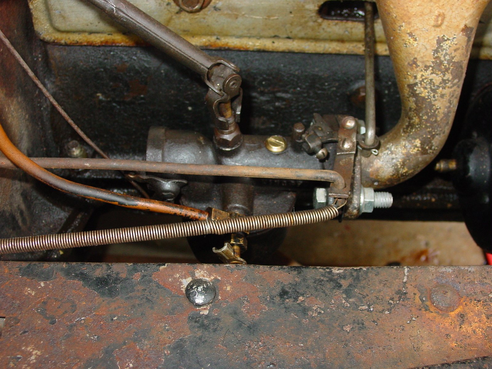

Re: New guy here

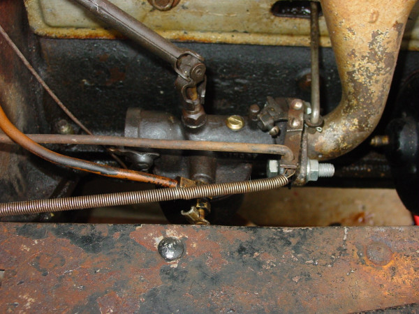

Here's a better picture of my carb. How difficult are they to rebuild? Also a picture of one of the tires and wheels.
jiminbartow
- Posts: 2478
Re: New guy here
Not difficult at all with a rebuild kit containing the gaskets, and new needle valve and seat and the T-1 Model T Ford Service Manual to walk you through step by step. You will definitely need that manual, so, if you haven’t ordered it already... Jim Patrick
PS. I see a screen door spring and some extra linkage hooked up to the carb going straight back under the firewall. Is that for a gas pedal? If so, that was an accessory, not original to the T. Original throttle was a lever located on the steering column under the steering wheel.
- Posts: 7411
Re: New guy here
From the brass screw on top I assume the carb is a Kingston, probably L-4. There should be a tag on the far side of the top to tell you about that. Kits and individual parts are available. The gasket that comes with a new float valve may be too hard to seal. I make my own gasket to use there. In addition to the Service Manual, there is a carburetor book available from MTFCA.

Re: New guy here
Hi Dave,RumblingThunder wrote: ↑Sun Apr 12, 2020 3:15 amHi Dave, Welcome to the Model T world. It's great fun and as you have seen many good folks will join in to give you help. The Kansas City Chuggers is the local Model T club and we affiliate with the MTFCA and the MTFCI. We of course are not meeting because of the virus, but you can visit our website for information about us. Our webmaster and President is recovering from surgery so it is not real current but you can get some idea of what we attempt to do. There are several members with '26-'27 coupes in the club. I am one of them. The website is: www.kcchuggers.com. When we start meeting again we would be very happy if you would come out and see if you'd like to join us.

Steve has said if the same number is stamped on the frame rail that is on the registration it HAS the original engine. Note, the number should be stamped on the side of the engine block right above where the water pump is bolted to the block. Sometimes, the engine has been changed without changing the number on the registration. So, all three places should have the same number. Even so, some after market engines came without a number stamped on them and so you could either have one without any number on it or an engine on which the original number has been ground off and re-stamped with the number on the registration. However it doesn't matter anyway as long as the number on the engine and the registration are the same.
- Posts: 4694
Re: New guy here

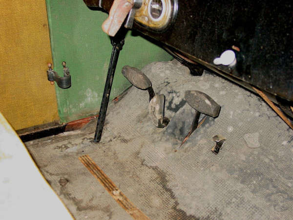

Yes, you do have an accessory gas pedal to the right of the brake. This is not original equipment. When you get used to shifting with the left pedal, and using the throttle lever on the steering column, you will find it is kind of like using automatic transmission and cruise control! If you have an accessory transmission such as a Ruckstell or Warford, you might find the throttle lever useful because you need your right hand for shifting.
Another thing I noticed which is different, is an idler pulley on the fan belt. I am not sure why it was placed, but with the 27 fan pulley, the adjustment is made by rotating the eccentric fan bracket behind the fan pulley. When you adjust the belt, be careful to turn the eccentric in such a way the belt doesn't interfere with the spark advance on the timer. This is also somewhat dependent on using the correct belt length. This length would differ from the stock length without the water pump.
Hopefully, by this time, you might have already gotten your car running and found some club members in your area who will help you and get you acquainted with the peculiarities of the Model T.

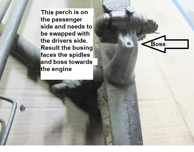

Re: New guy here
Hi, Dave -
It's always great to welcome new people into the flock. I hope you get a lot of pleasure and satisfaction from the coupe, it looks like a solid one.
One thing I think I see in the photos is the tilt of your front axle, or the lack of tilt. Normally the axle would "recline" with the top of the spindle noticeably leaned back. The tilt is provided by the spring perches and, as you already know, the car has Hassler shocks (I think they're great, they make a car ride like a baby buggy). It looked to me like the Ford leaf springs are twisted forward a little and that drew my eye to the spindles. The spring perches have to be turned in their holes for the Hassler geometry and, unless they are also swapped side-to-side, they will give negative caster.
The benefit the positive caster gives is it makes the car want to go straight. It will resist a little going into a turn, but it will almost straighten it self out as you come out of the turn. It makes easier to take on trips, unless you're driving in curvy mountain roads.
Not only does negative caster does not offer those benefits, it provides the opposite effect; the car will drive squirrelly, darting around. It's exhausting to drive one like that because you can never let your guard down, expecting the next jerk on the steering wheel. I know of at least one recent rollover crash (everyone survived) in a brass car because negative caster yanked the wheel out of the driver's hands and a front wheel collapsed.
I'm sure the forum guys will have good photos of how the axle should look.
- Posts: 7411
Re: New guy here
I don't have a photo handy but see Page 45 in the Service Manual for an explanation and a picture.
- Posts: 5246
Re: New guy here
The proper spring perches, in the proper side have a bend to give that caster. If Turning them around for Hasslers, they would have to be swapped side to side also.Steve Jelf wrote: ↑Wed Jul 14, 2021 12:20 amI'm sure the forum guys will have good photos of how the axle should look.
The T1 service manual offers conflicting specs for the amount of caster. There is a dimension & an angle. Trigging the angle gives a very different upper spindle spacing. I usually set that difference @ 3/8". See manual. I have used as much as 5/8" for personal use.(Sure tracks nice down the freeway)
Its very common to find a T with the perches backwards. (axle backwards)
I recently worked over a front end. Final check to be the caster & toe in. Caster was 0. Looked close. Axle had 2 right side perches. That was a new one. Replaced it. All in spec now.

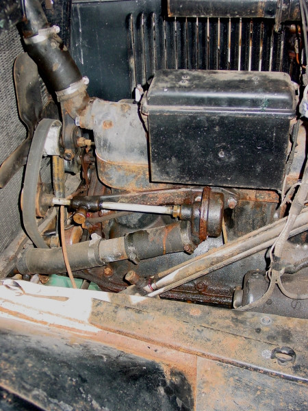

Re: New guy here
One thing you need to decide is where you want to go with the restoration: museum piece; factory correct; period correct(aftermarket accessories); "excuse me, its my Model T". You can also progress from one state to the other to get to where you want to go.
The aftermarket water pumps of the day did little to move fluids once the operating temperature was reached - most were just sinning propeller. If you need a radiator, no question that a Berg is the way to go. Model T aluminum radiators are for "T" Bucket hot rods water inlets/outlets corresponding to engines used. The beehive springs are Hassler shock absorbers - there was a different style designed for 1926/27 (i.e. Pancake) , mostly for the rear spring perches needed, but the beehives will work on the front. You need to be careful in removing them as they are under load. The front Hassler's perches were pointed outward. The beehive style required them to also be swapped from side to side as mentioned above. They should have the boss on top of the perch pointed back to the engine. Learn to search the forum for your answers to your questions - the SEARCH option in this version of MTFCA only looks at the 2019 & onward discussions. Use GOOGLE and add MTFCA to the end of query, Like This: Hassler beehive MTFCA
This is a good reference about them http://www.mtfca.com/discus/messages/50 ... 1426168045
This attachment shows the front perches in their normal position, no Hasslers, and what needs to be done for the beehive Hasslers. Th Pancake style have a different requirement (just spun outward in place, no swapping, because the lever arm was designed to include the necessary tilt).

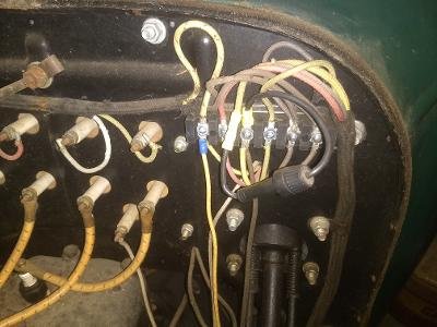

Re: New guy here
Be sure Your car has a inline fuse between the floor starter switch and the terminal block on the fire wall. some old timers hate fuses. I hate fires. and with a 93 year old electrical system You can't be too careful. first night I had My first T and turned on the headlights sparks shot out of the headlight switch. red glow in the switch and burnt smell in the night air. now all three of my Ts have fuses. I have fuse holder mounted at fire wall terminal block for ease of access in checking fuse and disconnecting it when working on electrical system. yes there is about 18 inches of un fuse wire going to the foot switch. but I take that bet as opposed to lying on Your back under the car or pulling the floor board. I disconnect the negative battery when the car is not in use as extra 100% protection.
