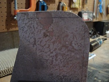

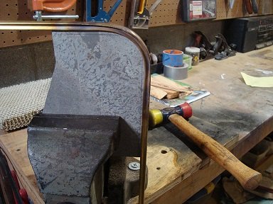

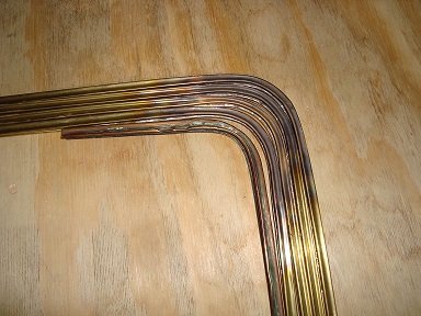

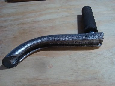

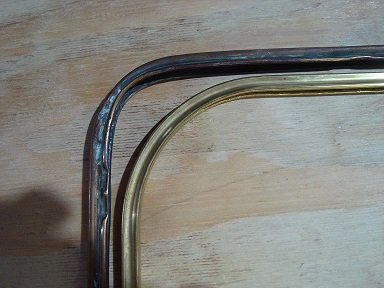

So thanks to my new friend Henry Lee, I was encouraged to try my hand at annealing the brass windshield channel that goes to my 1910 Touring. The channel set from the vendor was bent at too wide a radius to fit my brass frame so I needed to anneal the corners and tighten the radius. I had a corner piece from the original channel to use as a template and I traced that radius onto a piece of aluminum. Using a hand-held propane torch I heated each corner piece to a dull red, moving slowly along the brass, then let it cool off. I did this five times to each corner piece. Setting a piece of brass on the aluminum template (held in a vice) I slowly worked the channel into the correct shape using the handy home-made tool from Hank along with a soft mallet. It didn't take much, and the sides did not bend out thanks to the correct shaping tool and viola, the corner radius now fits my frame nicely! I was very nervous about trying this because those brass channel sets are not cheap; but the encouragement, advice, and generosity from a fellow T guy was all it took. So if you need to do this same project on your early T frame, feel free to contact me and maybe I can be a help to you! Thanks again, Hank!

- Finished process; original corner piece with re-shaped pieces
- channel6.JPG (40.62 KiB) Viewed 2674 times
- After annealing process, time to work it!
- channel4.JPG (47.75 KiB) Viewed 2674 times
- Aluminum cut to correct radius
- channel3.JPG (37.93 KiB) Viewed 2674 times
- Handy shaping tool!
- channel2.JPG (32.22 KiB) Viewed 2674 times
- Original corner vs vendor corner
- channel1.JPG (35.79 KiB) Viewed 2674 times
