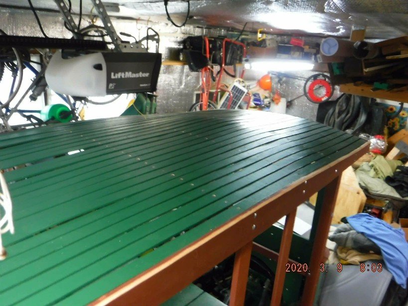

First off the top of my vehicle is about 46 inches wide and almost 96 inches long. I did paint the slats before installation because painting upside down sucks. The slats and top did require some paint before installing the top though.

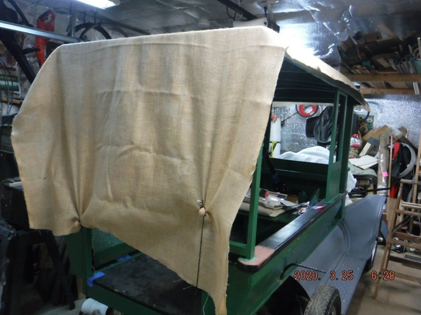

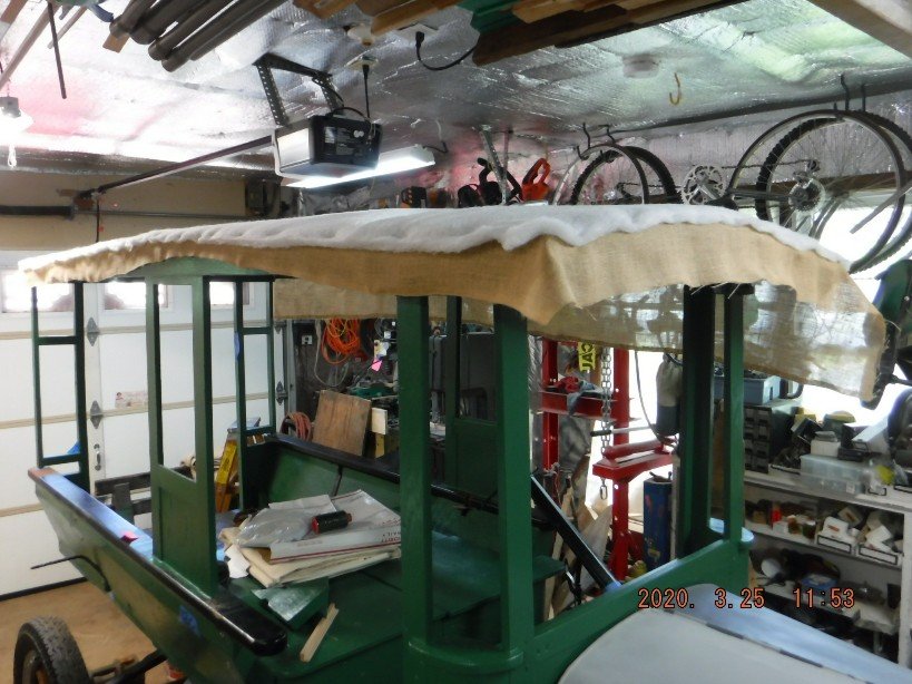

The first layer I installed was the burlap. This is what I wanted to be visable from inside the vehicle. I attached the burlap to the front and stretched to the back.

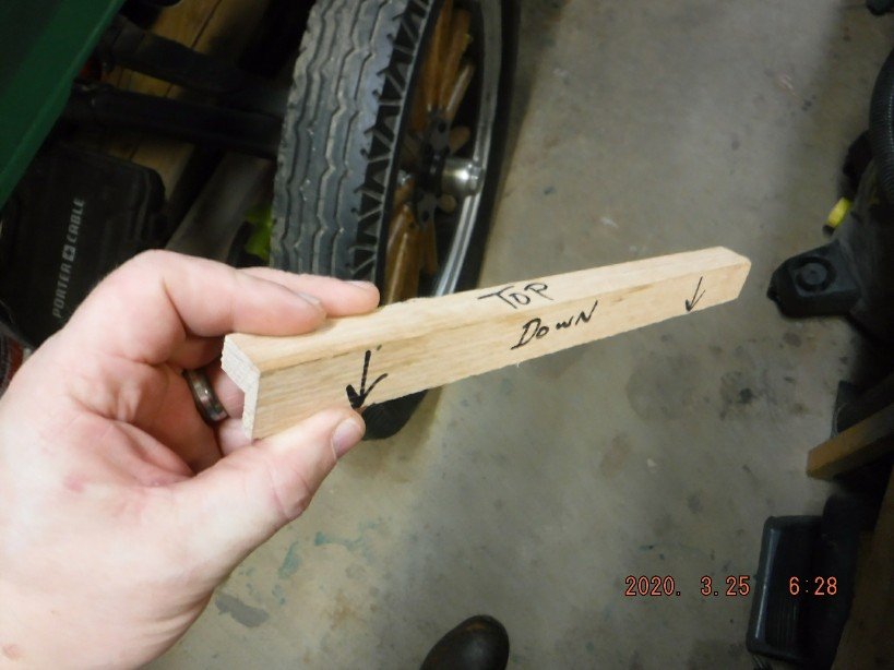

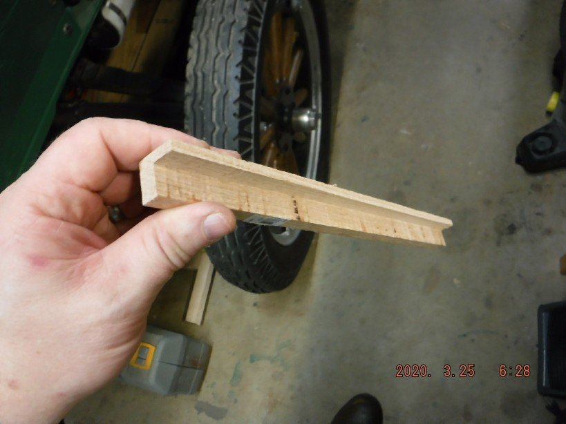

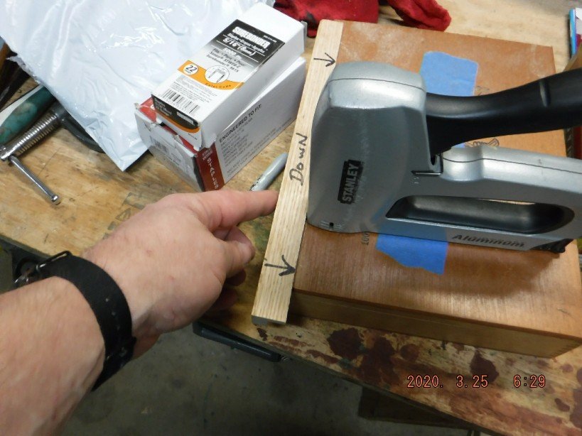

To keep the staples a uniform distance from the top I used a home made jig to set the distance from the top down. I used a hand staple gun and 5/16 staples.

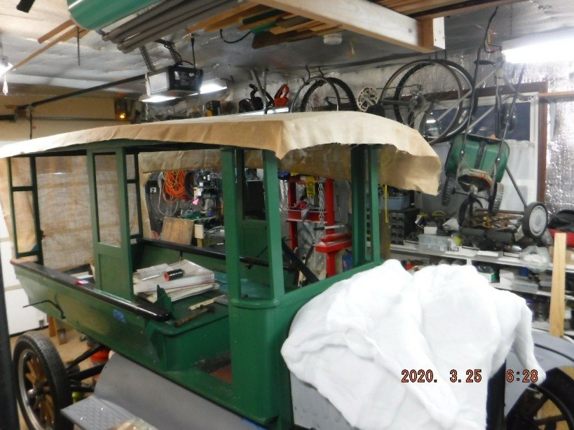

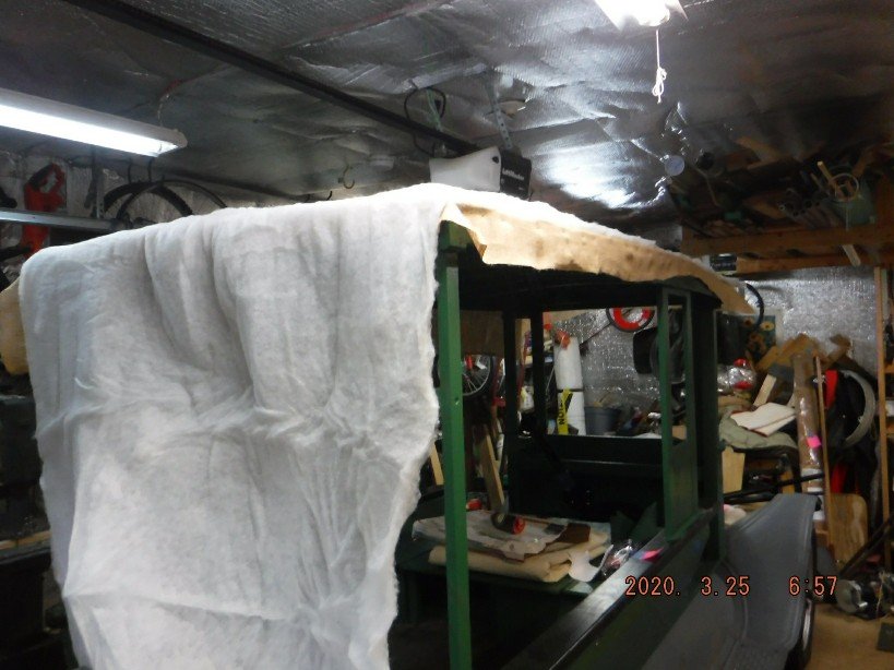

Once this was stapled all around I added a layer of batting material. This came off Amazon for about 30.00. It wasnt really streatched much, just enough to cover everything.

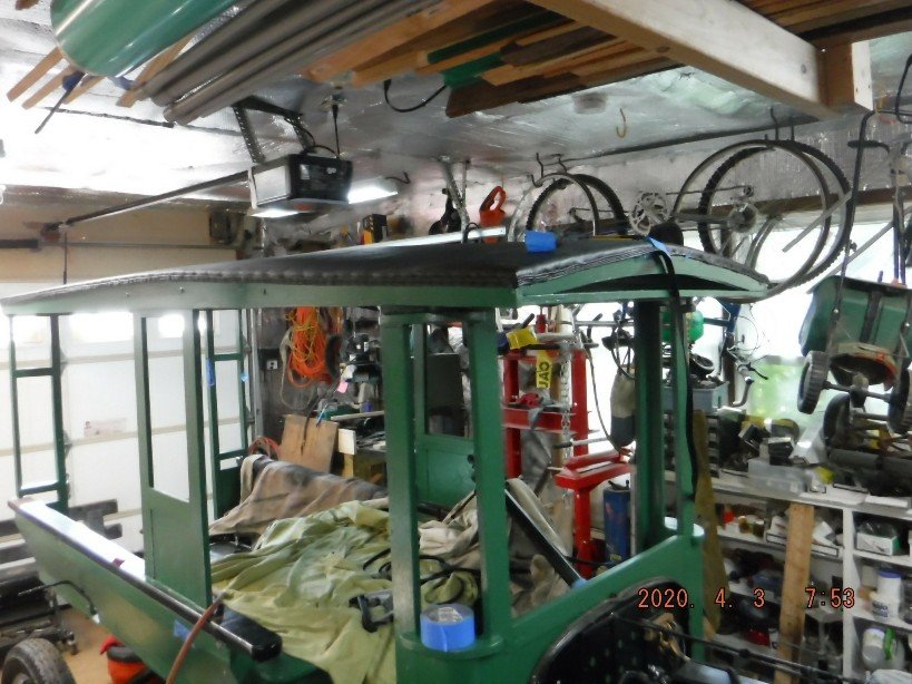

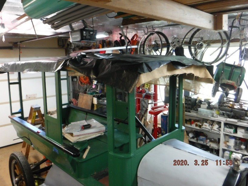

Once the batting was attached I covered this with a layer of black plastic. Not so much for water proofing but to keep the paint I used to seal the canvas from bleeding through to the burlap. The plastic wasn't stretched just pulled taught and stapled.

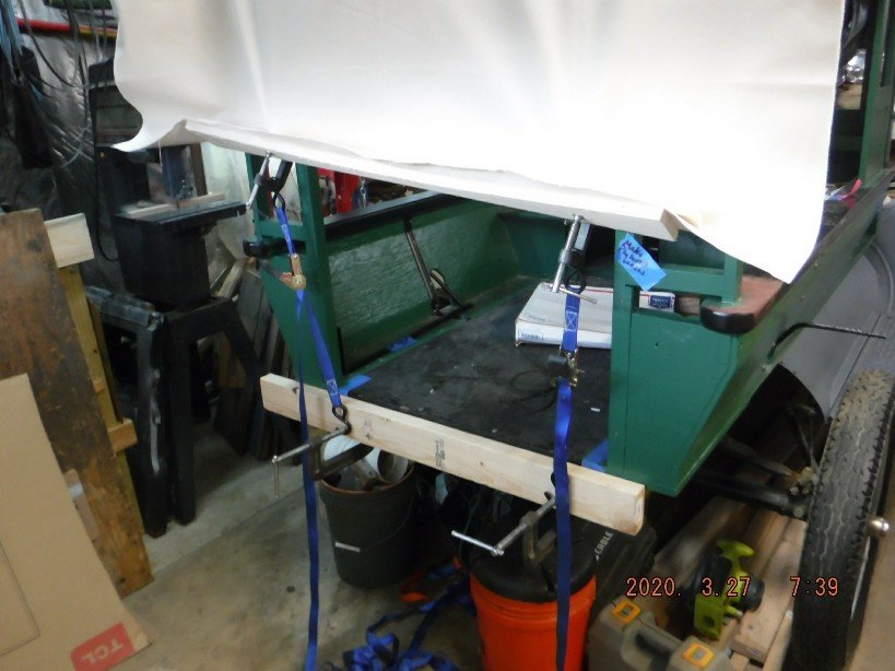

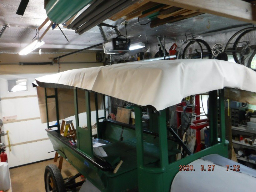

This is the canvas I used. It was attached at the front and stretched to the rear using some wood scraps and ratchet straps.

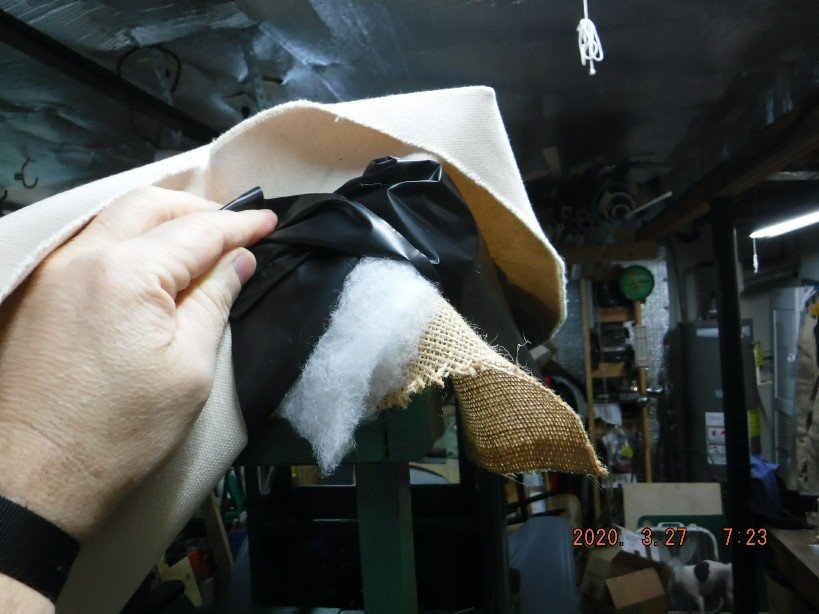

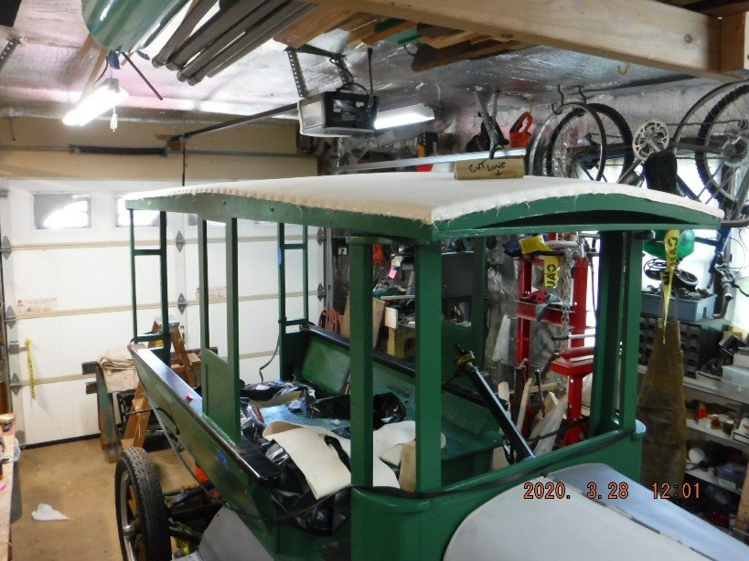

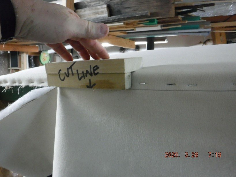

Once the canvas was attached I used anouther jig to mark the cutline around the edge and then trimmed everything.
Also this is a picture of the layers.

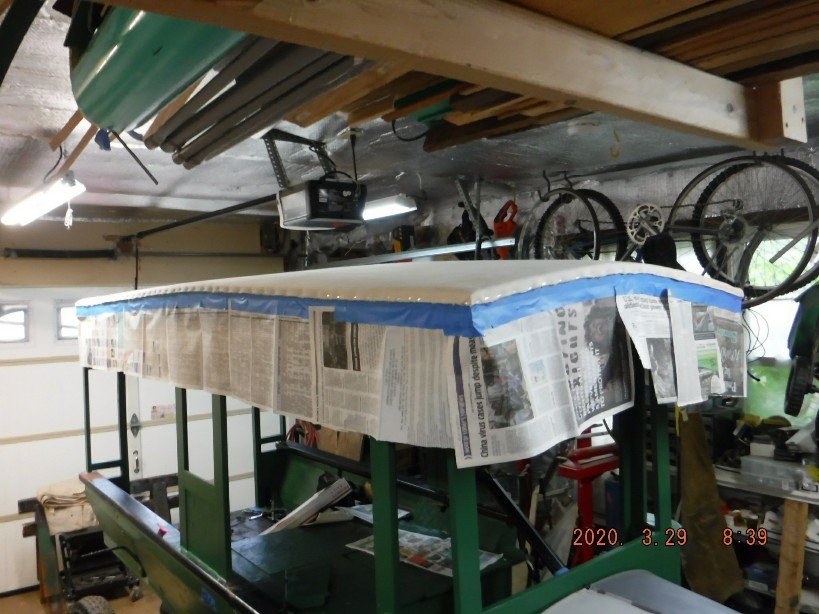

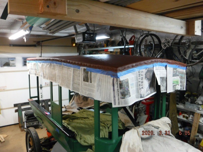

Once everything was trimmed back I masked the area around the top and used drop cloths to cover the vehicle.

Then the painting began. I used Rustolieum Rusty metal primer. For the first two coats. This stuff will stick to anything. The top Drank up about 3/4 of a gallon of the primer in the end. The best way I found to paint this was using a roller. I tried a brush but it looked awful. Once the primer was done and dried. Overnight. I applied Rustolieum flat black. 2 coats and it took 1.5 pints. Once the black was on, every manufacturing defect in the canvas appeared. I'm ok with this but I'm just giving you a heads up.

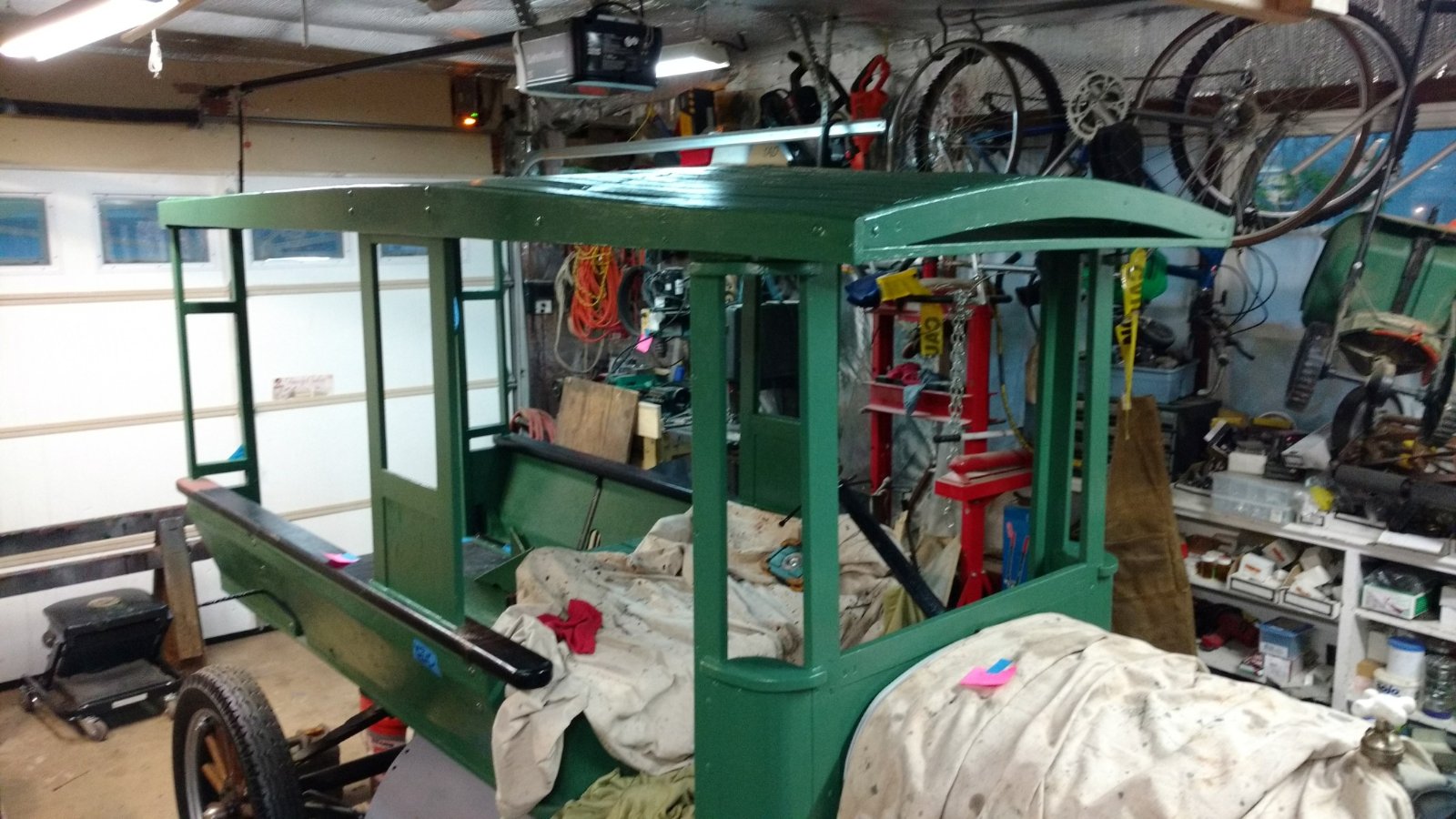

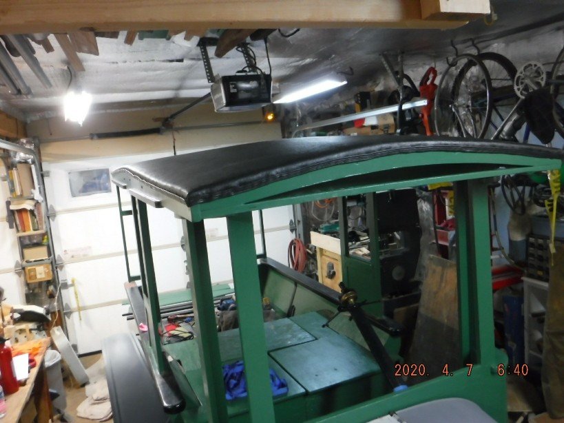

Once the black was dried I removed the masking and used Hydum / Welting to hide the layered edges. I used a 7/16 staple on this and an air powered staple gun for this. I found if I held the gun at an angle so one end of the staple went into the upper layered part and the other end of the staple went into the flat wood, it held well and covered the layers well. Trial and error there.

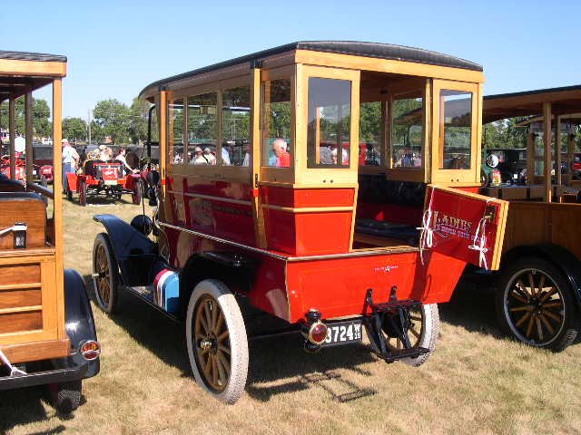

Thanks for taking the time for photos and explination Jim. A nice step by step. Its alot of work doing these tops but very rewarding in the end result. I used the top material the venders sell on my TT and it was alot of work but nothing like yours. Many miles and smiles are ahead of you.

When I did the top on my hucksters truck I used some black rubber roofing like that which is used on a commercial flat roof. It was what I could find. I didn't think about padding it. I only have every other slat in place on the roof. Would that be correct? I seem to remember that was what was there when I got it.
