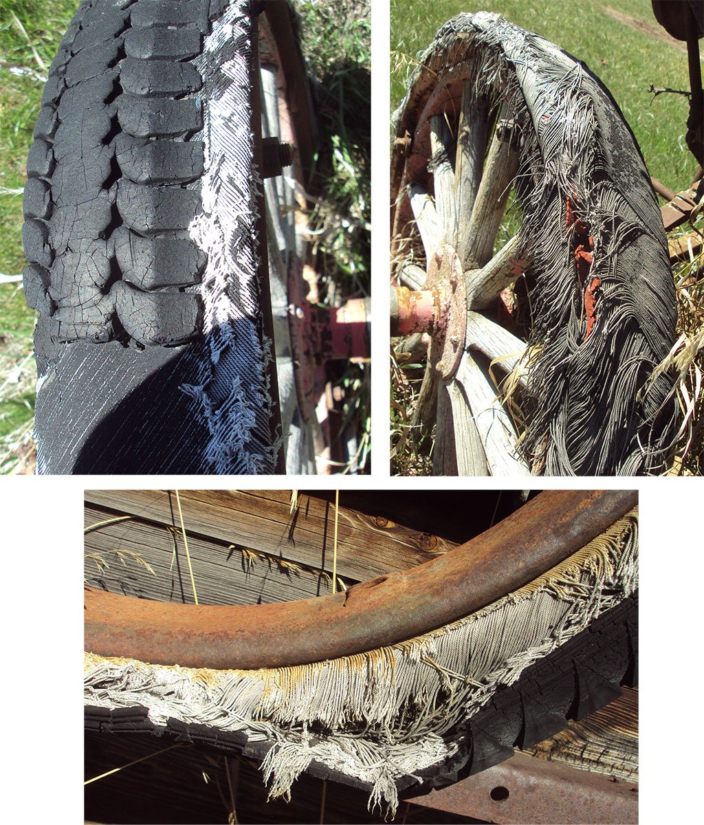

I promised to report when my Coupe tires gave out. This week one lost it's air in the driveway. Many thoughtful soles warned me not to drive on them for the past 20 years or so. After showing serious breaks in the rubber exposing the cord I vowed to drive them to the breaking point as a research project.
I bought new Firestones in 1964. They ended up costing $46 a piece. I was led to believe they would be around $28 like comparable Riversides but on arrival the story changed.
My '25 Touring did not ever run well enough to put much wear on the tires.
The Speedster was a different matter and I ran them until the tread was gone. The new Firestones that I replaced them with were much different and I was plagued with flats. They would slide on the rims and get cut. Added pressure didn't seem to help. After rim cutting 10 of the new ones I switched to Universals and also started using flaps.
We didn't put many miles on them with the Runabout but they have been on the Coupe for 7 years. That is about 8,000 miles. There have been crack lines showing for the last 30 years. If my math is right they would be 56 years old.
I also have 4 spares that would have been purchased sometime in the '60s and mounted on a 2-cyl Buick that have just a few thousand miles. Those will serve as spares along with 4 Riversides about the same age and some of the later rim-cut tires. The flat tire holds air but I'm not sure for how long. I may pursue boots and put it back on for further testing. I was sure it had blown out but not so. I also will keep track of the other 3 and report if anything interesting happens to them

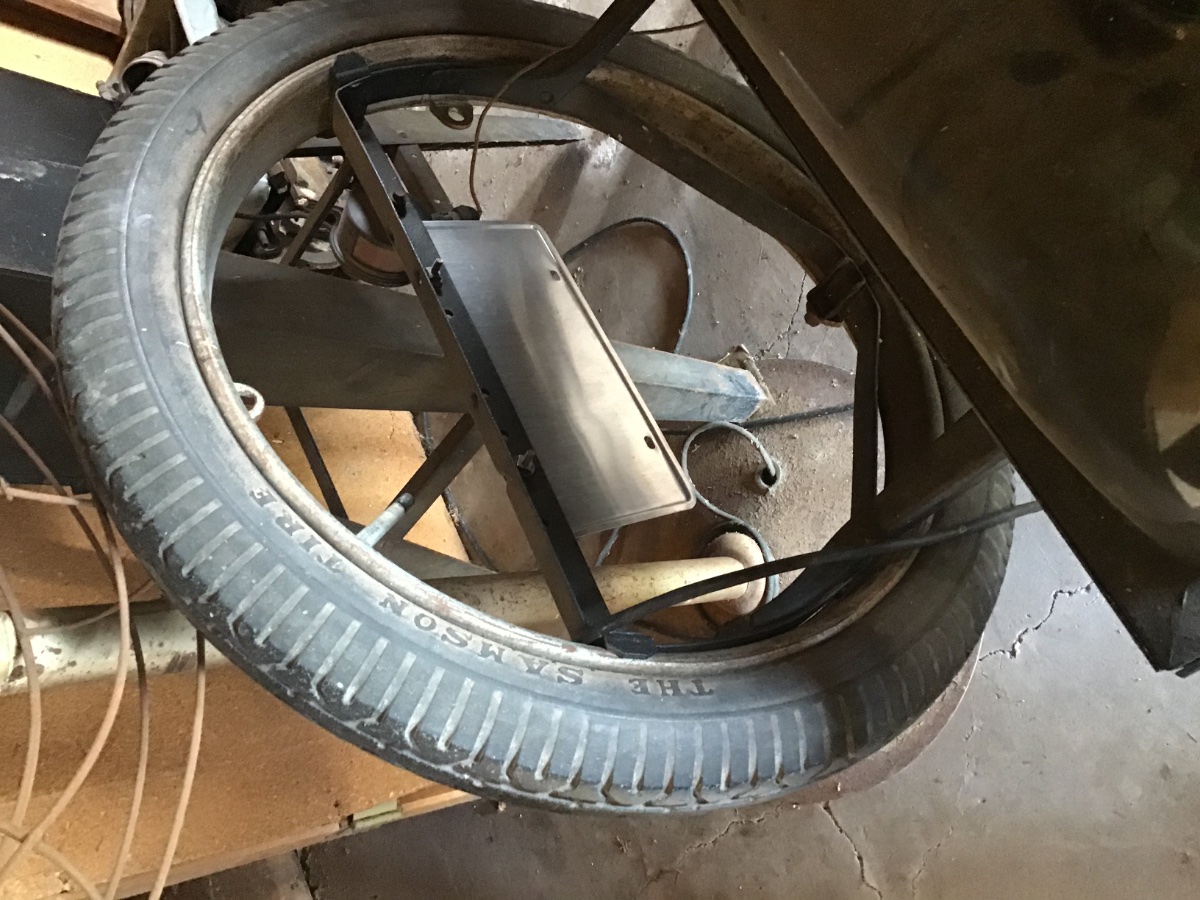

Since the subject is ‘old tires’ here’s my contribution. This is my spare on my 1919 roadster. Another neighbor gave it to me in the late 70’s when I started gathering parts for my 1919 roadster. It’s a Samson which has probably been on the rim for at least 50 years. It was hard when I got it and surely still is.
It has about 20 lbs of air in it and it’s probably enough to get me home since it’s so hard. Maybe!
I’m afraid to put more in it but not for sure! Tap on the pic to make it right side up. Sorry it came out that way.

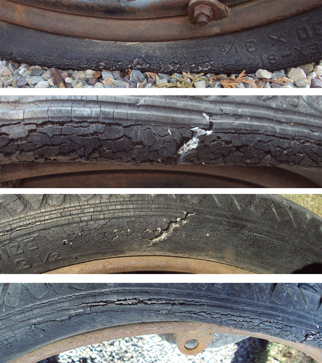

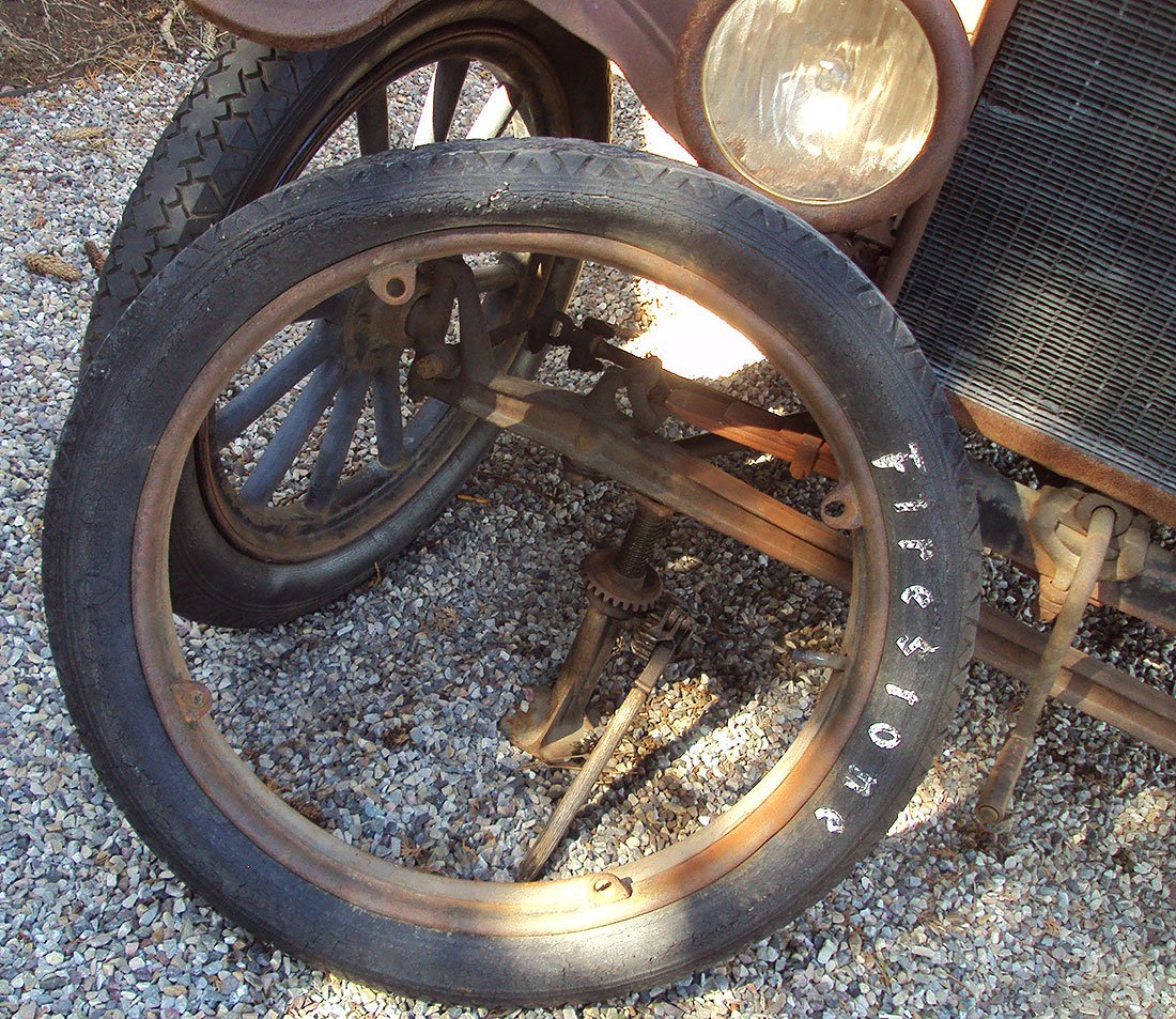

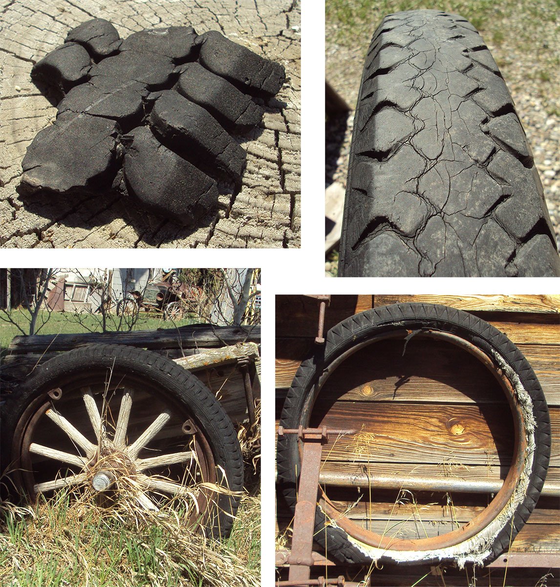

Perhaps it's my fascination with colors or maybe it's having been around them since the ‘60s like Rich Bingham mentioned but there is a certain beauty in these tired old soles. I definitely have a respect for all the miles they saw.
While my curiosity leads me to use these things and learn from them I certainly don't recommend anyone risk life and limb trying to drive on them. This discussion is offered as a look at these as they are. Always keep your safety and that of others in mind.

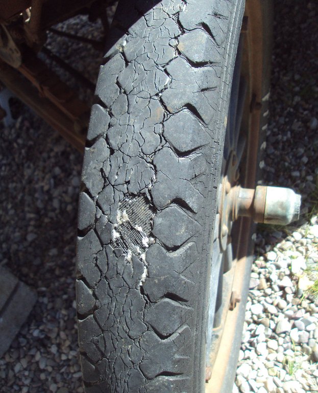

While working on the frozen spindles I see another of my 57 year old tires is nearing the end of it's useful life. It would be fun to see how long it lasts but I can save the inner tube by moving it to another tire.
While I don't recommend driving on tires this bad I do believe it has been a study of either the duration of tires or maybe just my stupidity and persistence. As I mentioned earlier, these were purchased in 1964 and have endured only a few thousand miles but lots of UV rays and inclement weather.
Stay tuned, two more to go.
