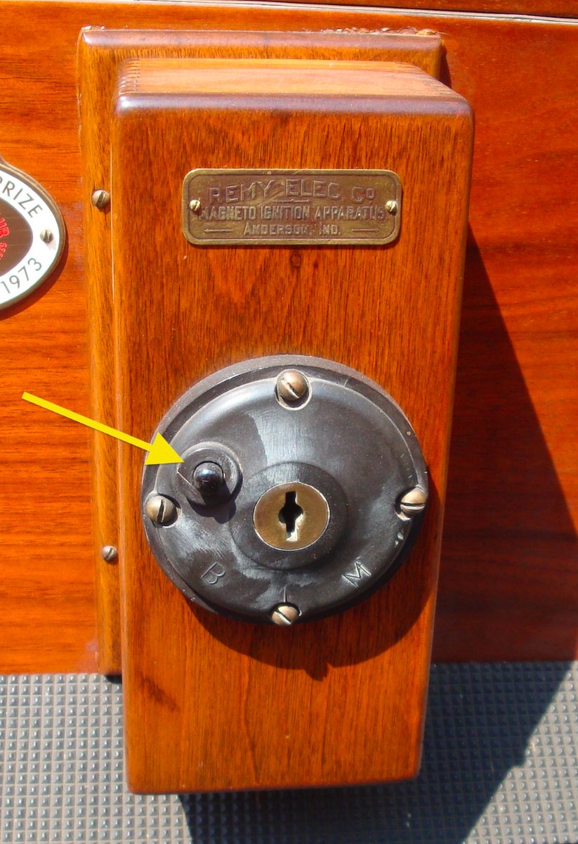

My dad's 1910 IHC Model F roadster has a low tension, Remy magneto ignition. The coil box has a push button on it. After priming the engine with the ignition off, you turn the switch to "BAT" and you can push the button to fire one of the sparkplugs and you MIGHT get a free start (or at least a "chug"). Remy referred to this in their literature as "starting from spark." See photo below.
My unrestored 1917 roadster has a very worn-out motor (the original owner drove the car for 30 years) and will free start all day long. It is equipped with an NOS Anderson timer, HCCT adjusted coils with new points but original condensers, new spark plugs and an overhauled Kingston L-4 carb.
My father's 1917 touring has a fairly fresh rebuild and will also free start.
The late Bob Schultz of North Branch, Minnesota had a 1919 touring that he would display at swap meets and car shows and he would demonstrate free starts all day long.
He also had adjusted timer so he could overly retard the spark and idle the motor so ridiculously slow you literally count the chugs.
Years ago, there was gentleman here in the Twin Cities who had an early touring that would regularly free start when he turned on the switch after three or four hours of sitting from the last time he had it running. The engine was probably not rebuilt, but just overhauled (new rings, valve job, tightened the bearings, etc.).
When you hand crank a Model T on battery, you merely putting everything in the proper position so internal combustion takes over. Note how slowly 91 year old Royce Peterson cranks his car in the video below. He lets physics do the work, not muscle. It's really no different than a "free start."
https://www.youtube.com/watch?v=RhEnNzv6LBM

Hot or cold, I never get any free starts when I have it set to magneto for starting! LOL

Re: free starts
Oh ! That’s different. That works every time. I thought one of the rules of free start was the car cannot be moving ?
