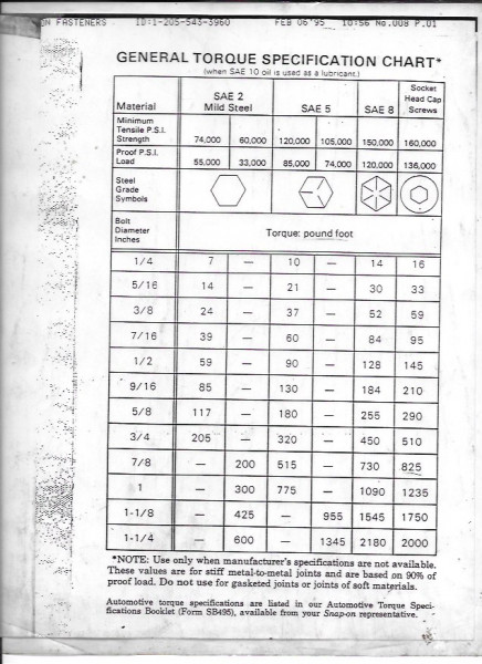

For those who need a quick reference.., here you go!

Hank, would it a good idea to give a caveat for the 7/16 head bolts?

I hope people do read the notes on the bottom.., was posting this for where there is not a torque value. But good point Scott!

Hank, I didn't even see the notes on the bottom. Thanks for pointing that out
