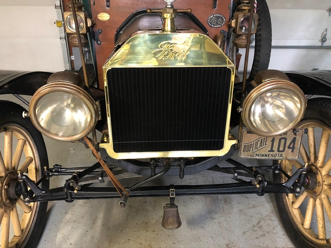

Re: restoring springs
Post by Jeff Perkins » Fri Apr 10, 2020 9:24 pm
I agree with Mark. I did the front and rear springs on my 1913 this past winter. I wire brushed mine, wiped them off and painted with Slip-Plate. No paint or primer as per instructions from a respected old time mechanic in my area. I am very satisfied with the results.
