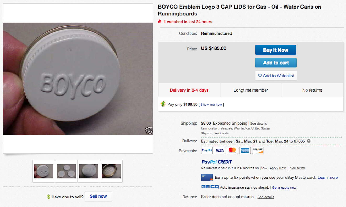

A company has tooled up and makes reproduction caps, but real pricey for a set of 3 :(
https://www.ebay.com/itm/BOYCO-Emblem-L ... SwDN1UQuuu

And those reproduction lids look terrible compared to an original! They are a regular modern style screw cap with the logo stamped on them. Not at all what I’ve seen on originals.
I wonder where this guy is getting the lids he stamps with the Boyco name. They are obviously not a reproduction of the original Boyco lid.

What a Deal... Only 65 bucks each! They should seal leak free for that amount!

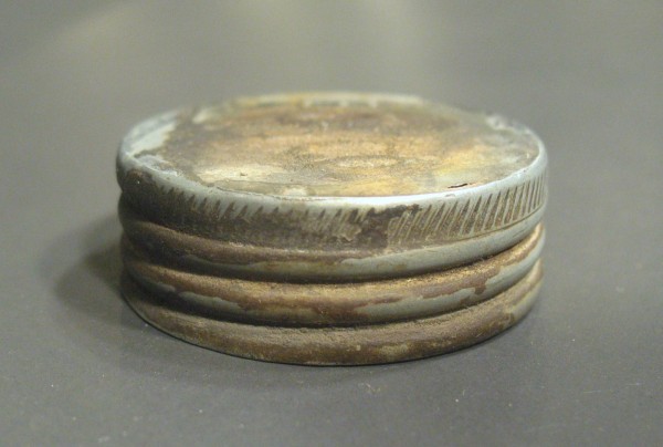

Orignal BOYCO lid. 1.5" x .5".
