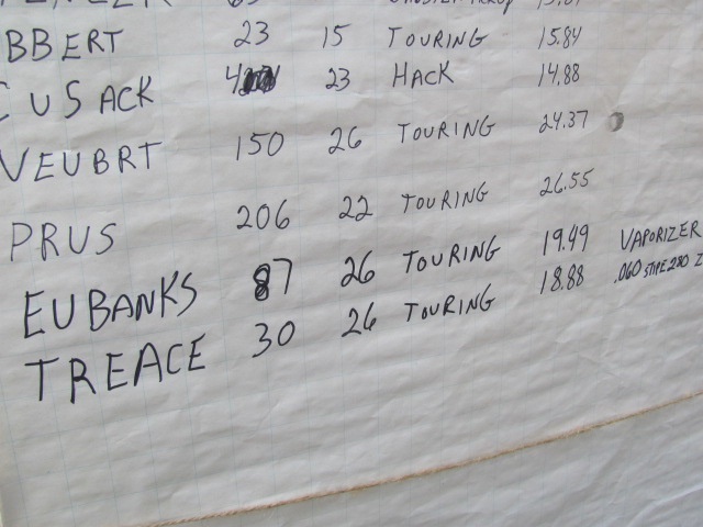

According to Club's Encyclopedia, by Bruce:
The Vaporizer became standard in late 1926; the NH being discontinued. The Vaporizers came with several nameplates — Holley and Ford, with variations.
Ford considered them an improvement. Helped with the poor gas and gave good economy, a Ford selling feature of the low cost car!
Plus they do perform when in good shape, this T out horsepowered me on the dyno with a Vaproizer!
