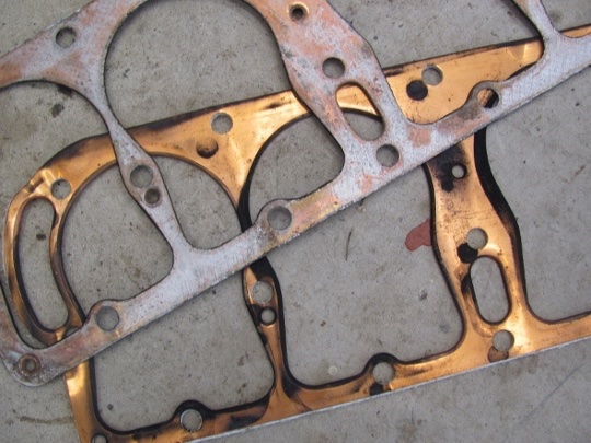

Here is comparison a copper gasket placed dry, without sealer, note carbon blow-by, and another copper gasket with alum pigment spray enamel, which looks like the best seal? ;)
IMG_8479 (590x443) (540x405).jpg (122.66 KiB) Viewed 2767 times
