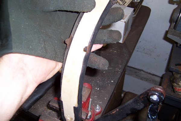

The time has come for me to replace the top on my 1924 touring. I now have removed literally hundreds of staples which were used to put on the current top and fabric back in the 60s or 70s. My question now is, how do I know if I have the correct wood in the bows? I need to know what kind of wood was originally used for both the main straight part of the bows and the curved parts. Also, need to know the correct measurements for them. Can someone post those dimensions?

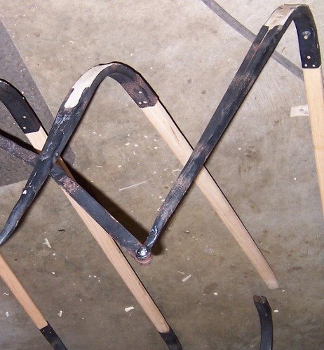

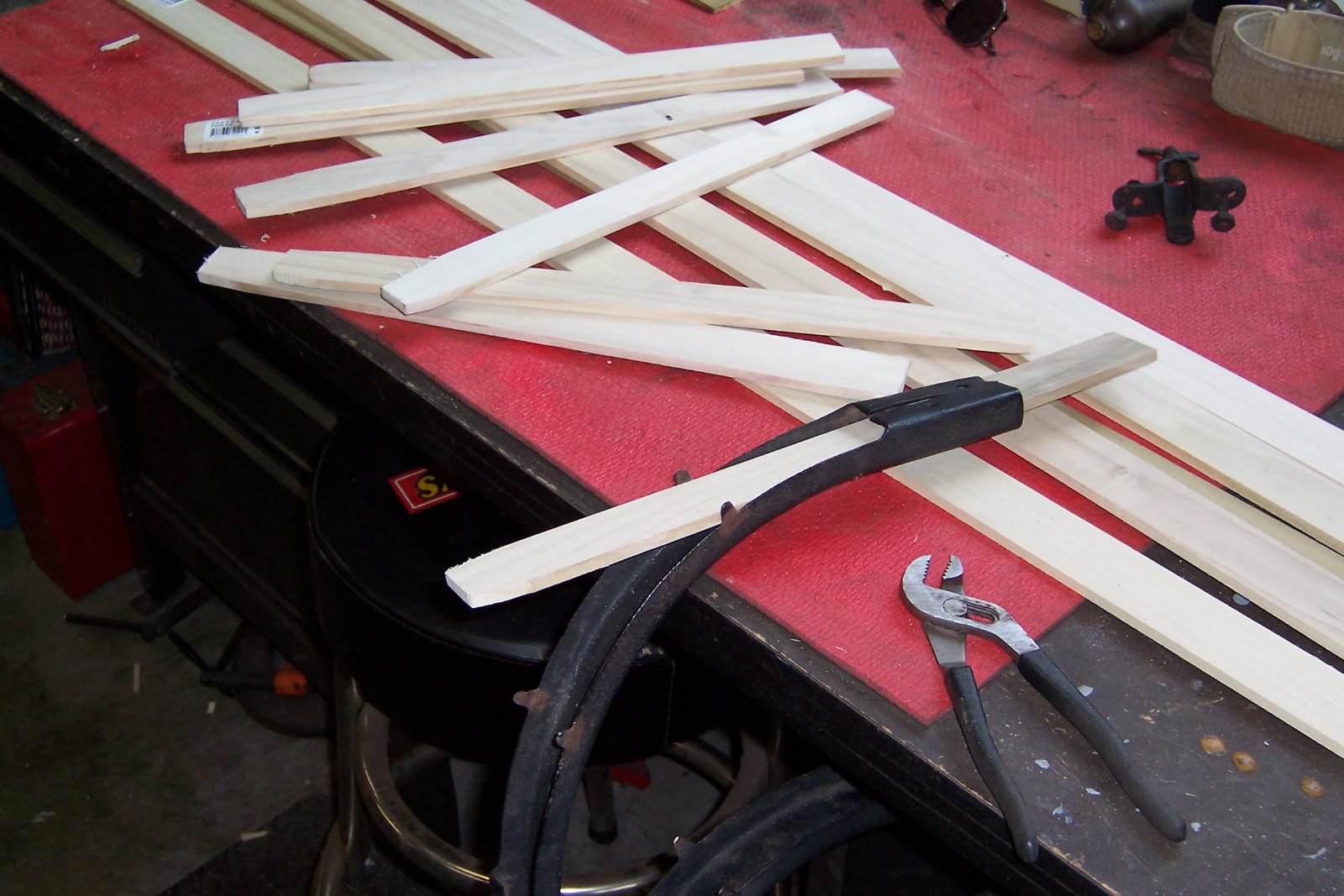

The main bows on the one man top are straight, though made up of three different lengths. I bought mine from Synder. The curved end bits are just rough wood to hold the tacks. I made them in two pieces so they slide in without moving the tabs. For these I used pine.

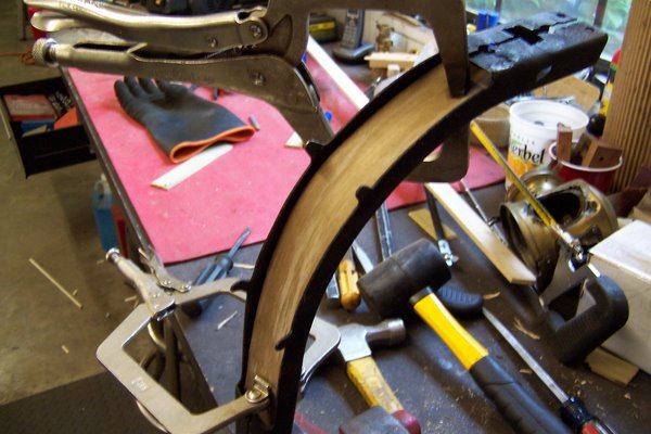

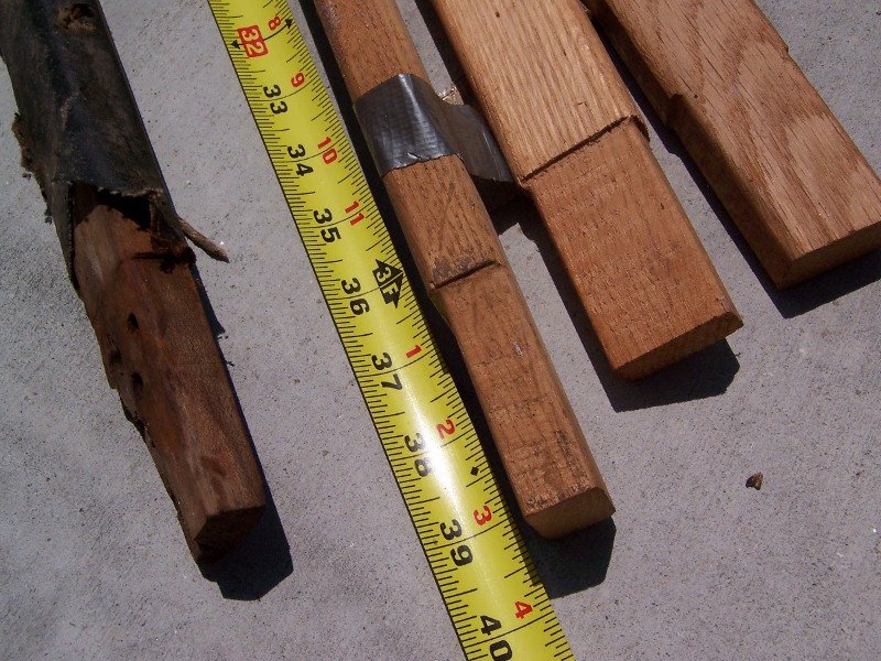

Wood bows are made from clear dried oak. For the 23-25 touring these dimensions are from metal to metal of the top irons when assembled. The bows all have extra length cut down to fit into the metal iron socket and riveted to each.
Front 34 ½” #2 35 ½” #3 36 5/8” Rear 36 5/8”

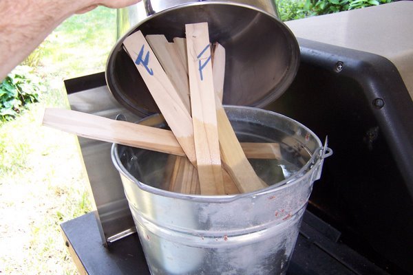

The insides of the rectangular irons are fitted with lathe strip like wood, ash or pine is good, its just for bit of strength and for holding tacks. Thin strips can be boiled to heat and soften to bend into the space.

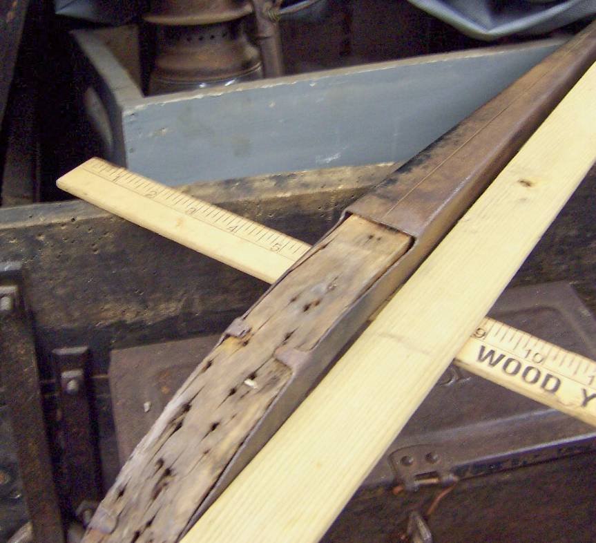

Thank you Tony and Dan for chiming in here. The measurements for the second, third and rear bows match within 1/8 of an inch, have not yet uncovered the front bow. What puzzles me are the curved wood pieces. I understand they are there just to hold the tacks but they see to be loose fitting and give somewhat. Would it not be better to shim them up to fit tighter? Thanks

Yours are loose from shrinking over the years, and should be rather beat up with years of top repairs and tacks removed and placed. May be able to shim if you wish.
Original are two pieces, stacked on top of each other, taper the entry end so they will glide in. Must be steamed or boiled to allow bending in place without splitting the wood.

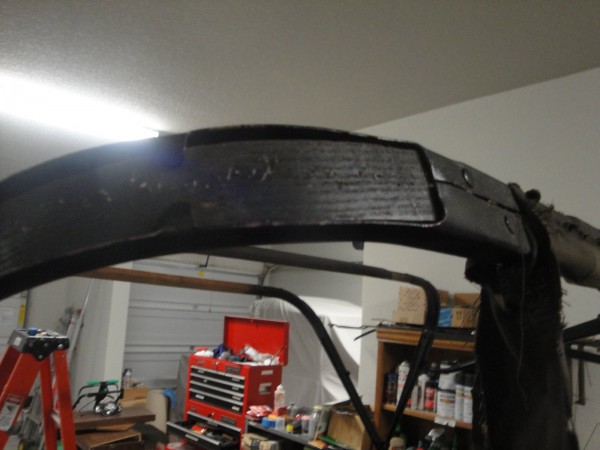

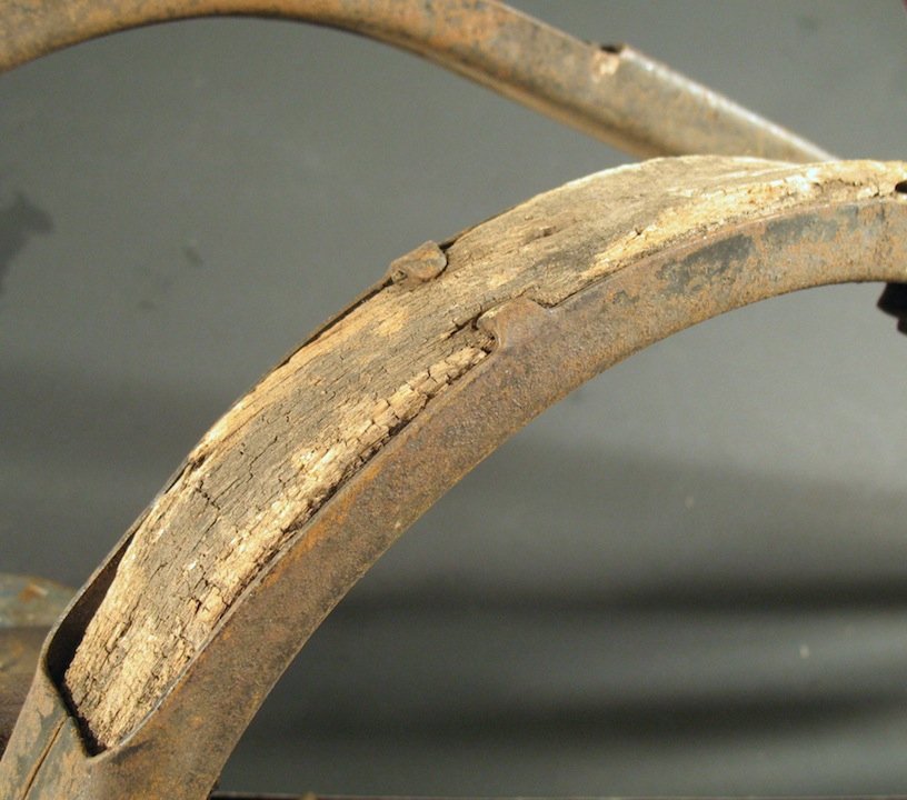

The play in the ends of the curved pieces is nearly 1/4 inch. Should this be shimmed up or is it ok to leave alone?

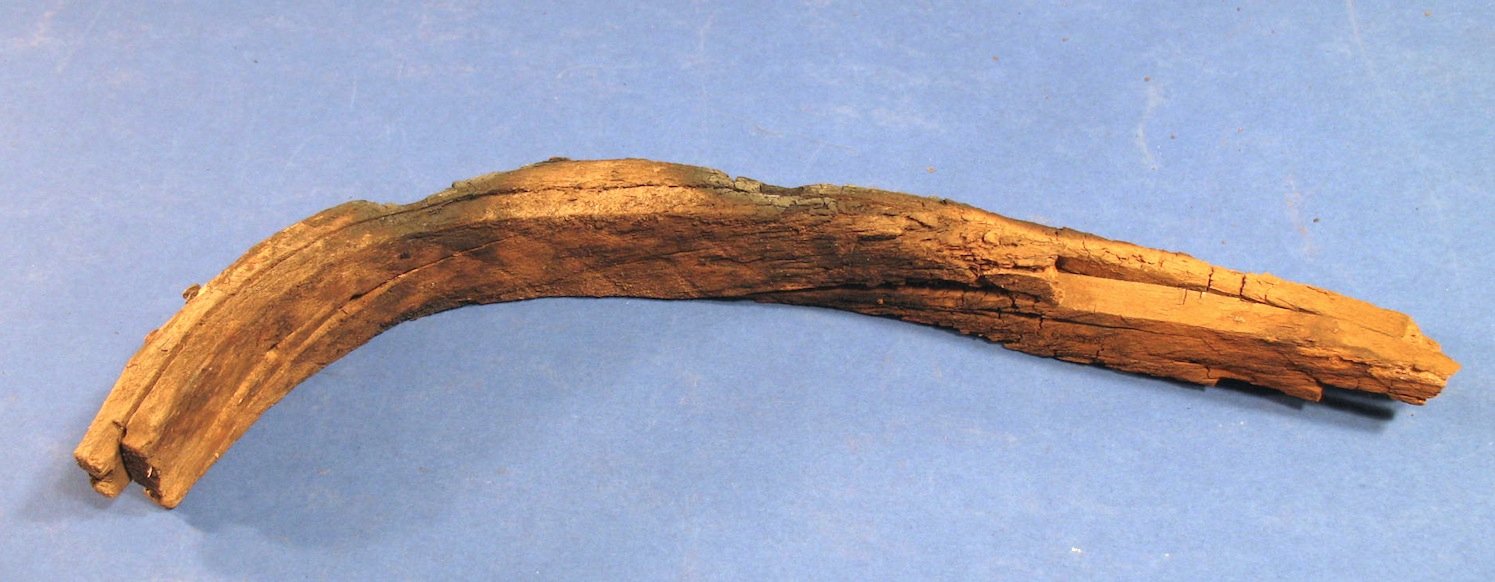

Those irons are the backbone of the top covering. Originally the wood was snug and tight in the corners and the wood bow riveted in the socket.
Have seen many old worn segments of irons with the thin steel rectangular sections fractured, a lot of stress, raising and lowering the top set, buffeting wind, etc.

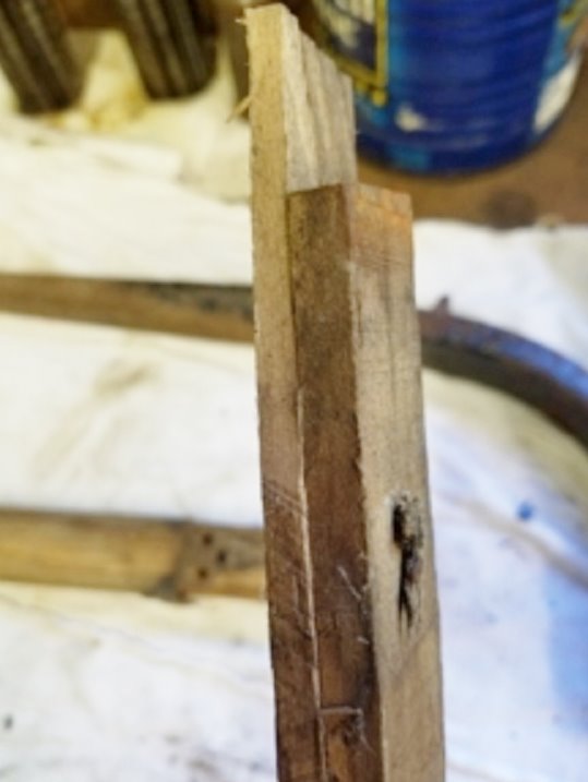

Original bow and the curved wood pieces removed from top iron. The curved side wood pieces stack on each other and fill the rectangular top iron cavity.
attachment=1]760192.jpg[/attachment]

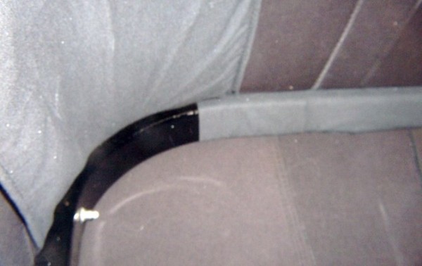

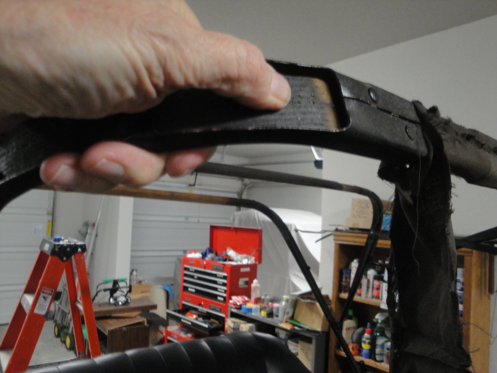

The original bows are NOT straight. If you lay one on the floor with the top side up you'll see that it's at least ¼" off the floor at the center. They're called bows for a reason. For just one, I would get wood from a hardwood dealer and make it.

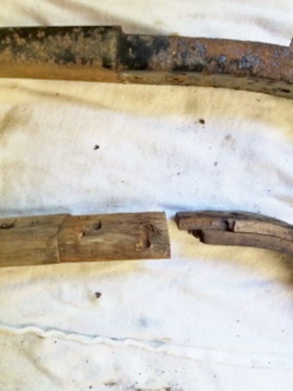

Here's original corner wood in place.
Wood removed. It's singed because I turned the tabs red so I could bend them open without breaking them off. You can make these, but I bought new ones from Jon Anderson.
