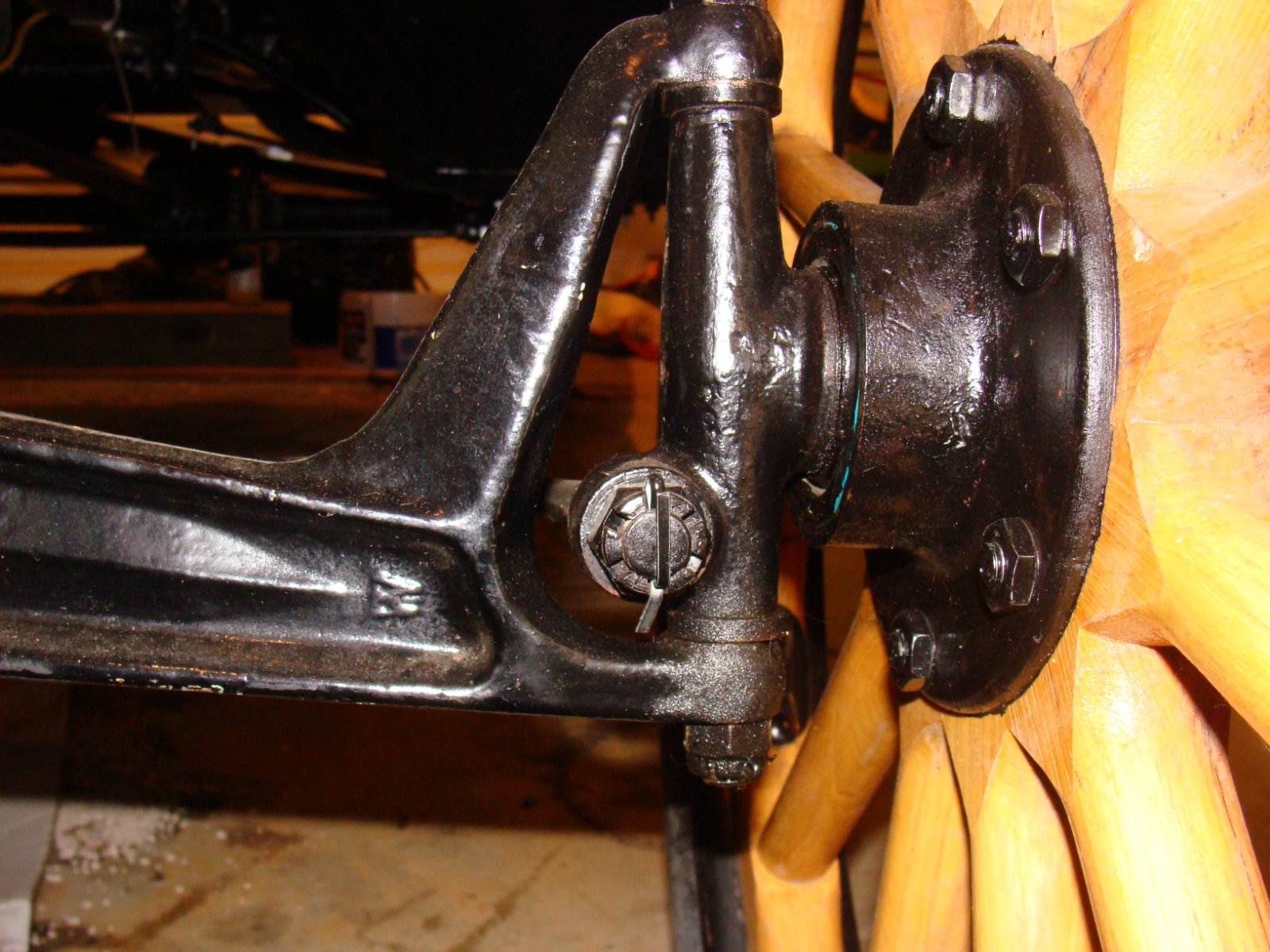

I believe the DB axles used during 1913-1914. Maybe late 1912?
My late 1911 has the Transue-Williams mark that is larger than the later years.

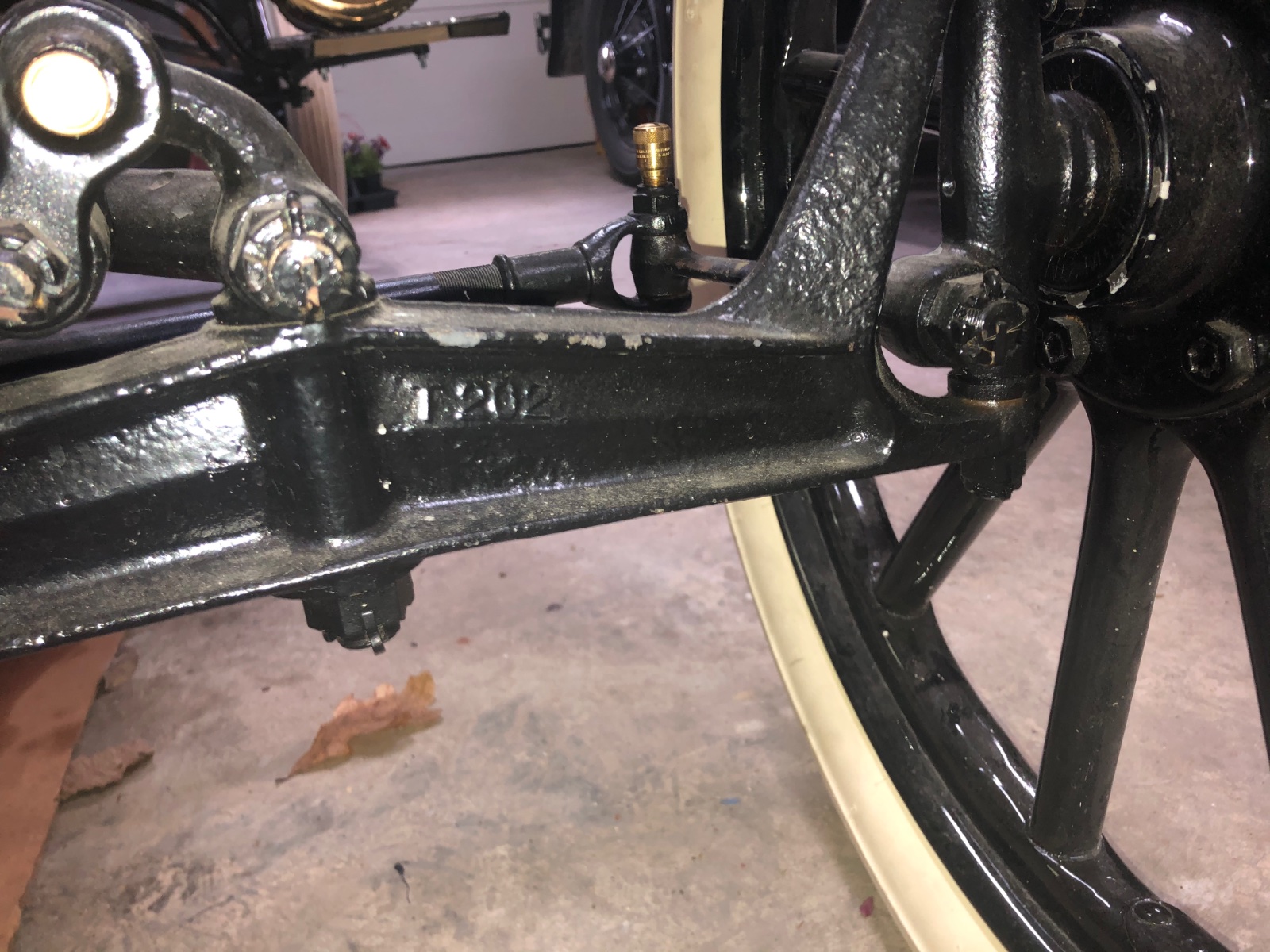

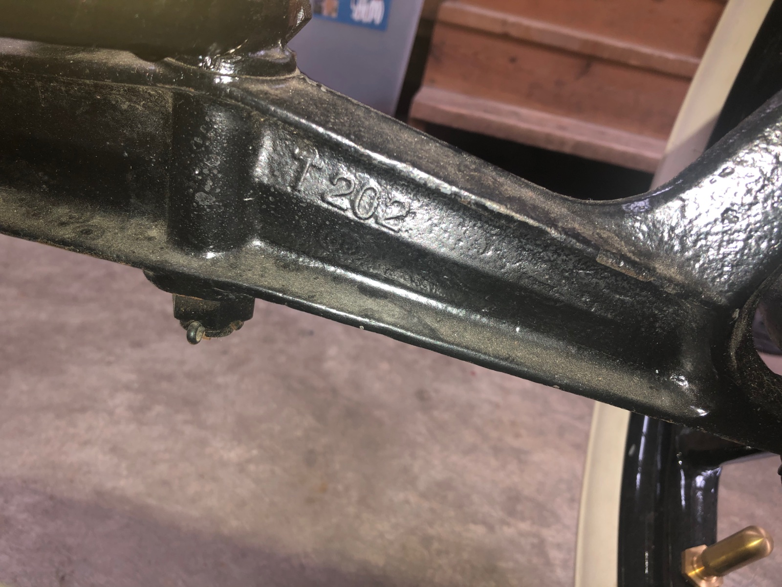

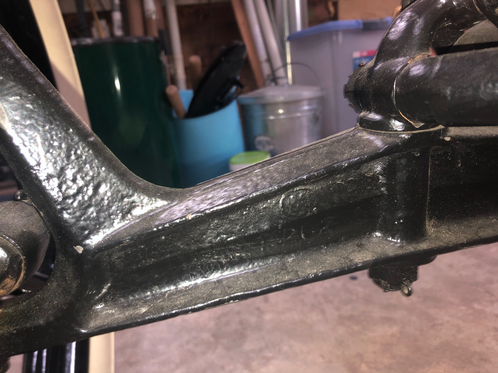

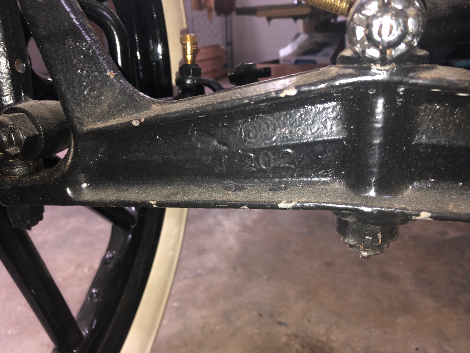

My late October 11 built car has T202 on all four corners. All also have db in a circle. The db on the left rear side of the axle is upside down. Art
