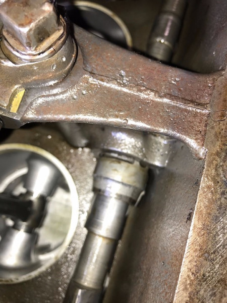

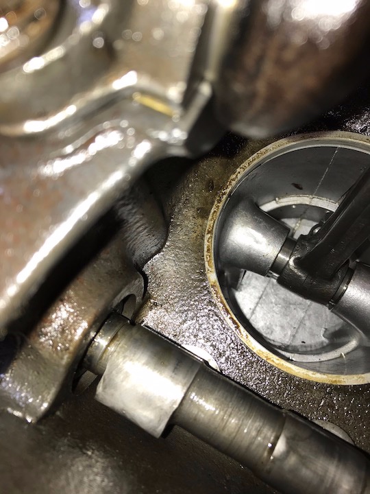

OK I ran into a bit of a problem with getting the CAM Shaft out. I took out the two bolts that hold in the bearing and I started to slide it out and it stopped moving on the center bearing. I tapped the CAM on the back with a big punch. It started to move and looked as if it was not together. I know they are held in with a clip. So I used a thin punch and tapped on the bearing and was able to get the bearing back into a circle. I then tried to tap it again and it won't move. The front bearing moves with the CAM no issue. Am I missing something.
You can see the bearing coming out.
This is the other side.

Cam Shaft cover was off, valves are out and lifters are out of the way. Kerry you are correct. This motor and trans was bad at almost every turn. J&M Machine did an outstanding job on the transmission. I know the risk I'm taking with the pistons and some other parts. Just wanted to make sure I wasn't going to hurt anything. The Cam shaft seems to slide in the center bearing so the cam lobe hits the side of it.

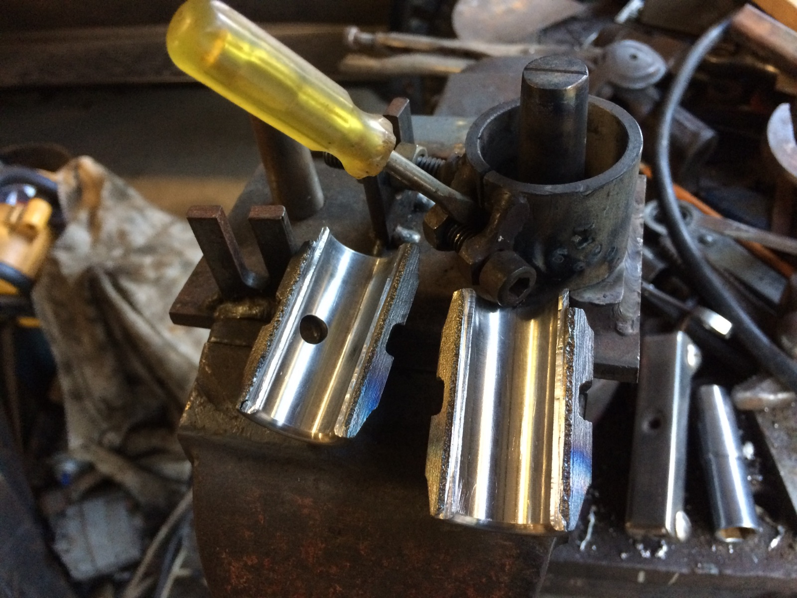

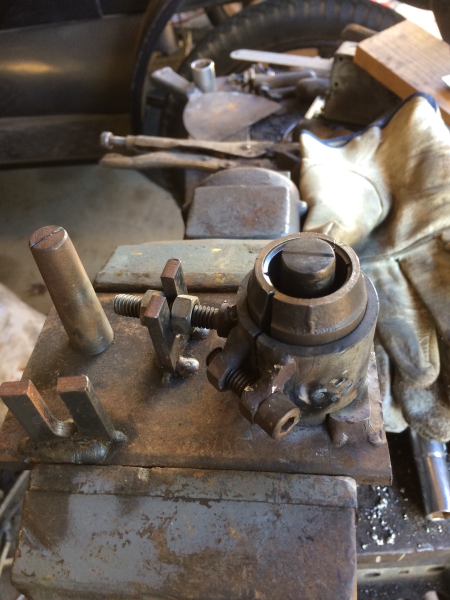

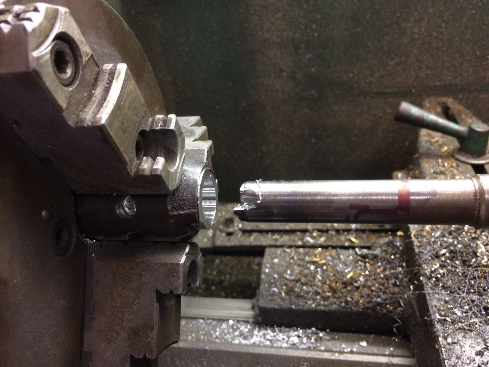

Be glad to help but I’d need the shaft for proper fit. 903-824-1949
- Posts: 6812
Re: Getting a CAM Shaft out
Steve, that's good to know
And Bob, I thought I'd remembered someone in the recent past showing some being made...perhaps it was you

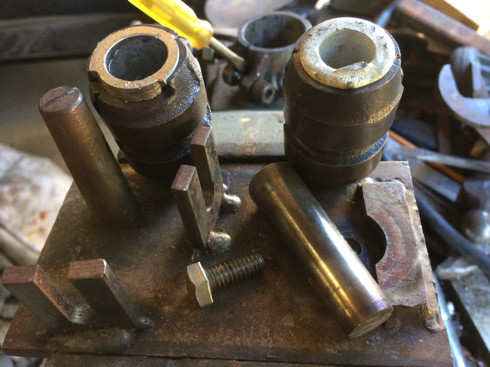

Biggest problem with old shells is that the partng line where they are split is often times badly worn, rendering the od of the shell into an oval shape. There is no way to repair this, so good cores for rebabbiting can be scarce.
As far aw removing the cam shaft from the threads above, rotate the cam so that the side of a lob is bridging the split in the bearing. Now when you tap or drive the cam out, the lobe will push BOTH sides of the bearing out at the same time. As others said above, you must have the valves and springs remove so that the tappets are not in contact with the cam.

Yes, I’m in total agreement with you Dan. The little broken lines must not be worn- see the last picture, if the shell are good, the rough broken seams will interlock and line up the shells. This is also why I’ve had no luck with babbitting the early iron shells, by the time you bore the for Babbitt you cut broken line out and there’s no way to line them up. But, thankfully a large majority the shells I’ve run across have a good break line. And I’m thinking if the cam bearing break lines are worn you need to look at the block also for wear in the hole. As the say, That turtle didn’t get on top of that fence post by himself.
