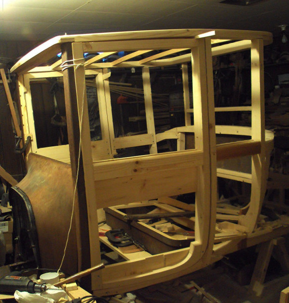

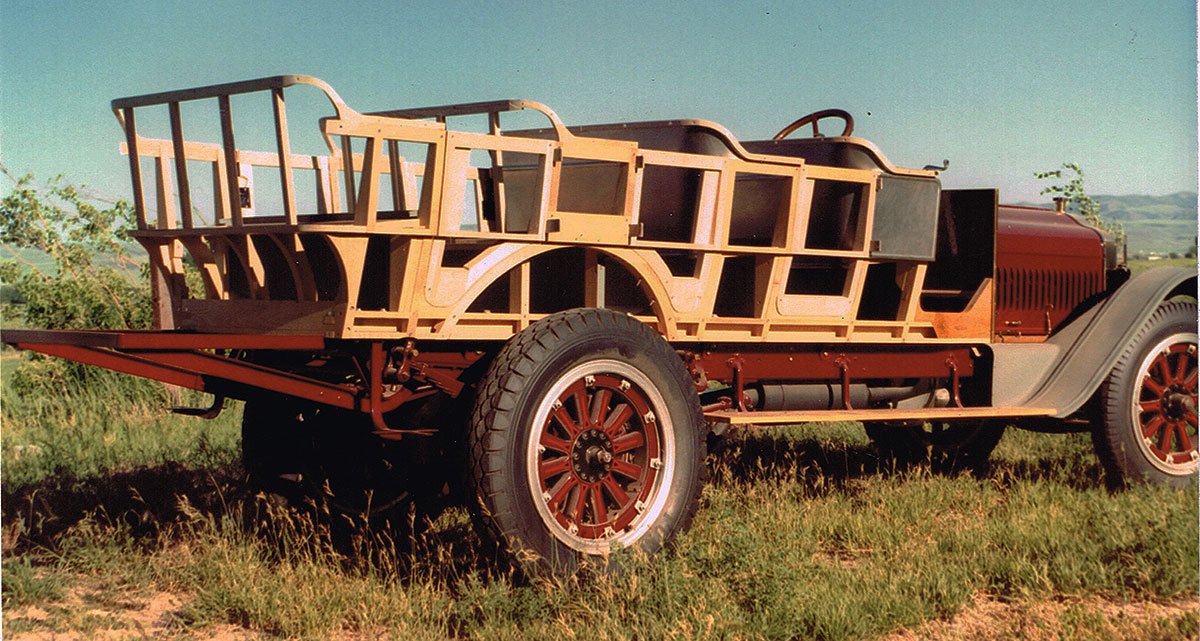

I rewooded my '23 Bus in the 80s with red oak because it was more available in different thicknesses. Many expert told me it was a mistake but it has lasted 9 or 10 thousand miles of driving in all kinds of weather and I can see no problems with the wood.
I rewooded my 22 T Coupe with pine (2X 4s) in 2012. It has not held the nails and tacks as well but is still holding up well. It was much easier on the tools. I had not planned to drive it much but we have about a thousand miles on it too.
I like ash and poplar better now.
Best of luck.
