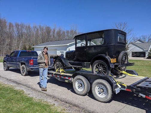

First, allow me to say how proud I am that my eldest son has caught the bug and has bought his first T! He's 20 and saved up the money to purchase this original finish, original interior 1926 Tudor form an elderly gent here in Michigan. Unfortunately, the old fellow had someone remove the mag coil and installed a VW distributor. Now my son is going to school to be a mechanic and already has several state certifications so he knows a thing or two about engines, and he's pretty familiar with T motos thanks to my addiction. But neither of us are familiar with timing or adjusting distributors. Now I know how you all feel about distributors; half of you think they are the devil's own and the other half think the opposite. Now my son is planning on taking the engine out in the fall and taking it to one of his classes as a work project, and at that time he's planning on re-building the mag from the car and installing it. However, until then he wants to drive this cool car around. He's tinkered with the distributor a bit, and he and I went through most of the basic things but it still isn't running as smooth as I think it should. Can anyone with experience in VW distributors please give us some help on how to time/adjust/maintain/use these things? Also, is there any kind of literature on them? I'm really not interested in opening a big debate/argument on distributors vs magnetos so please keep your comments civil and directed only to the topic - getting my son's T running as best as it can on this type of distributor - thanks!
