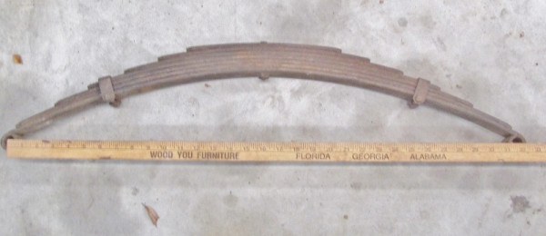

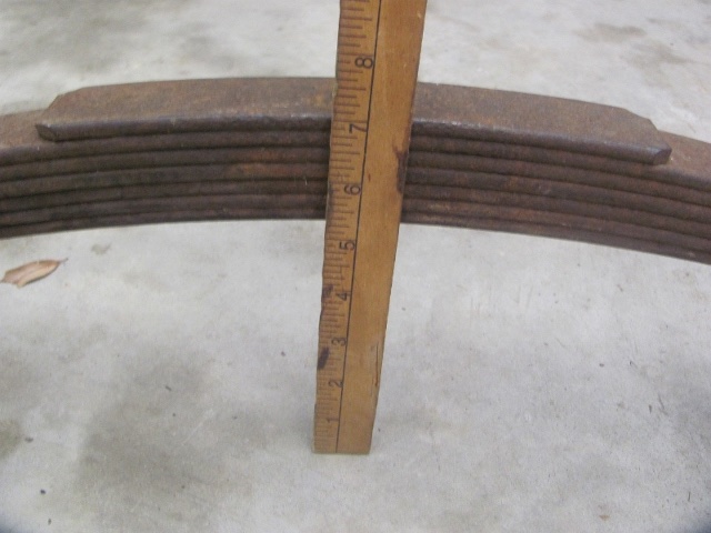

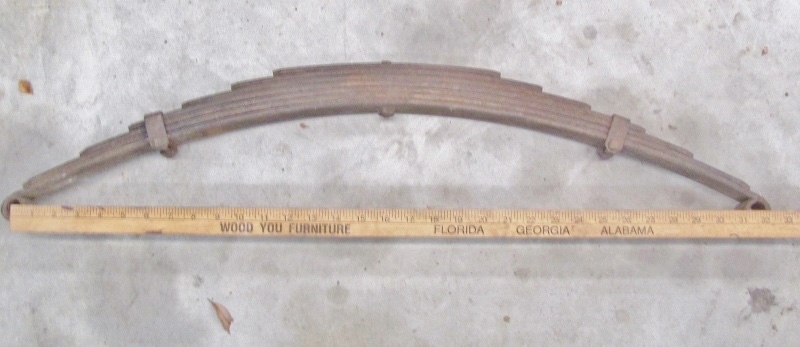

All '09-'25 front 7 leaf assembled spring stacks, main leaf eye to eye are the same. 31 1/2" between the eyes.
What can make the sag is the stack, where the others are fatigued.
Should be about 7' high, un -sprung, with spring assembly resting on the eyes on a flat surface.

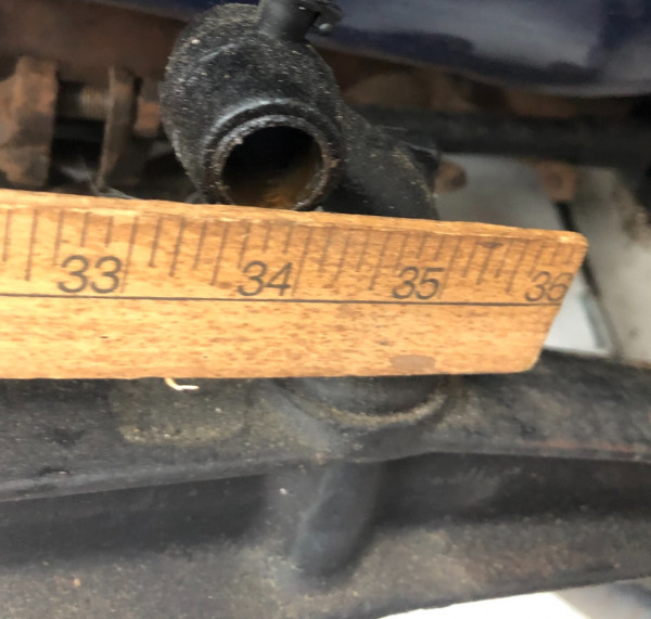

JIM, THIS IS IN THE CAR--33 INCH BETWEEN EYE TO EYE, FROM THE CROSS MEMBER TO AXEL IS 4 INCH, GREG.
- Posts: 4042
Re: 1921 Front Spring

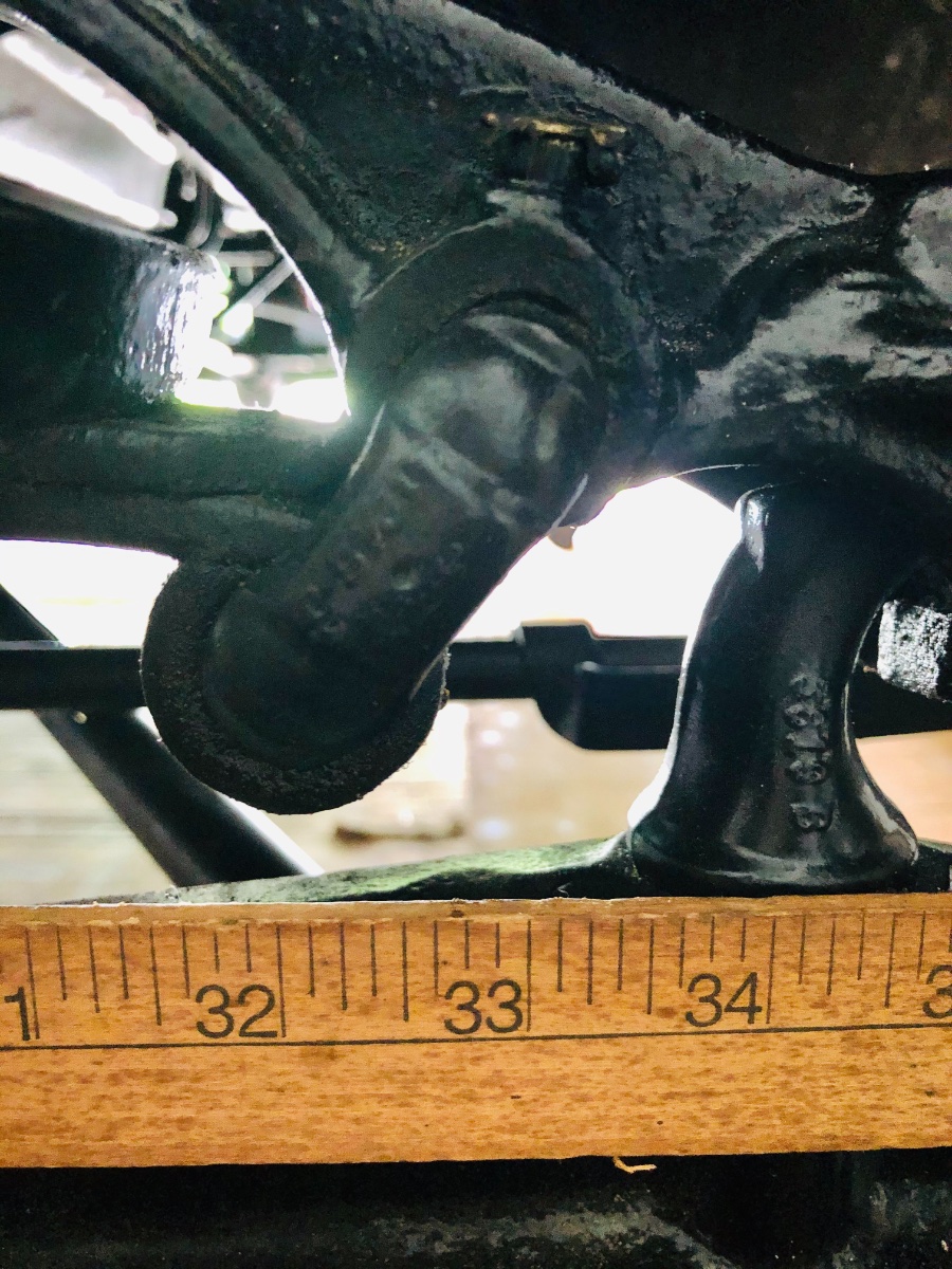

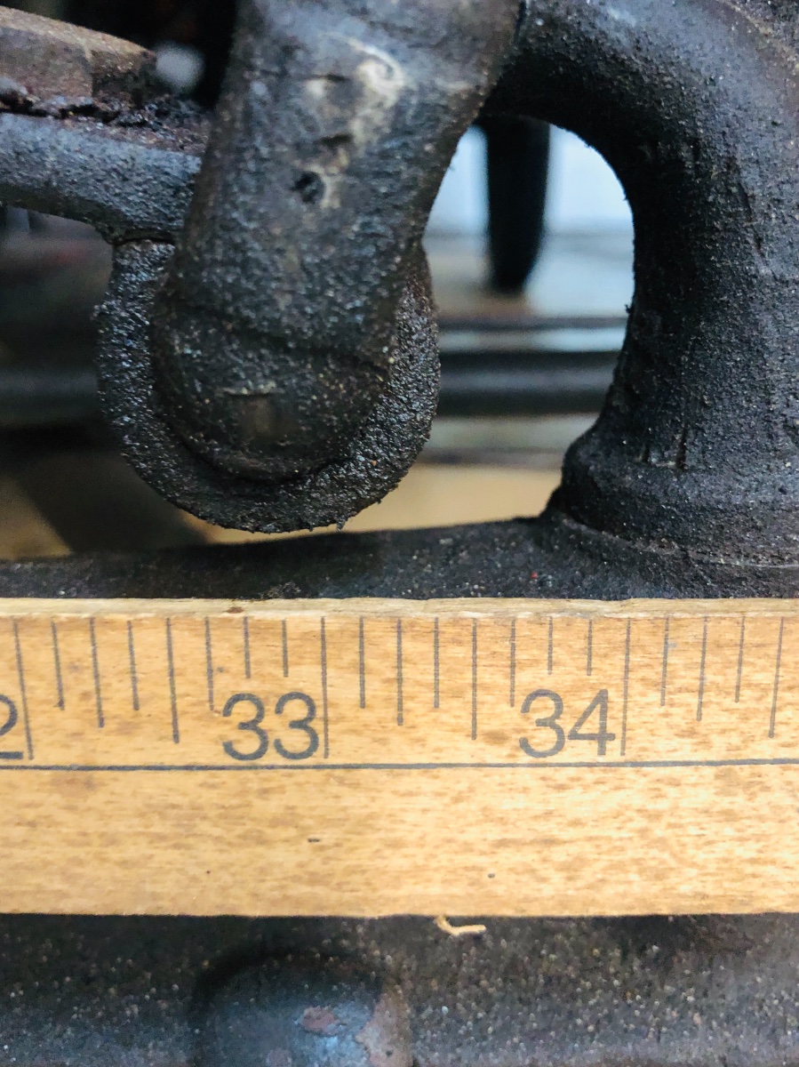

Correct Richard, when front spring is loaded with car weight:
This is a rather old spring on the '23 cutoff, sags some. A well worn one can let the knuckle ride on the axle
This is a bit better clearance of a used front spring, but it's being helped with accessory Hassler Pancake shock. (Yes this left perch is twisted to the front for Pancakes...unlike the earlier Beehive that needs the perches switched right to left)
Comparison of perch to perch centers on a standard front axle.
