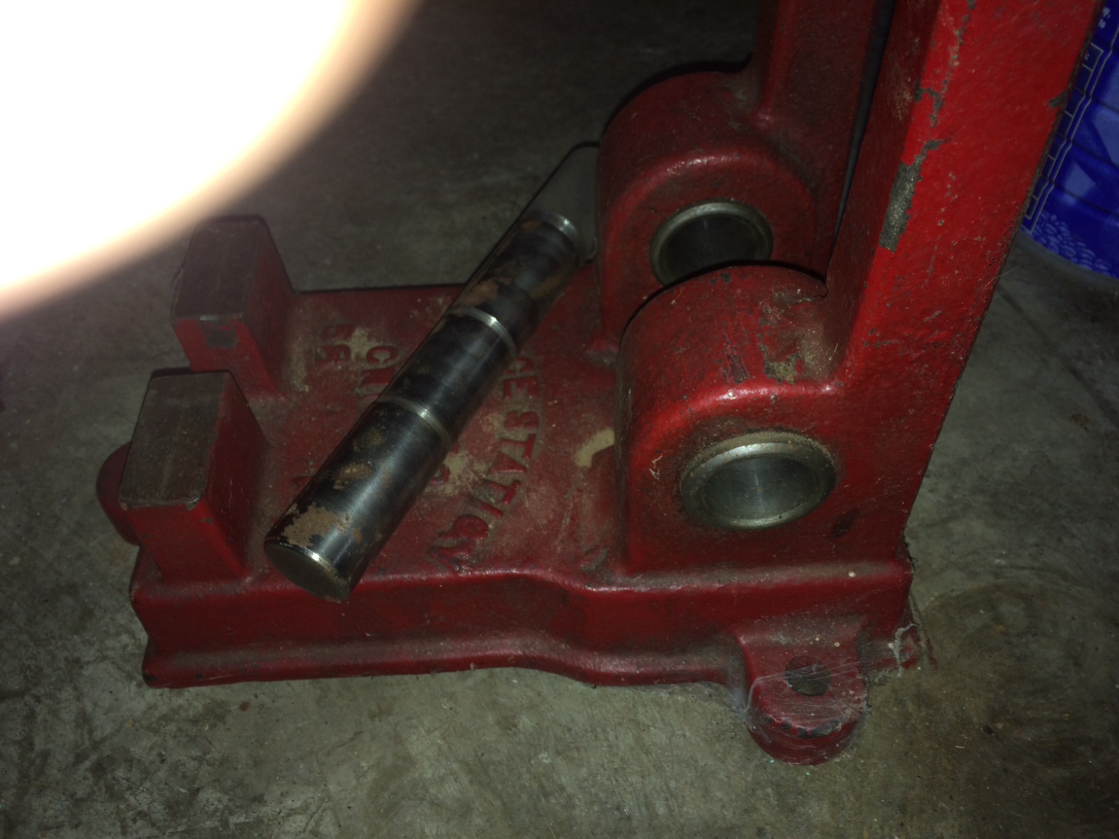

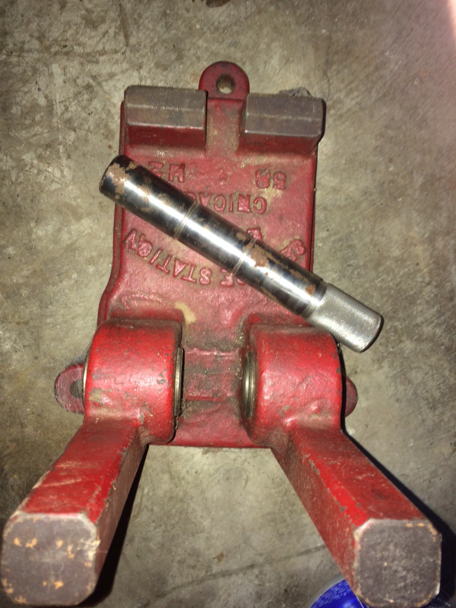

There are tools for that, I apologize for not having the numbers, but someone surely will.
I sold a jig to Joe A. for checking the rods and I believe he also got a long bar with a fork in it for bending the rod...
This is the fixture...

A good machine shop should have a jig to check bend and twist in rods. They should also have a rod vice for straightening any bends. It is a job for someone with special tools and the know how to use them.
Hope this helps.
Hope this helps.
