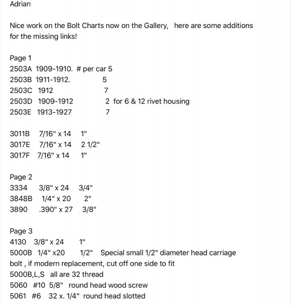

Thanks for taking the time to check those out. I made a stab at trying to fill some of those Yellow Blanks. Tried the early axle housings, but you will know a lot more about them than me![]()
Here is what I sent off to Adrian earlier with a PM, not sure he got it, so copied it here. This is made from the Bolt Listing by Part Number pages:

Tony
Those bolt lengths with those 2503 suffix part numbers are in my copy Sept 1912 Price List of Parts. Gives # per car as same in the my changes to the new spreadsheet.
What isn’t associated with these part #’s is year(s) of use. Obviously the short bolts needed for pressed steel clam shells, 5 ea. The 2 ea. longer are for the ends.
As for years of use, my guess is they cover mid year or overlap year for each change in the housing designs.
The A,B,C,D are all as used to Sept 1912 as they are in that Price and Parts List.
The latest bolt is of course the 2503E is the 1 5/16” length for the last style housing center 1915 (or late 1914) to 1927.
