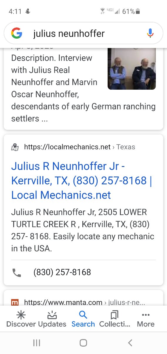

Try contacting Julius or Marvin in Kerrville.
