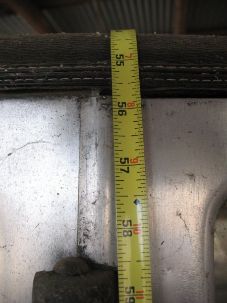

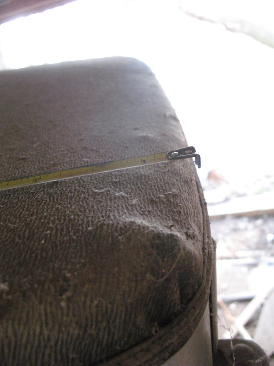

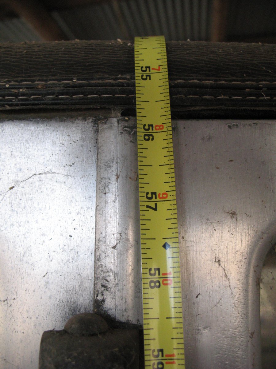

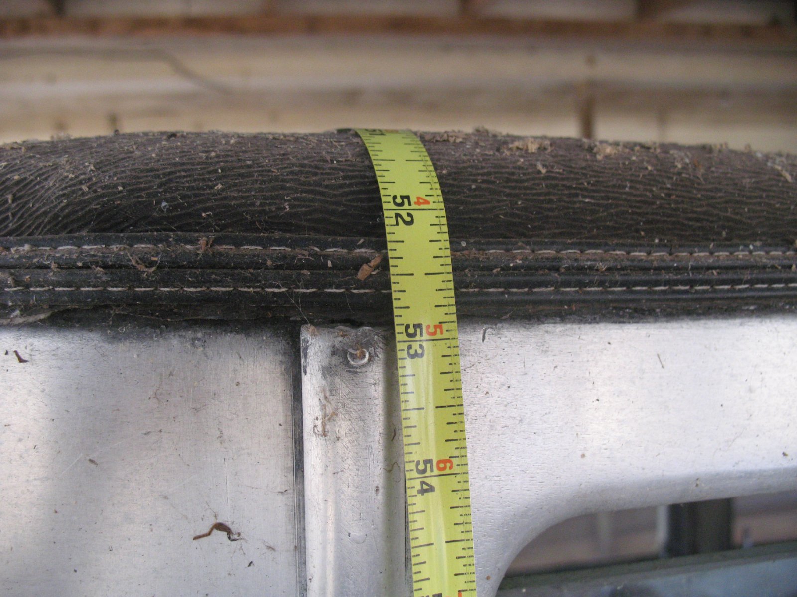

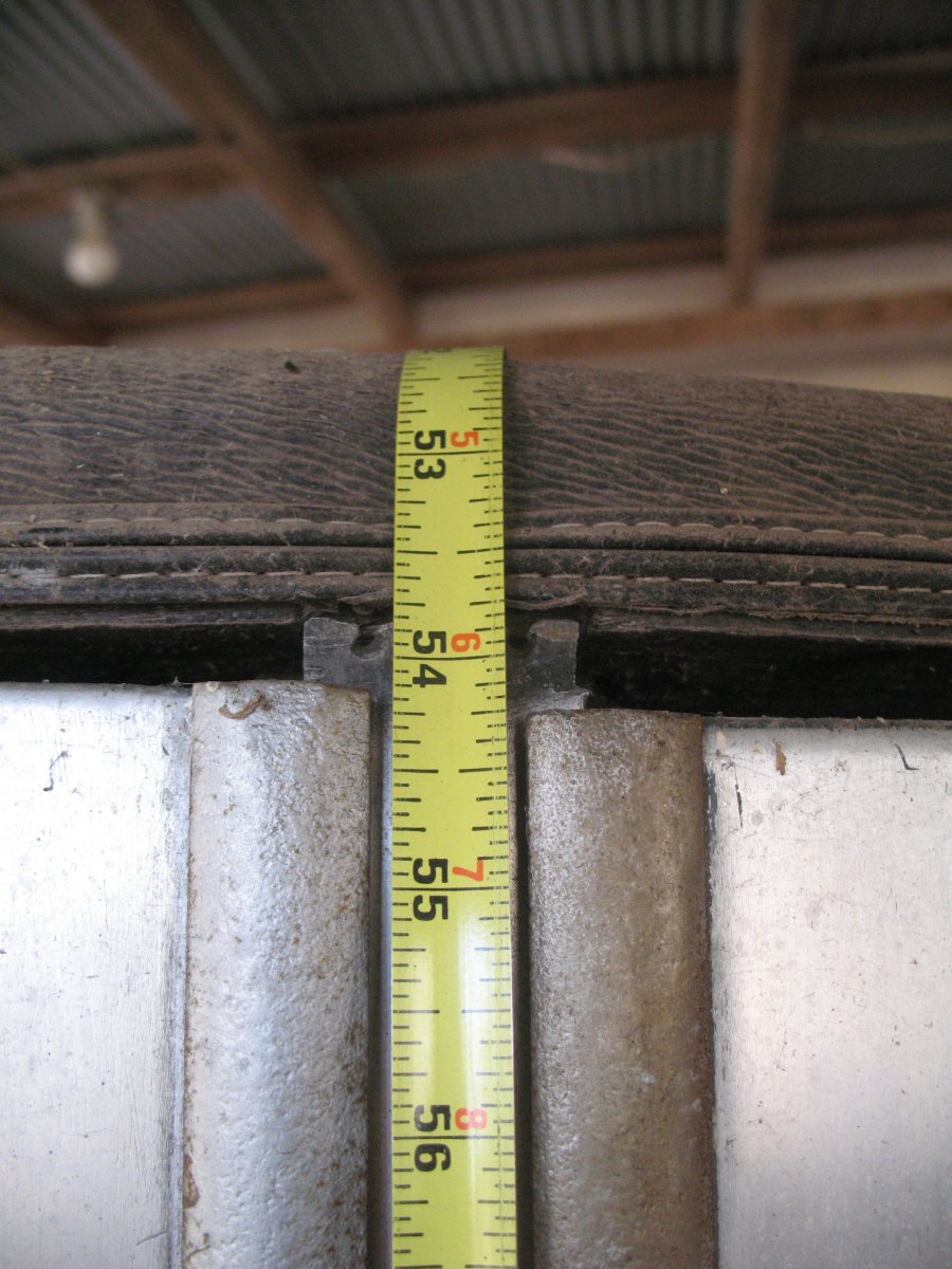

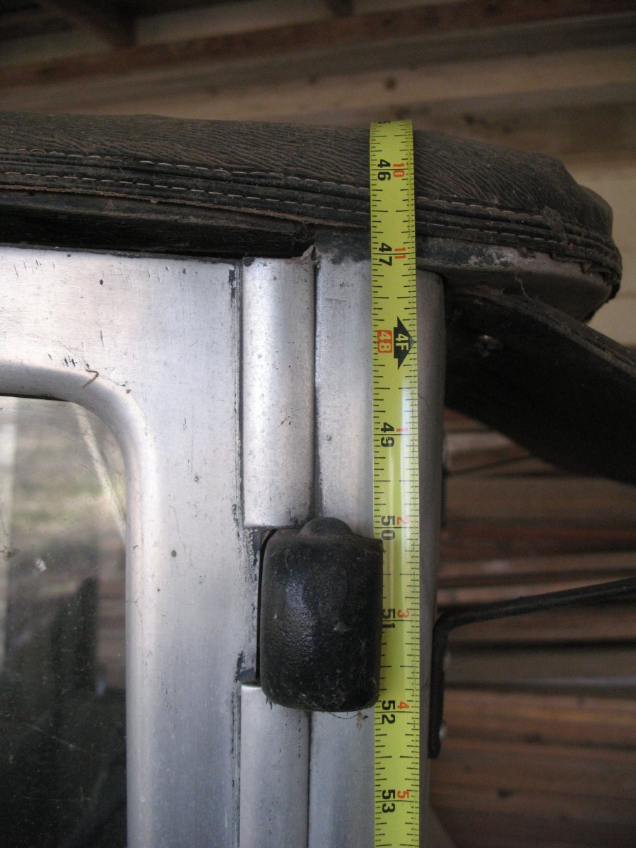

OK, here's what I found on the 23.
I put the end of the tape even with the edge.
At the front hinges.
Between the doors.
At the rear hinges.
At the rear corner.
Between the doors.
At the rear hinges.
At the rear corner.
Re: Fordor Roof Dimensions Needed
Leave it to Steve to come up with a good, logical way to show dimensions. I do so enjoy seeing the close ups of that original Fordor. We loose something when we make them look purdy.

Steve, thanks. That’s what I needed.

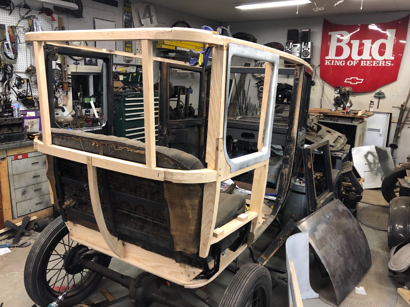

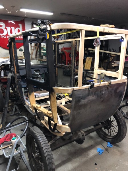

Here’s the project...
Wow! that brings back some Tudor memories. There aren't many straight pieces there are there?.
Great work.
Great work.
Kenny Edmondson
Rich, definitely no straight peices.
Not a job for the meek.
Luckily I had decent enough old pieces from the original structure to measure and make the Fordwood kit to the same dinensions.
Yesterday’s progess...
