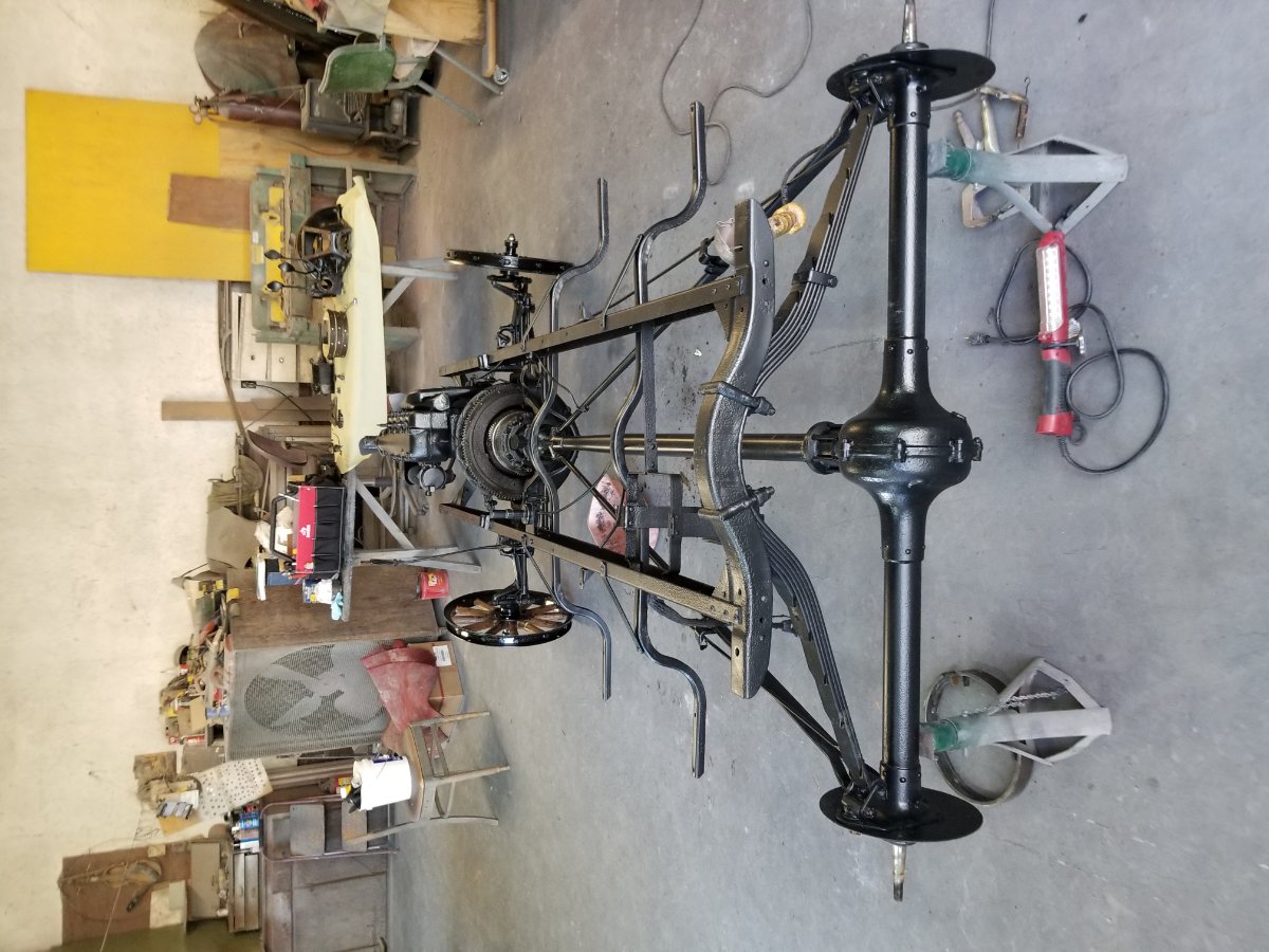

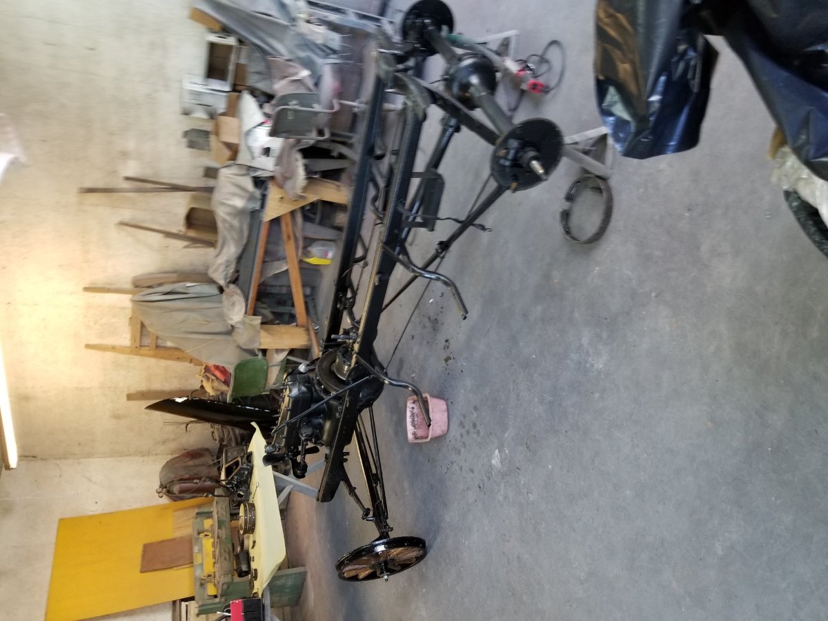

Re: Emergency Brake Issue
Post by lmitch » Thu Apr 16, 2020 7:31 pm

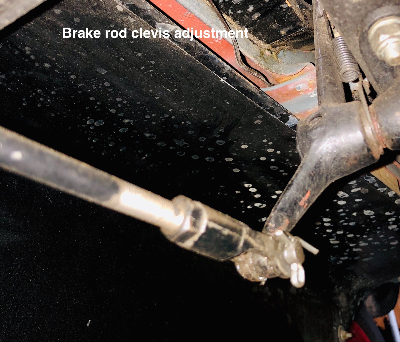

[image][/image]

After referencing Service Manual and Parts List, I think I see. This is my first T so I'm slow sometimes. Didn't know the rear clevis was adjustable. So part 3465 "Hub Brake Lever" has a set screw?
Posts: 5505
Post by RajoRacer » Thu Apr 16, 2020 7:54 pm
There should not be a rear adjustable clevis - just a split fork.
Posts: 6732
Post by Scott_Conger » Thu Apr 16, 2020 11:11 pm
The adjustable end goes to the brake lever, the split fork goes to the rear axle
The 26-27 rods are shorter than all earlier versions which are around 54" or so long (so later ones are shorter than that). If you have the large drum late rear axle then I'd think your rods should be the shorter ones and just adjusted a little bit longer. So long as the car is held in neutral by the cam on the brake lever and you have somewhat of a neutral even if the lever is forward of vertical, that's fine. I give myself every bit of OOMPH room to sock the brakes down when necessary. If the lever is dead vertical and still in neutral with no brakes, you don't really have much to play with to get those brakes set.

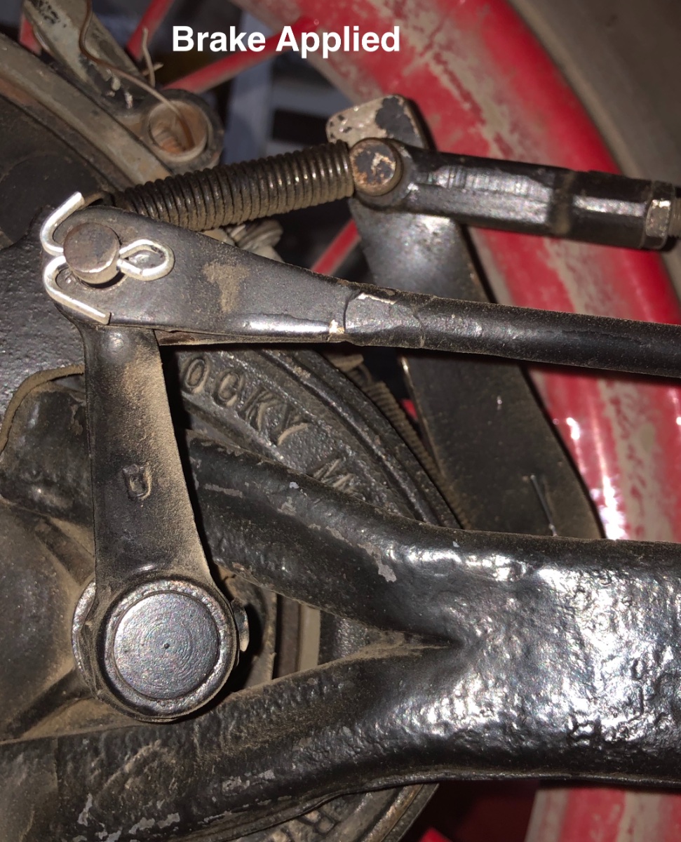

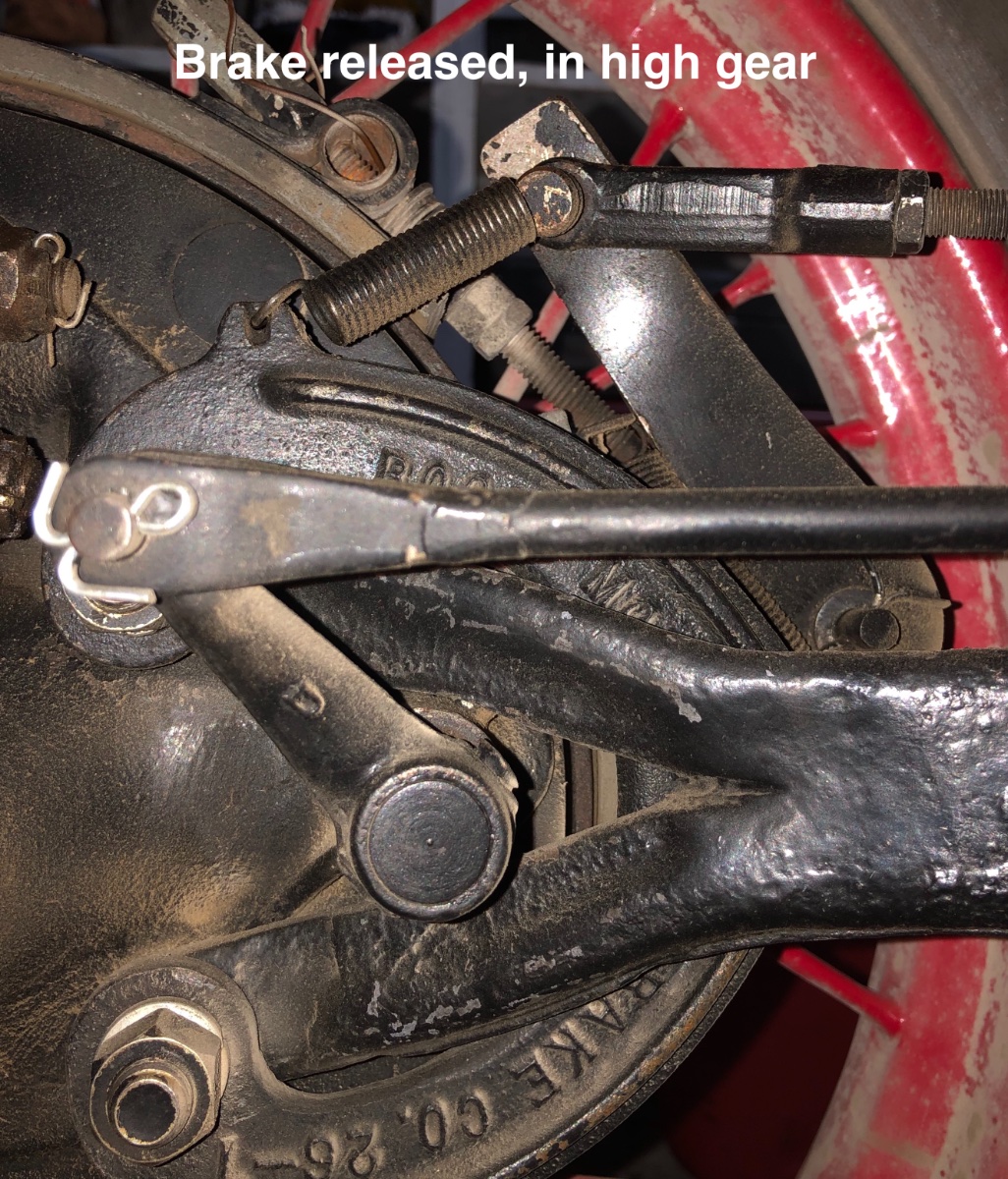

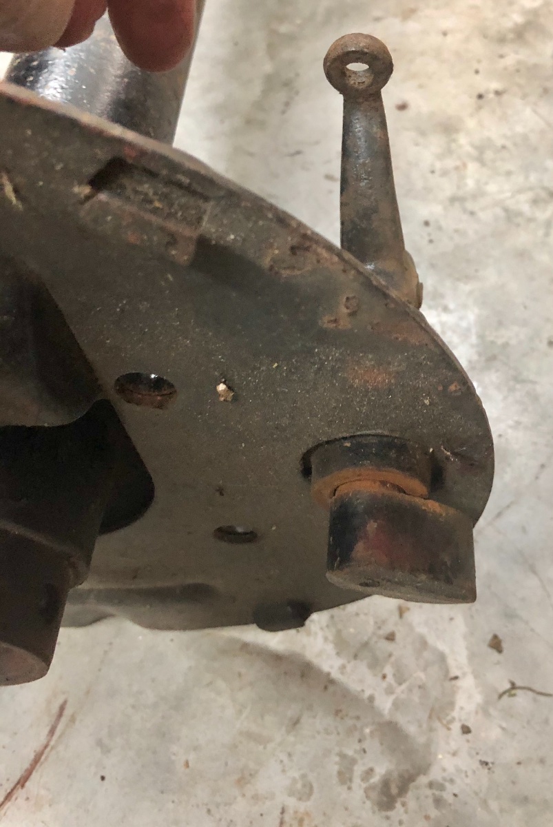

The shop in which my T resides is 100 miles from me. I can only work on it on weekends. Myself and a mechanic looked at the linkage system today and found no way to adjust. They are adjustable at the front of the brake rods via the threaded portion. They are extended fully and will not lengthen any more. Maybe they are the wrong rods. They are 52" long. Anyone have a measurement on the "24 brake rods?
I attached this photo. If you zoom in you can see the cam is parallel to the ground and the handle is in the maximum forward position. Based on everything else I've read, when the cam is parallel to the ground, the handle should be approximately perpendicular to the ground.
[image][/image]

These photos may be of help to you.

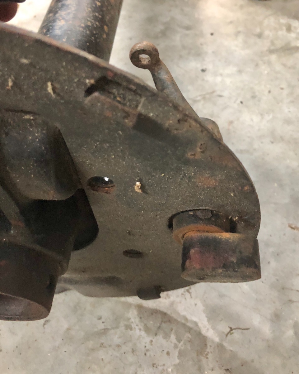

A close picture of the backside of the brake plate would be useful for those responding, and of course, Dan's description of the brake cam levers being "up" and tilted toward the rear of the car when the cams are parallel to the ground. Ideally, when the brake handle is straight "up", the cam levers that the brake rod attaches to, should be pretty well straight "up", too.
Since the rods appear to be or are at least acting like they're short, as fitted presently (correctly or incorrectly as we cannot tell yet), you can figure that cutting them off and rethreading them will probably not result in them being longer when you are done.

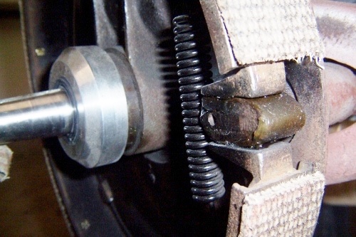

Something is amiss. Could be your cams are riveted to the lever shafts wrong, if you restored with new.
These levers and cams are Left and Right, have to be that way.
Here is the right housing, with cam lever rearward. Relaxed brake shoe.
Now the brake is applied, pulling the cam lever about vertical. Brake shoe expand and locking hub drum.
Relaxed, emergency brake shoe closed, no expansion of the shoe.
100_1204 (500x333).jpg (105.41 KiB) Viewed 8372 times

Post by lmitch » Sun Apr 19, 2020 8:33 pm
Here is a photo of the Cam Lever position when the brake shoes are fully relaxed. The Brake handle is fully forward/2nd gear.
[image][/image]
Posts: 6732
Post by Scott_Conger » Sun Apr 19, 2020 9:02 pm
that is quite different than
With the Brake Cam Levers upright, the cam itself is parallel to the ground
. Yeah, they're upright (and backward facing as well as several people have mentioned is correct).
Later you asked if the drums should rub when the brake is "off".
You have finally provided the information and photos to make a judgement call: You do not have a brake rod problem.
If you will go back to one of my earlier posts mentioning
You have a slightly oversize lining on your brake band. Fix that and everything will work.
