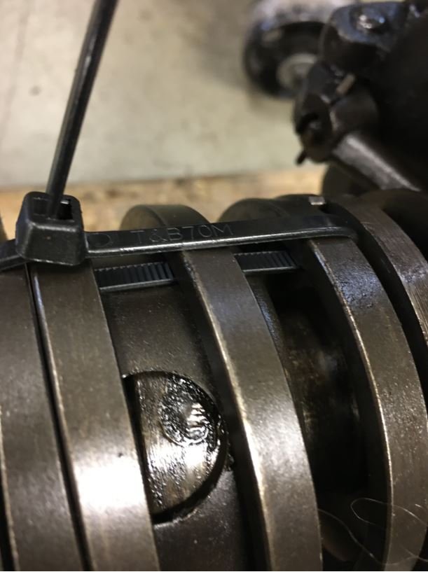

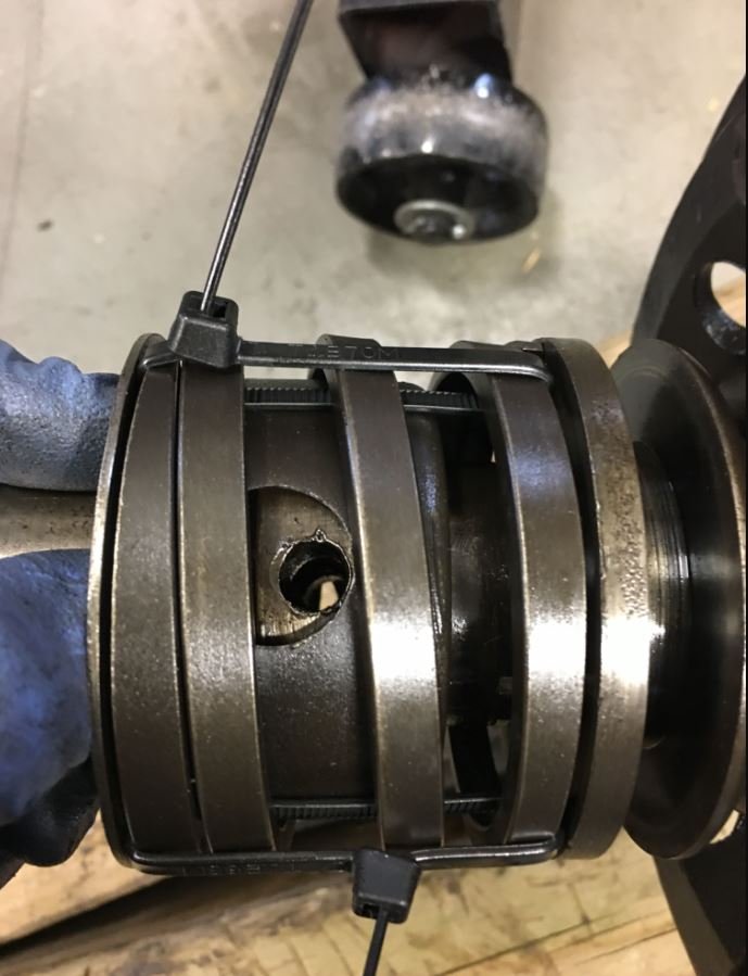

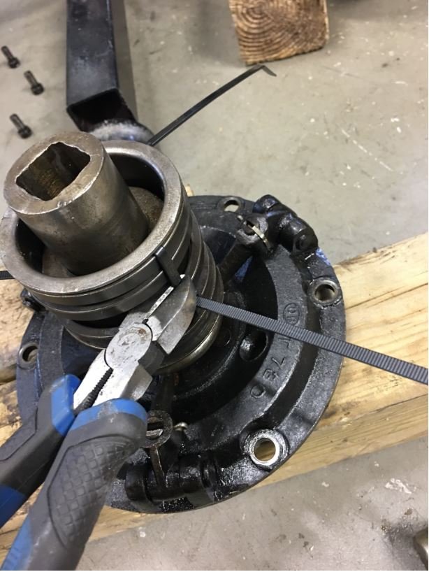

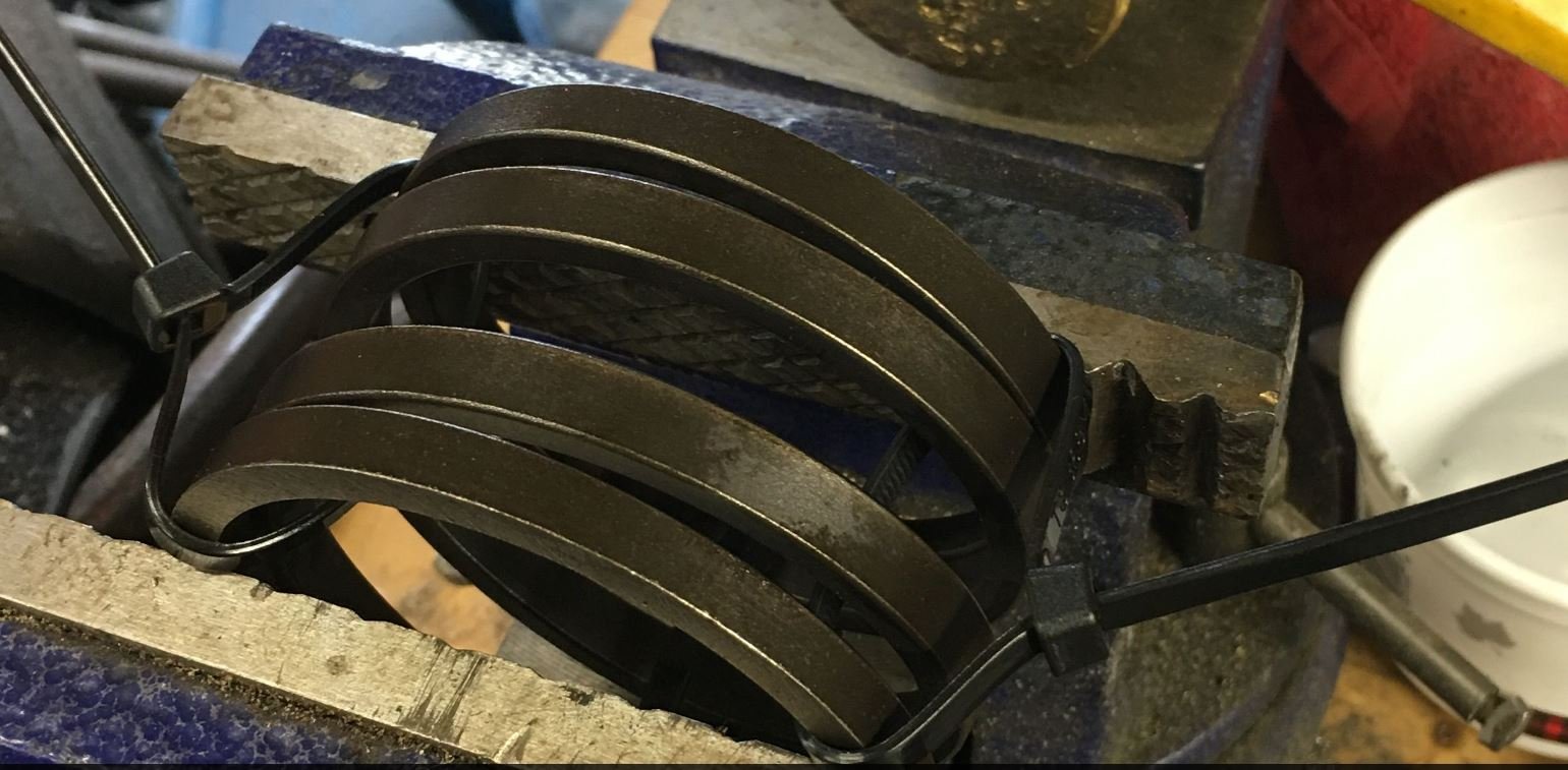

Finally I found another way to install the transmission spring, similar than Norman idea...
See bellow with pictures, Took less than 2 minutes ...

Re: how to install/remove a transmission spring
Cut and ready
The zip tie application is a great idea! Thanks for posting that, jb
